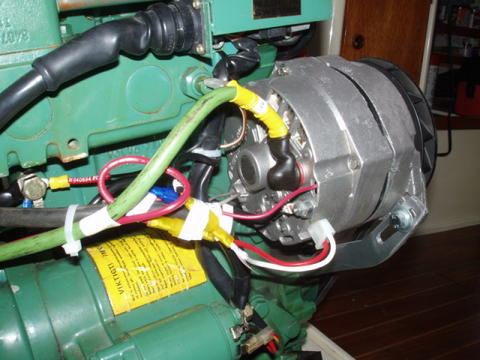

I changed to a rebuilt Remy-Delco off a GM truck. It pump out 70A max. The auto-electric shop tap out the connection for the tachometer. I extended the regulator sensing wire to the top of the battery. Also made a dog-leged arm. I happen to have a #1 cable for the battery, wrong color but who cares. Total cost $70.00. I still have the original as spare. See photo
Just a peice of advice here. I also did this mod a few years ago on my old boat. Since then i have heard that Automotive electrcal components like alternators and starters are not rated for marine use due to them not being insulated against arking and sparking internally. Now for most of us sailors with desiel engines but if you had a gas engine and you had a spark from your alternator...well i dont have to continue...the problem is that your insurance company may not pay due to improper electrical equipment installed on board... The ABYC can provide you more information on this...

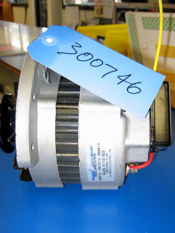

These two alternator photos were taken on the counter of my Westerbeke/Universal distributor.
This first one, the #300746 is the direct 72 amp upgrade from Universal and Westerbeke and is a Leece-Neville 8MR2026PA. It sells for $573.46 if you buy it from a Westerbeke/Universal dealer or can order this same exact Leece-Neville alternator from ASE Supply for about $240.00. they are very easy to convert to external regulation using the Leece-Neville conversion kit.

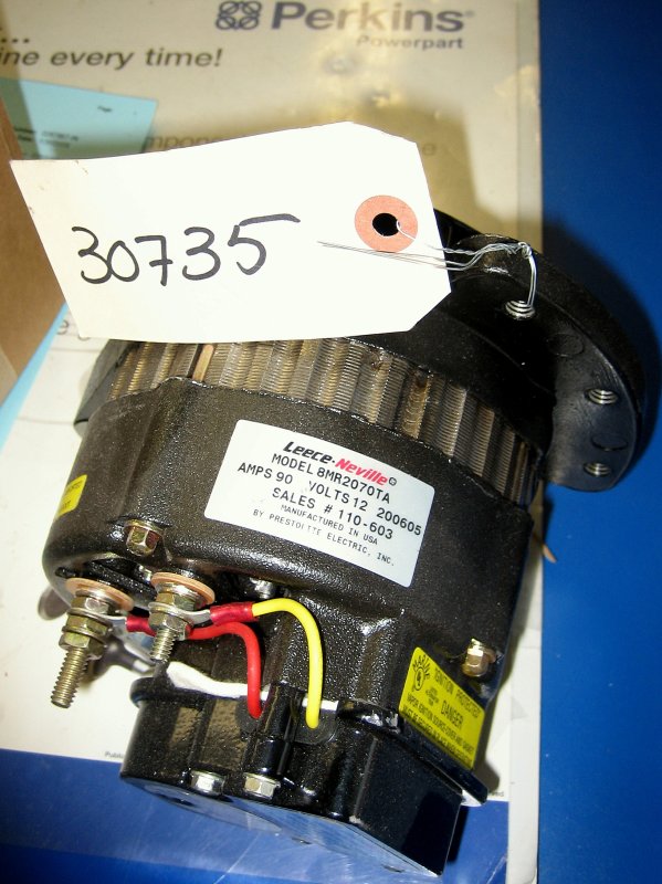

This next one, part #30735 is a 90 amp version of the alternator above. It is a Leece-Neville 8MR2070TA it uses the same exact mounting feet, bolt centers and off sets as the 72 amp version and is also very easy to convert to external regulation.

Something many don't know... Leece-Neville is a manufacturer for some Balmar units, built to Balmars specs of course. Their 8MR series alternators used to be sold by Balmar and are pretty comparable in build quality to the one Balmar used to sell.. The black one, or the 90 amp version above, is even epoxy coated using the same paint Balmar does only in black.
If you own a Universal engine, as many here do, Balmar does not really sell one that won't need some slight modifications for belt alignment and fit but the Leece-Neville is as near a drop-in as it gets. Is teh Balmar 6-Series a better unit, absolutely, but it costs $600.00 vs. about $300.00.
