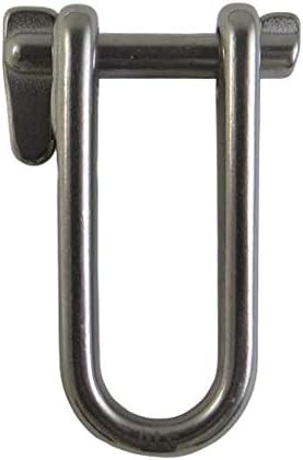

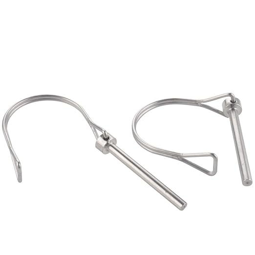

Reviving this older post… new to sailing and have already discovered I can’t stand ring dings/split rings. The dexterity required to put a 1/2“ split ring on a 3/8”W x 3/4”L pin is just insane. I’m trying different quick-connectors like safety coupler pins and lock pin shackles. I like the lock pin shackles, as there are several on the boat already. The safety couplers work well but are too long. I may try cutting them down and bending the safety lock over a bit. This is daysailing on a lake in an 18’ in 5 to 10 conditions, so no heavy stress on the rig. We‘ve only taken the boat out twice so far, but became obsessed with reducing rig/de-rig time on my trailer sailer immediately!
Likes: Timm R Oday25
24,615
Hi @Swabby Third Class I can understand the challenges with split rings. Generally they work on fittings that remain mostly connected on a semi permanent basis.

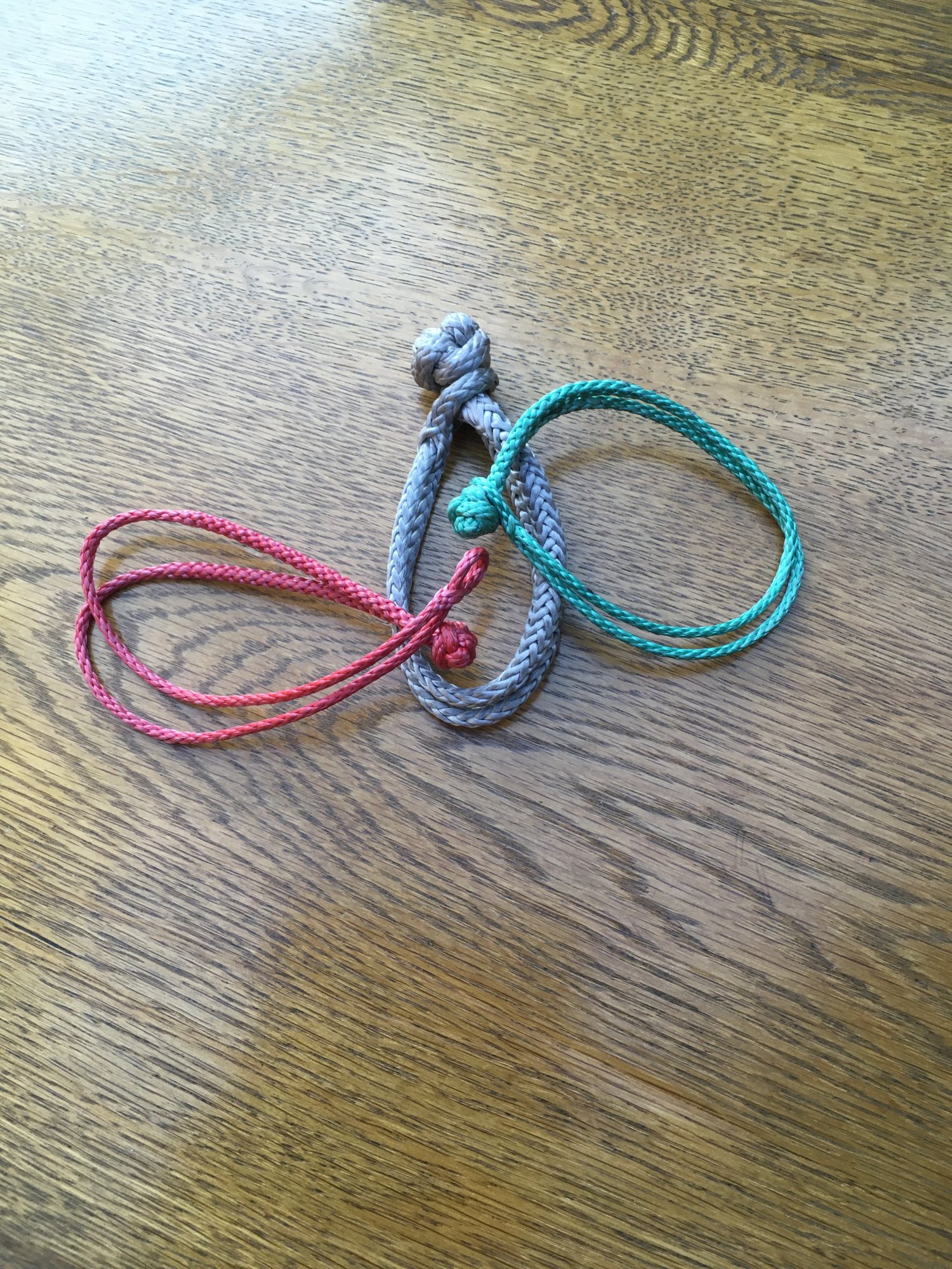

A good alternative to use on items that are open and closed frequently are soft shackles.
At less than $5 if you have to pay for the dyneema line and 20 minutes of your time you can make a coupling that has a break strength of 5000 lbs. It weighs nearly nothing. Is extremely easy to install or remove.
dLj
Mar 23, 2017
5,118
I would move to the lock pin shackles over the safety couplers. There are a couple reasons. The tolerances between the shackle body and the pin are a better fit, I think you'd be hard pressed to get those same tolerances using a safety coupler. Secondly, that safety coupler makes for a great snag point for lines.
Using soft shackles in this application would not likely be very easy to implement. It's hard to avoid variation in the closed position and dyneema tends to creep so they will stretch. Plus you probably have hard corners where they would need to be attached - dyneema does not play well with those. If you wanted to go that route - you'd likely have to make attachment points for the soft shackles which would be a big job.
dj
Oct 7, 2025
16
Hunter 18 Clarks Hill, SC
Thanks for the quick responses! The soft shackles, while a great idea and inexpensive, won’t work for the pins and ring dings I’m replacing: roller furler attachment and shroud chainplates. I’ve ordered two of the lock pin shackles to try them out. Agree about the safety couplers, although on this boat, there are no lines nearby that can snag. Stepping the mast does cause them to bind a bit, but then they sit and behave themselves. Doesn’t look as elegant as the pins and ring dings, but I believe in function over fashion. :)

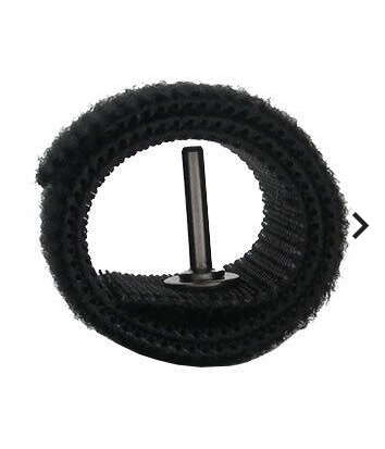

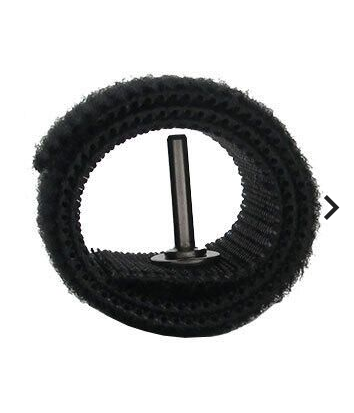

The scar pins (I call them velcro pins) are the cat's meow for a trailer sailor. When I bought my current boat (Mariner 19) it already had most of a set of the velcro pins. I realized how much of an improvement they were over split rings, and completed the set for turnbuckles on all 4 stays (and bought a couple of extras). Defender has them in several sizes, only the smallest size worked on all my turnbuckles. Spendy but well worth the money. No tools needed, just apply after you get the turnbuckle at the right setting. Infinitely reusable - most of mine have been out in the sun for 6 years without issue other than a little fading. After years of notched finger nails trying to make split rings work, cotter pins breaking and/or needing pliers to pull, the velcro pins were a blessing. And no snags either.

Fred, is this what you use? I tried the Defender link to find them, but it just goes to a catalog page. Didn’t show these.
SCAR Fast Pins - 1/16 X 3/4 - Pack of 8

That is what I use, made by CS Johnson. Called CS Johnson Hook and Loop Locking Wrap Pin. Pic from Defender attached. I use the smallest size, 3 sizes listed.
