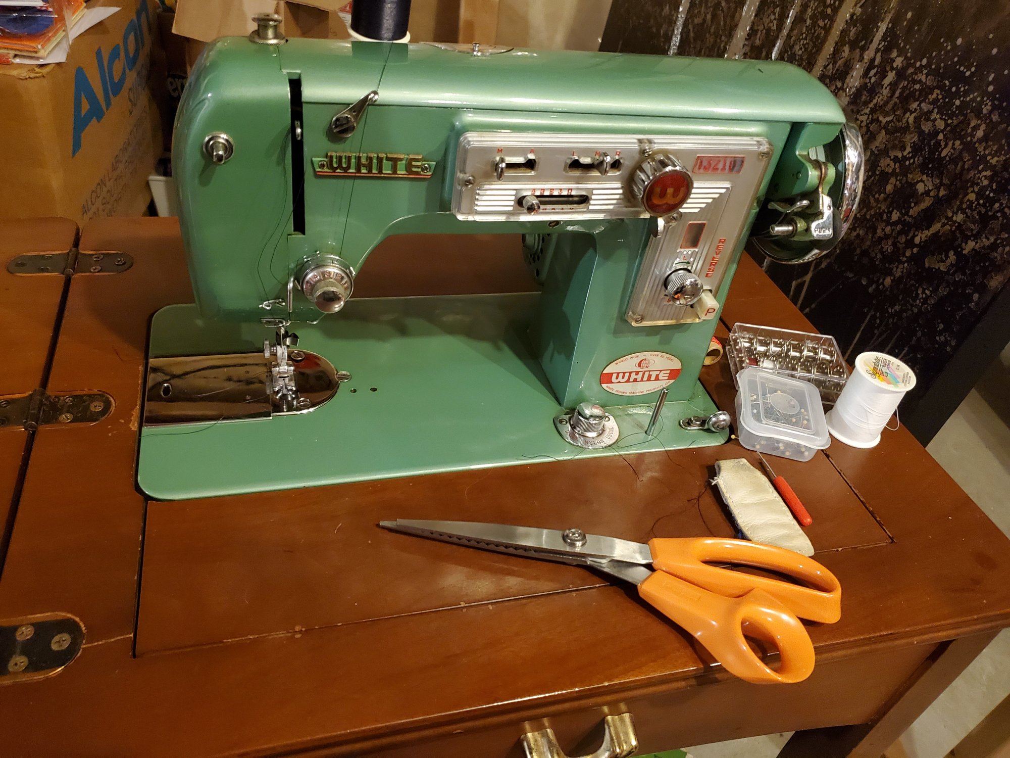

Agreed. Can anyone speak to how practical it is to sew Sunbrella with a regular home machine? Or would you absolutely need an industrial one?
I have sewn a main sail cover with an old White sewing machine I picked up at a thrift store for $20. It worked very well.
