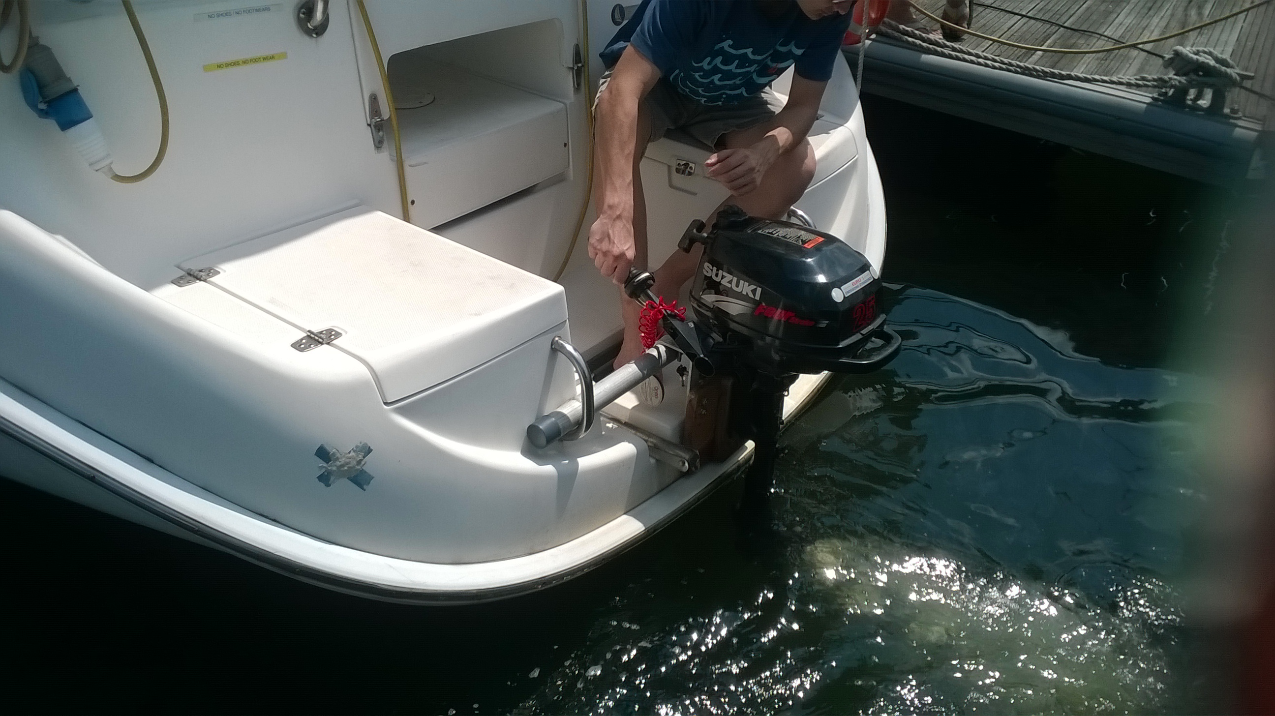

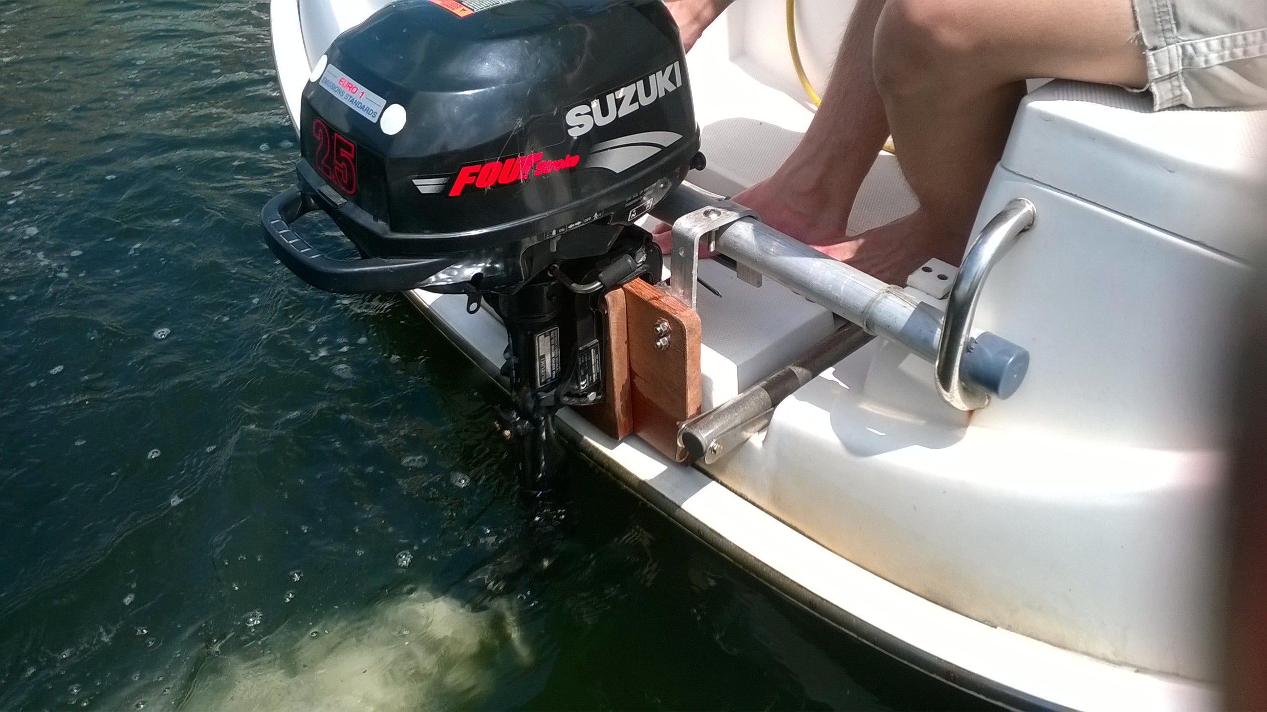

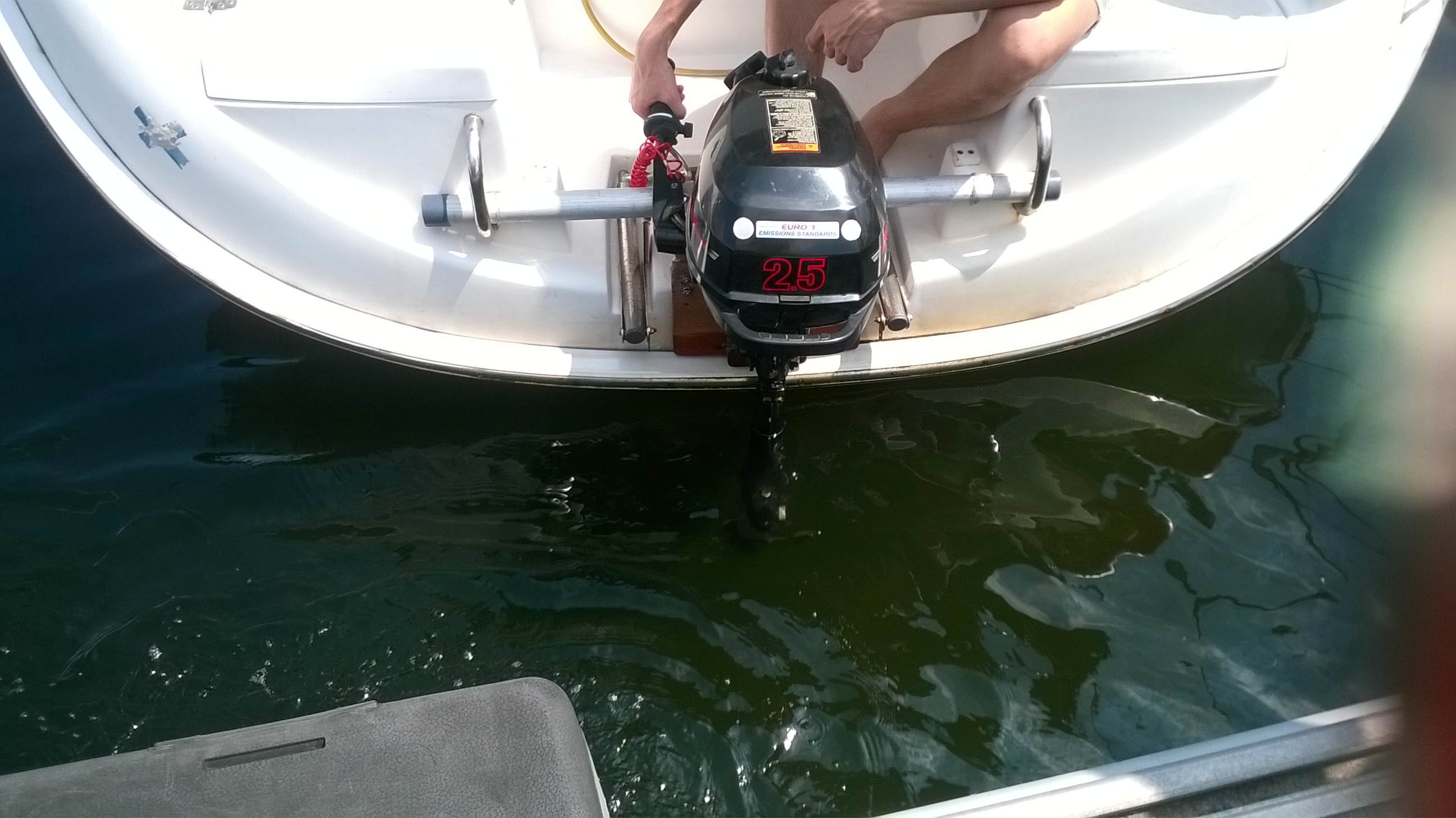

Nice adapter but I'm not sure how the engine would work in other than calm protected waters. I think towing the boat with the dink would be more efficient as the stern would not lift as high in the smallish boat.

I think that you will find that towing with a dingy is very inefficient use of the minimal available power. Pushing is much better. I have returned to dock once from 3 miles out when I lost the water pump and helped several others move around the marina without power. I butt the bow of my inflatable with its 2 HP Honda under the swim ladder and tie a couple of lines from the stern cleats to the grab handles on the stern of the dink. if going a short way I drive from the dink while a helper steers the main rudder. When I had to go 3 miles I just revved the outboard and then got into the cockpit and drove until we got close. I was able to make about 4 knots but didn't have current or wind.
If the stern of your boat will not allow the dink to nest into it you can side tie the dink with spring lines and do almost as well.

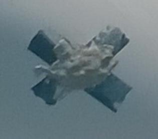

What's with the minor "owie" on the back end ?

That was my bad. I used to approach my stern for boarding when on inflatable dinghy. One time i was on a water taxi and asked it to drop me off stern instead of side, big mistake! I forgot the taxi was a hard dinghy. Bump! Crack! :(
Oct 29, 2005
2,366
Yes agree, the obm will spin in air when there's wake. This is last ditch effort if i don't have a dinghy to push. :)

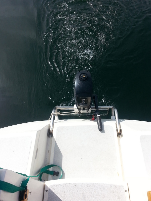

I have the same type of setup. The photo is old, the outboard is no longer with me, but the concept is the same. Mount the outboard on the swim step, which serves a couple of things:
1) It's now a trolling motor
2) It works with the autopilot and helm if set to center of the boat (using ropes)
3) It can push the boat in calm waters 3+ knots
4) Can serve to dock the boat if the engine fails.
So, yes, it's an "emergency" backup, but fuel/range is limited.
Now... If the wind is blowing 20 knots, call for help!! But for fishing? :dancing:
BTW: I absolutely applaud the OP for brilliantly thinking IN THE EVENT of an engine failure!!! The guy is thinking "extra" safety for himself and family. Yes, the inboard WILL FAIL eventually.
