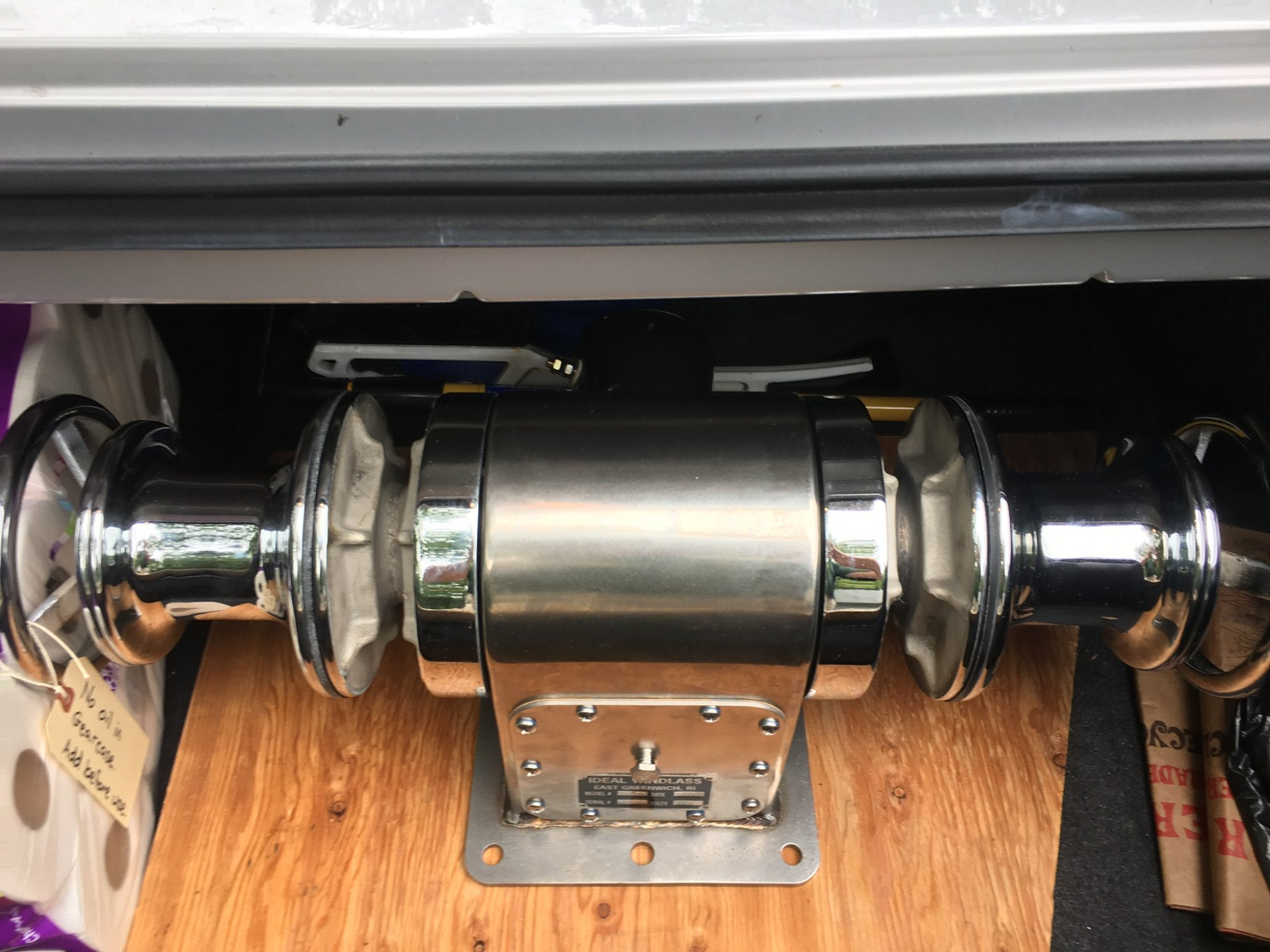

Here’s what Schaefer Marine did for me. What you don’t see is the new motor, but a total rebuild of my Ideal windlass. You would need room in the anchor locker for the additional parts.
We spent a while checking sources for a new windlass and couldn’t find any of the same capacity without a lot of reconfiguration. Ours has the clutch, outside wheel, so we can use one side only. You won’t need that.
