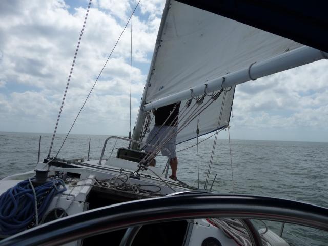

Sure a lot of answers. If the girl in the picture is going forward each time, I would leave the lines alone. If not.....? My boat has generally all lines run to the cockpit under the dodger. I really don't care but when the wind is over 30 knots, I care. I am not sure what the percentage increase in movement is around the mast in rough seas but it tends to be a little softer in the cockpit. You still need to go forward to set and unset poles, tie up the main sail, and in a real blow, you might have to tie up the ginny. If you are alone, always scary out there even with the jack. If you have crew that is a bit new, easier to show and tell in the cockpit. Good luck on your choice.

Now with that said, if I'd had somebody like the person in the picture to go up and do my dirty work, well then hey....go for it!
