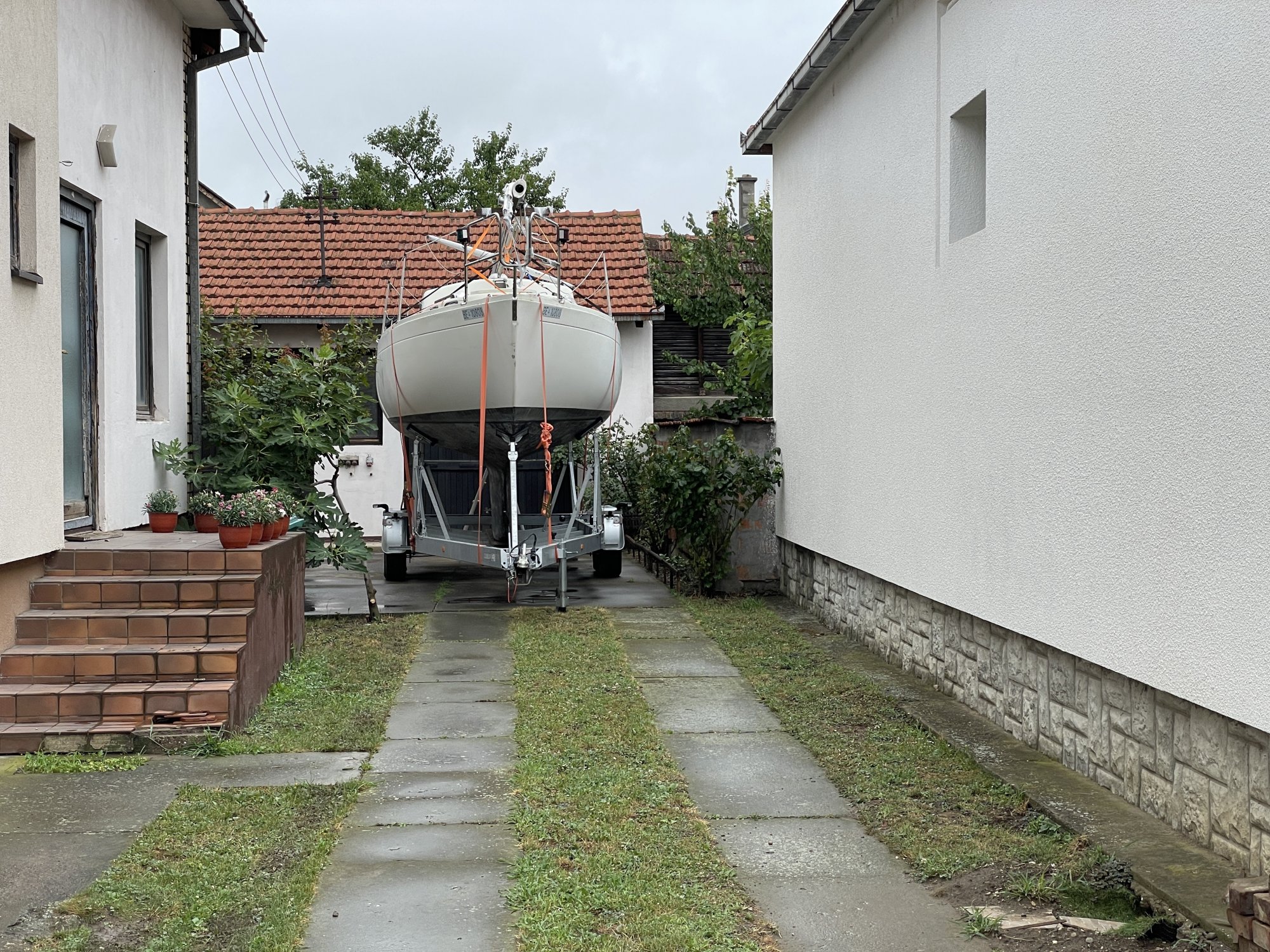

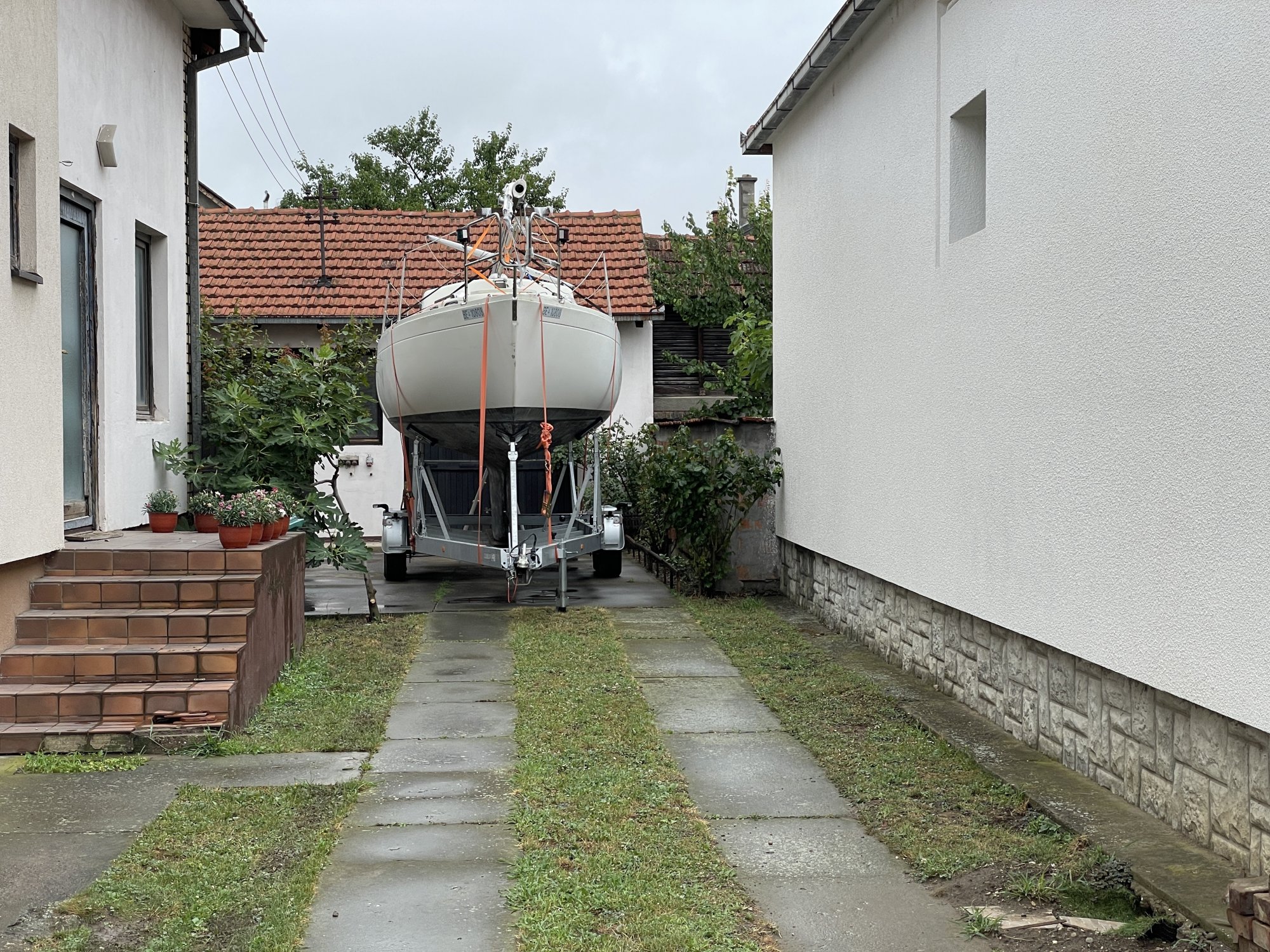

I have just bought mine. It will be in my hands by next Monday God willing. My biggest hurdle is the transport from Switzerland to Serbia many moving parts and all the import complications i am not sleeping at all these days. Been dreaming of this boat for so long now that it is so close seems like everything is out to get me. I will post a pic when it is im my yard :) 3278

Snug fit.
She looks at home.
