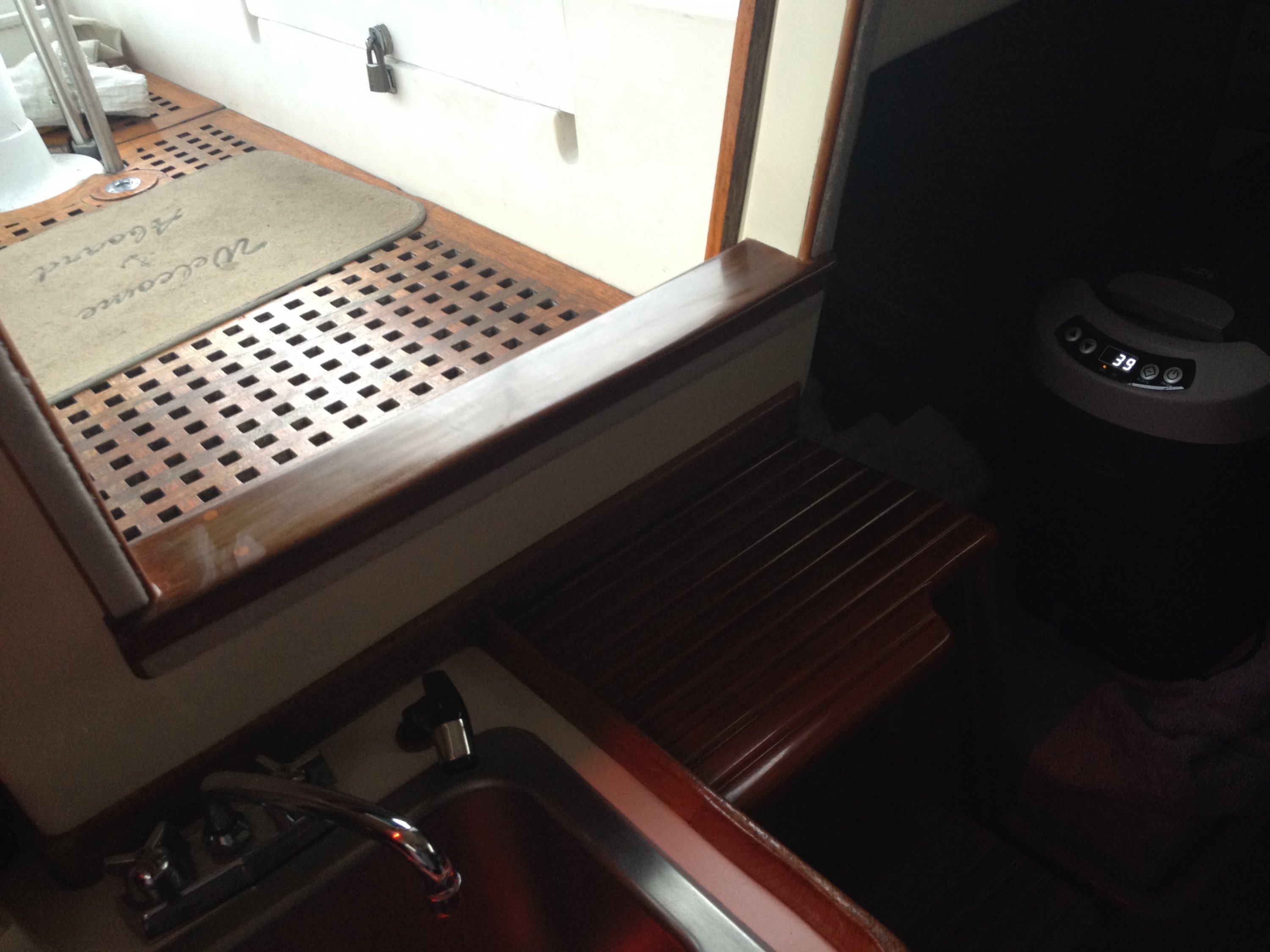

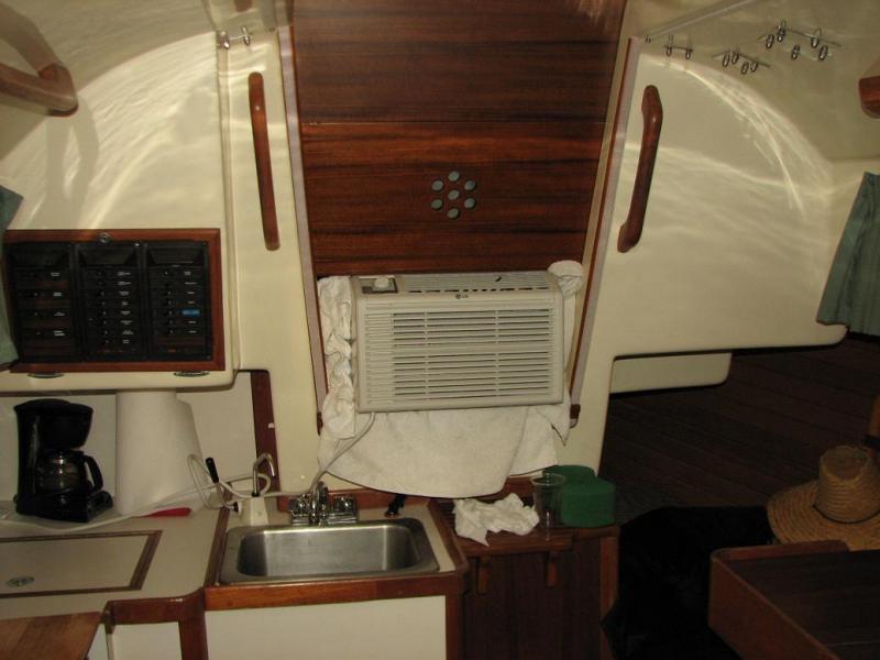

See below.
The rear of the unit sits on a plastic tub just low enough to tilt the unit back towards the cockpit to drain condensation. I don't have a bridge deck (other pic).
It's not gorgeous, but it was $100, takes 3 minutes to install, and it works. Remember, only 4 months a year.
The unit stowed in the quarter berth. It lived in the garage during the other 8 months.
This is of course only usable dockside.
