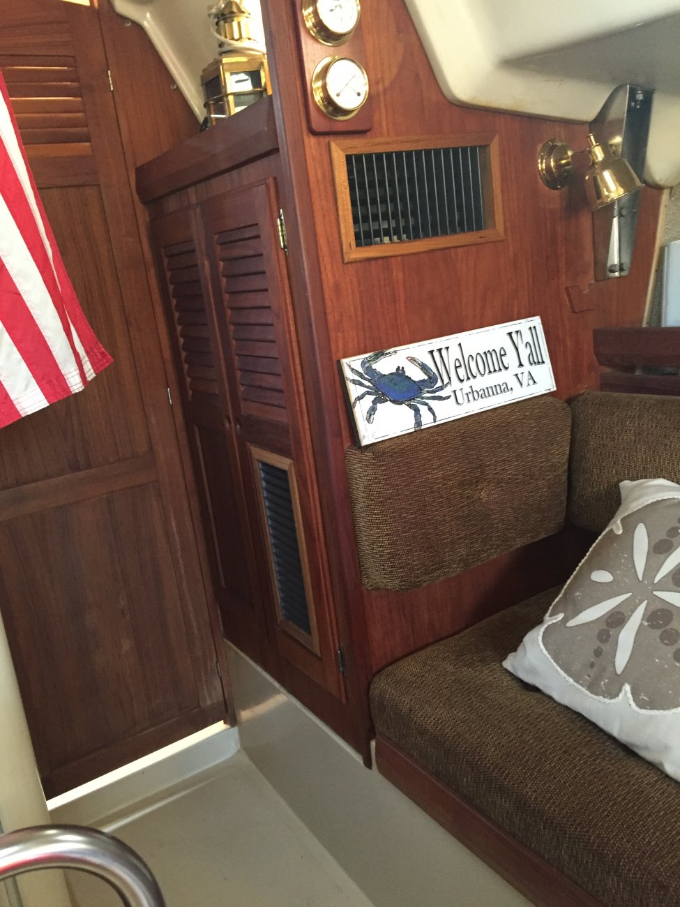

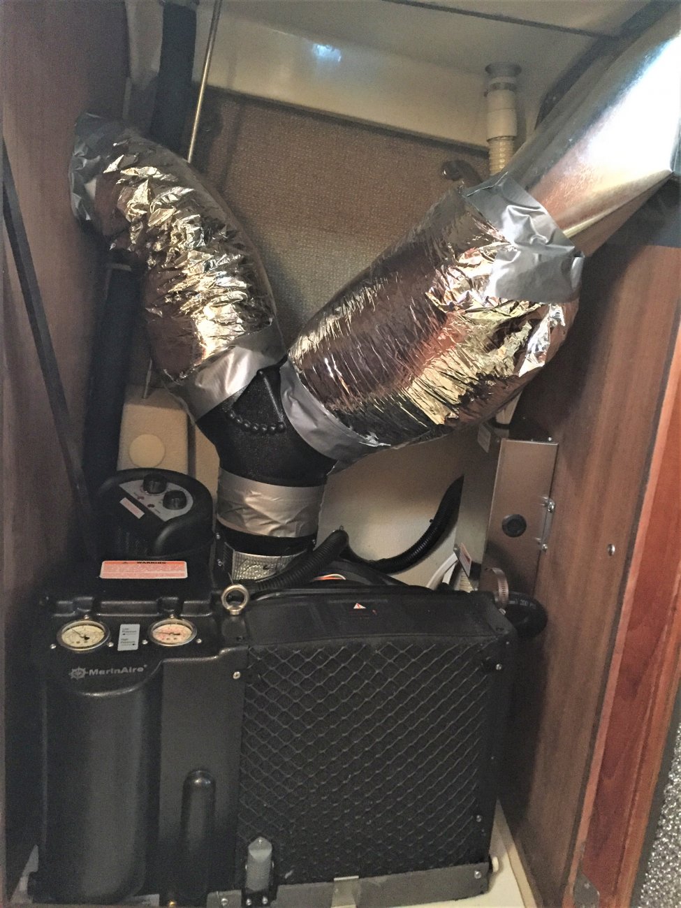

Easiest install is the forward hanging locker. From there you can easily duct into the v-berth (4" duct) and the saloon (6" duct). The louvered doors of the locker are adequate for the return, however I ended up a return grill with filter there just to be sure. There is a filter on the unit itself so that's probably not needed.
Go with 16K BTU. Mines a reverse cycle unit which is ok until the water temp gets below 40 degF.

Scott, thank you for the great pictures.
Looks like the locker becomes pretty much unuseable? Would the 6 inch duct fit along the hull to exit at the shelf behind the settee? Unfortunately we store a lot of stuff in that locker and are reluctant to lose it. Also wondering if a split system with air handlers like those used in power boats might be an option.

Yes it pretty much consumes the locker. The transition and duct work take up a good bit of space. The MA system that I have allows for 360 degree rotation of the blower, so there are multiple options to route the duct work. My goal was to eliminate as much opposition to the airflow as possible so I wouldn't have to worry much about insuring an adequate air flow.
Haven't studied split systems so can't really comment. One school of thought is to install two smaller units. Other than giving you more options for install space, individually they take less power to operate which gives you the option of running one unit of a generator.
