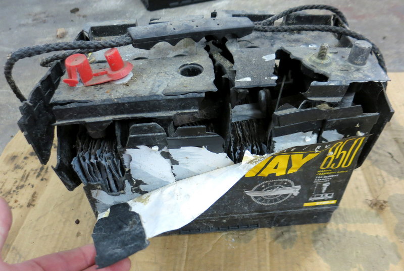

The only explosion of a lead acid battery that I am directly aware of happened to myself when I had an alternator go bad on my car many years ago. The battery boiled out almost entirely. I called AAA for help. I told the driver of the tow vehicle not to attach jumpers but instead bring battery (distilled water) so I could drive the vehicle home, a distance of about 1 mile. Instead he tried to jump a nearly empty battery that promptly went BOOM!!!!!!:banghead:
Feb 6, 1998
11,772
This happened a few years ago. Automotive charger on a marine battery. Boat was very heavily damaged by acid & luckily no-one on-board at the time.....
