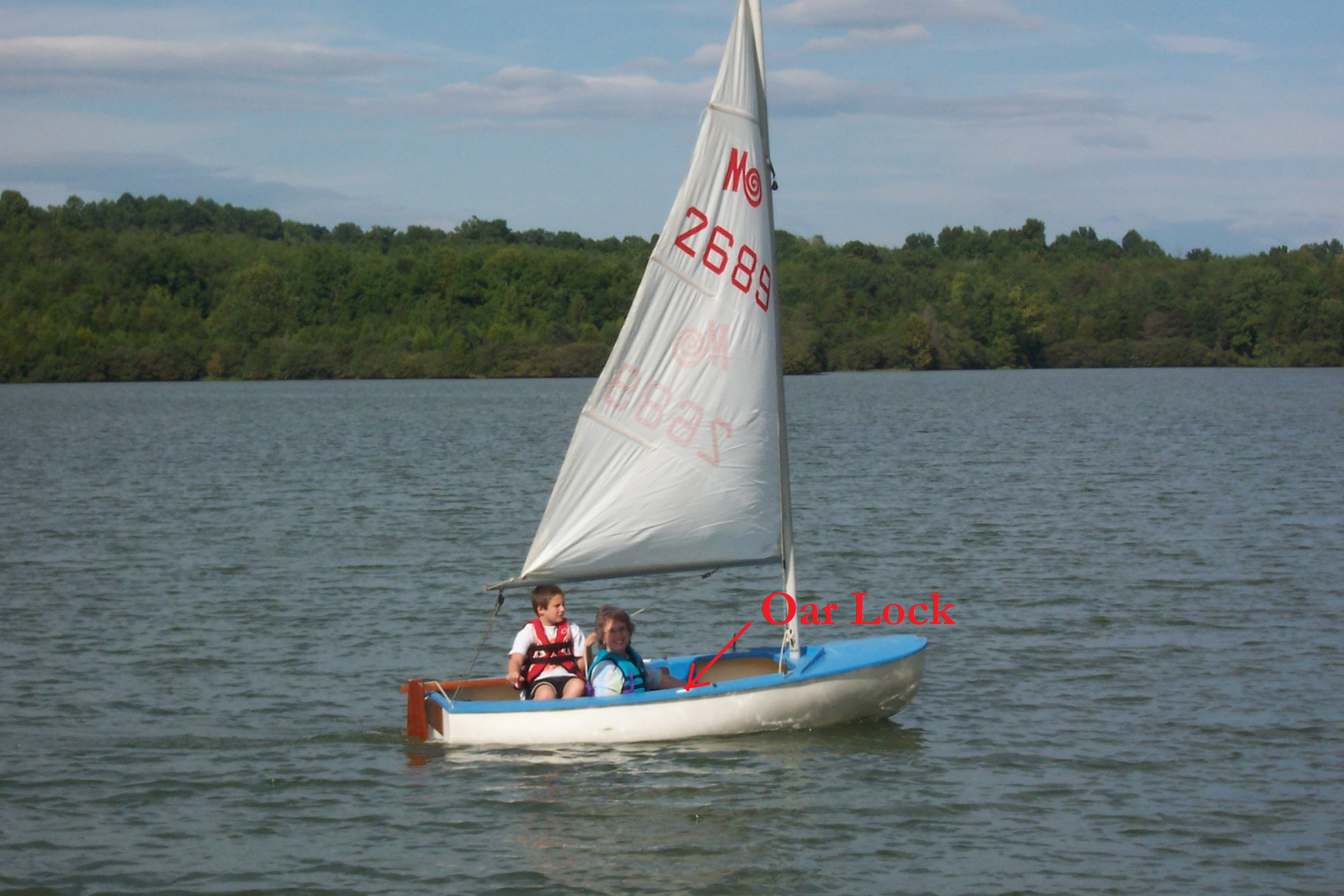

How does one use oar locks when there is no place to sit in the middle of the boat?
12,995
I don't know your boat but in the McIntire I sat on the dagger board trunk.
