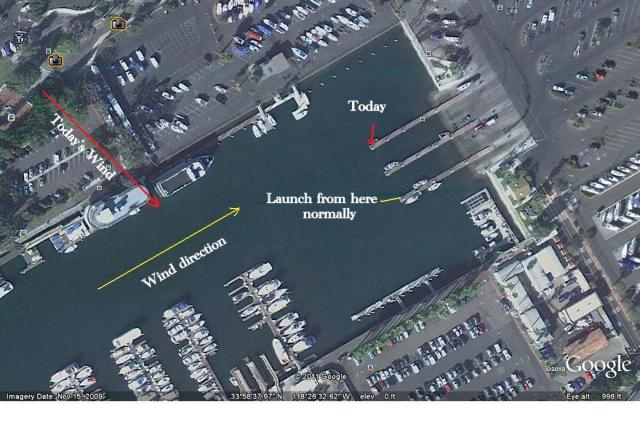

Jrale, with today’s Santanas it would be a good day to go out. The wind is blowing out of the NNW at 12kts. Normally it is from the SW and blows directly down the channel, so you have to tack a dozen times up the narrow channel to get to the main channel. You will likely need two people, one to steer and one to work the jib. I wouldn’t try it with the Genoa in that narrow channel. Today you could solo it straight out the channel. There are seven foot seas today but sailing in the marina would be a blast.
Make sure you have and anchor with you just in case, also a good boat hook. As mentioned earlier when coming in and it is still blowing hard, unlock your keel leave it down and just ground on the ramp if you get into trouble. Come in on your jib only, it is easier to control the speed you can release your sheets completely if needed.
If you want to get fancy you can hang a uturn as you approach the dock and dock facing up wind.
Here is a link to UCLA weather and web cam of the main channel.

Here is an example of a perfect docking in about 12 kts of wind at MDR.
