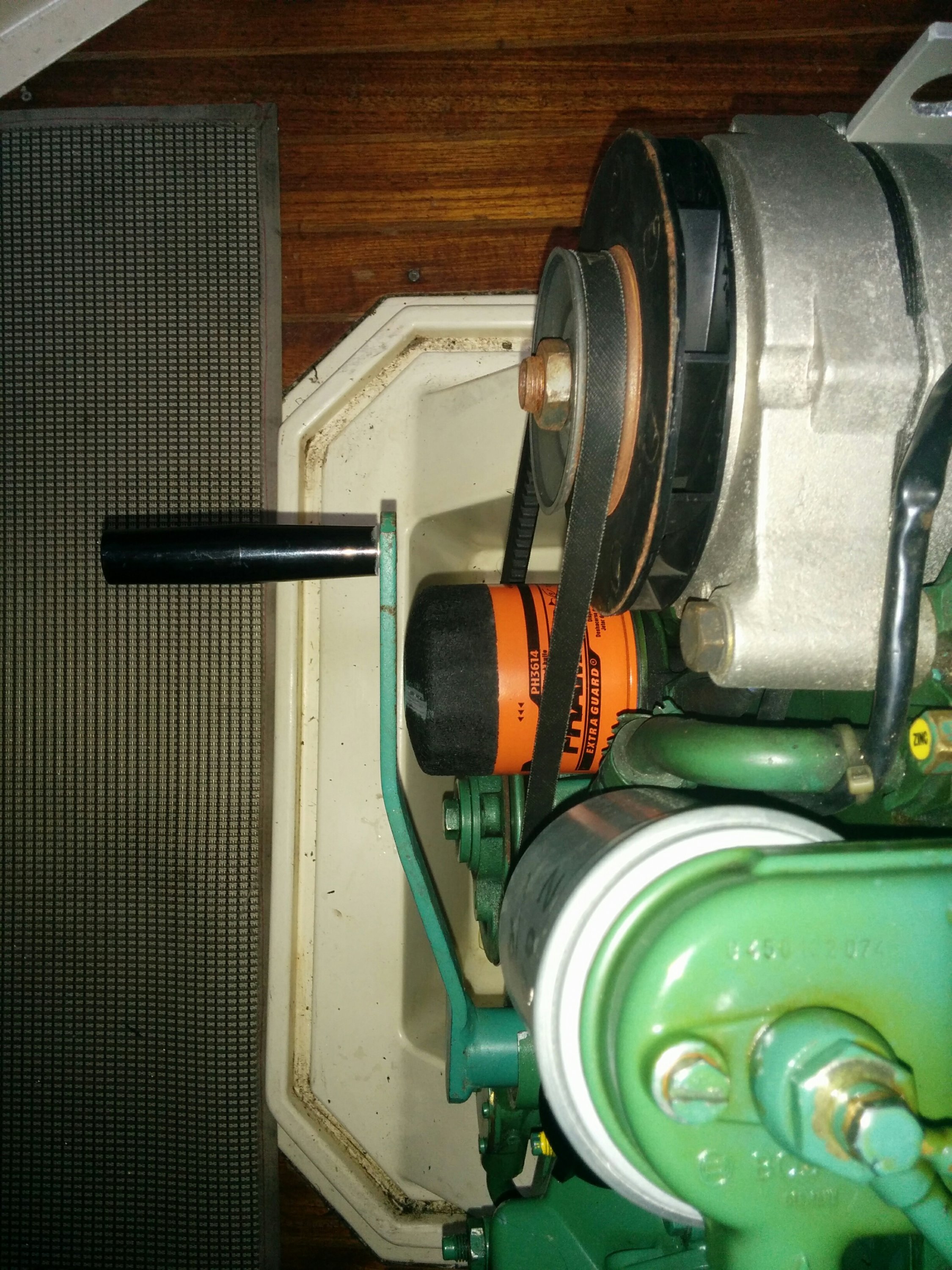

Tried Fram PH3614 on a V.P.2002 seems to fit well with no oil leak at 3000 rpm under load for an hour. I believe the thread is metric that why it fits.
The only exception is a tad too tall for the hand crank to clear without touching. I've never use the hand crank. Looking for a way to modify the hand crank by 1/16 of an inch.

Finally I did it. Use PH3614 for V.P.2002 and modified the hand crank to clear the height of the new oil filter.
