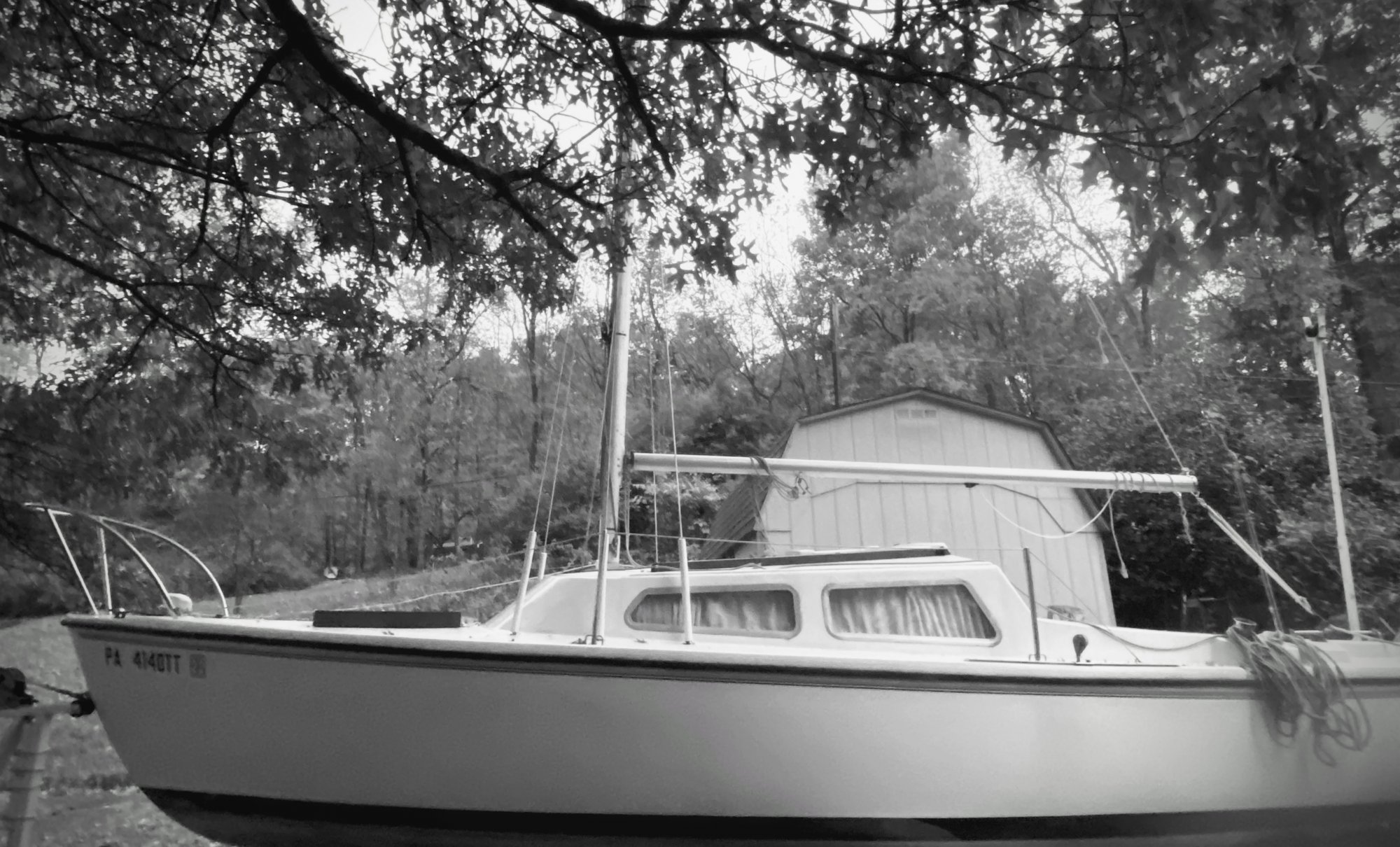

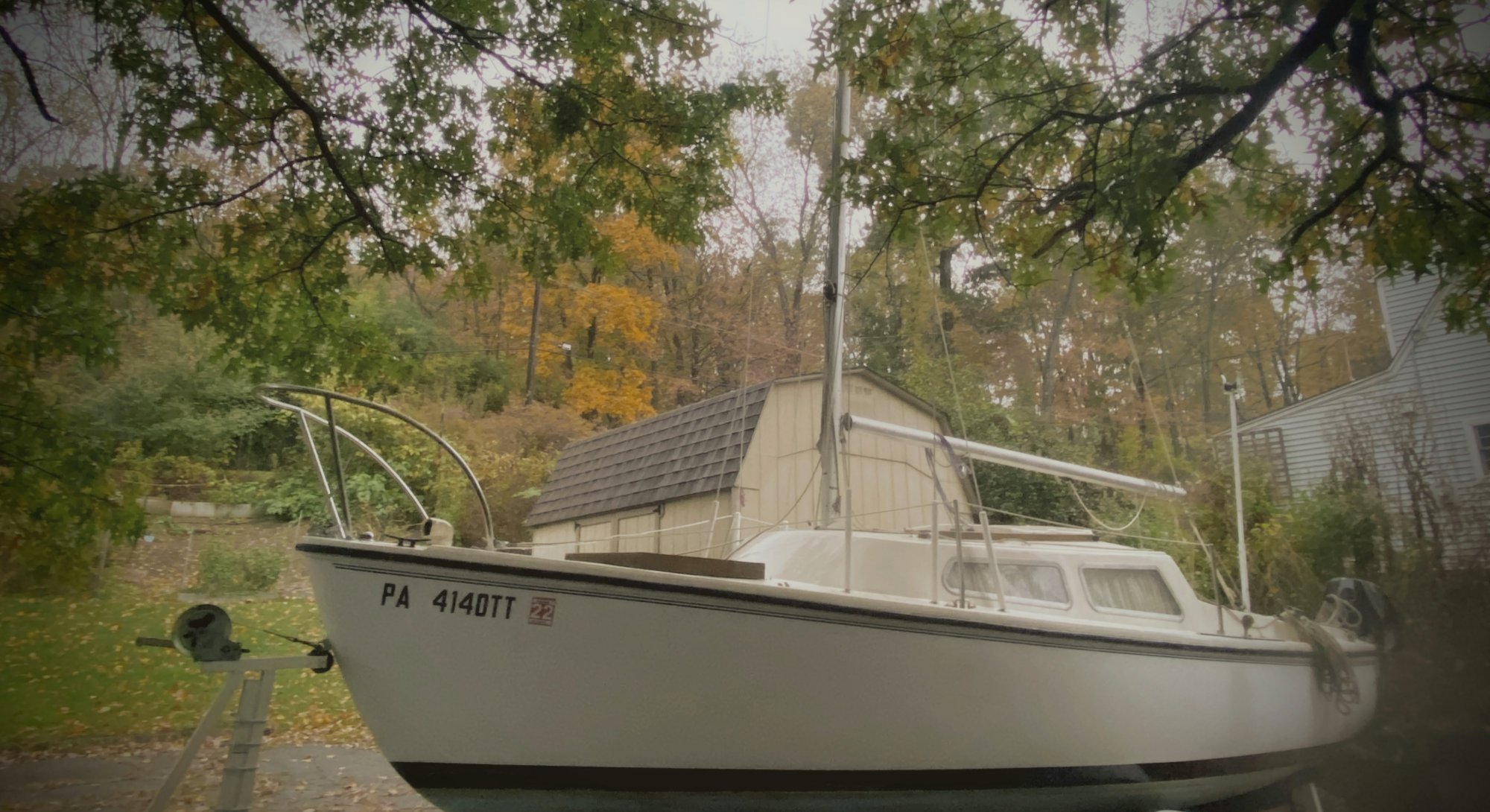

I posted some pics of my boat, sorry no good angles of the cockpit but its all I got right now. I now have a full 1 piece stern pulpit and the backstay Y's off just above the boom height.
Sep 24, 2018
4,821
Catalina 30 MKIII Chicago
Unless you have a canvas shop make you a bimini, you will likely need to modify your fabric to accomodate the back stay. Luckily it's very easy to sew zippers. I bought a 42" zipper for $16 on amazon, cut it down, sewed it in place of the old one and added stops from a $10 zipper parts kit. The hardest part for me was removing the old zipper threads.
