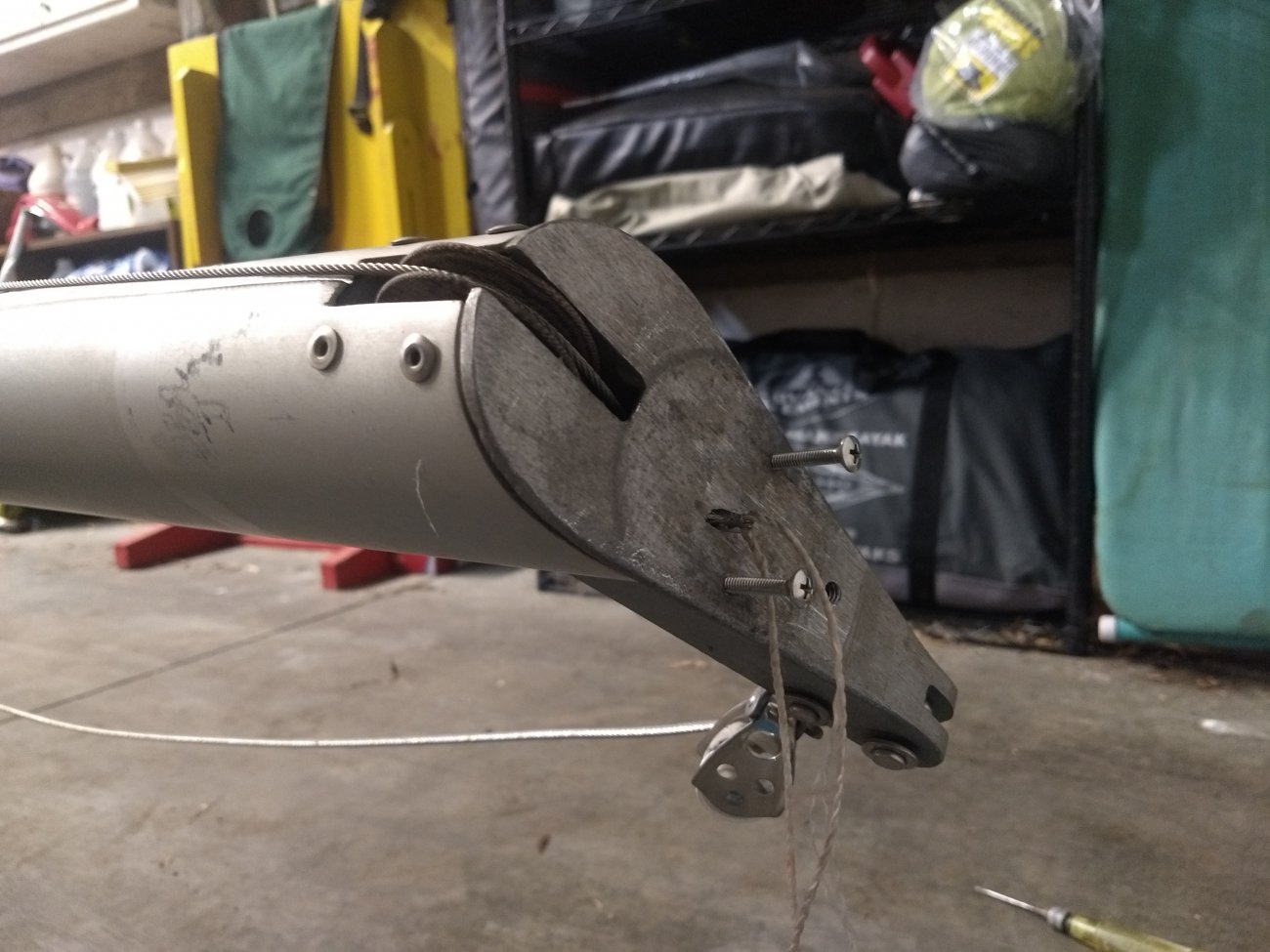

I can't pull the wire up from top or down from bottom. It appears to be loose looking up from the bottom, but I can't see more than half way up. Does this mast head look familiar.

When you say "worn out wiring", are the conductors bad?
You could probably remove the top assembly by drilling out the rivets. You could re drill and add two two wires to the masthead light. Are you ready to start surgery, or do you need to?

The wires were cut at both ends near where they entered the mast at the bottom and where they exited at the top. The idea of redrilling on the top plate and then rethreading wire, (while leaving old wire) seems the most straight forward. If I did drill out the 4 rivets, could I tap the holes and replace them with 4 bolts? Or would new rivets be required. I don't have rivets that large.

I think I'd avoid drilling out the rivets. If the wires are otherwise okay (i.e., the insulation is good and the copper is not corroded) you might try to simply extend them. You can always replace them later. An LED will draw less amps.

IF the wires are "good", then use marine grade wire and crimps. It's not "perfect", but you're sailing on fresh water lakes in modest season. The wires section to look at first are those exposed to the sun at the masthead. Is the insulation sun baked or is it still sound?
While you're looking at the masthead, make sure the sheaves are rotating freely. Check the spinnaker /jib block attachments, etc. If everything is sound, then I'd not be drilling out the rivets unless you have to.
