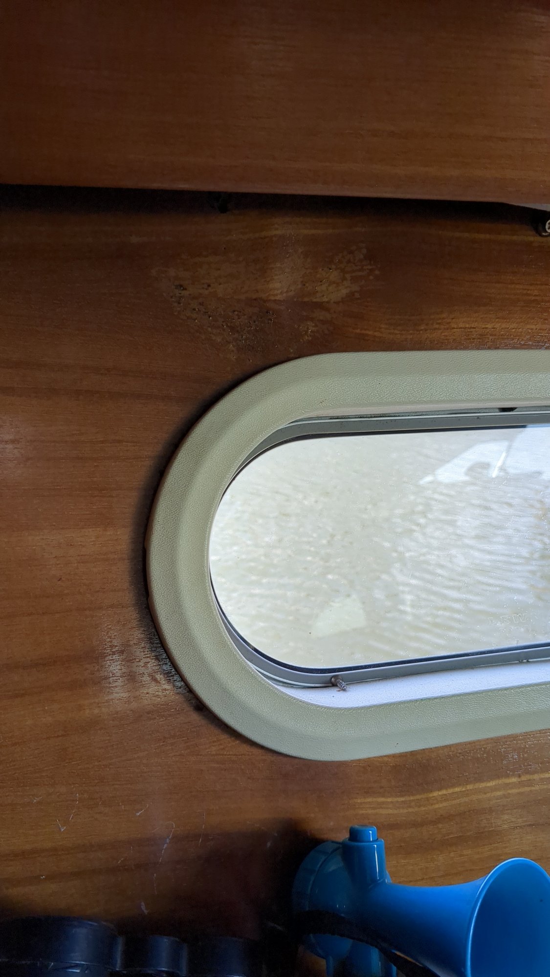

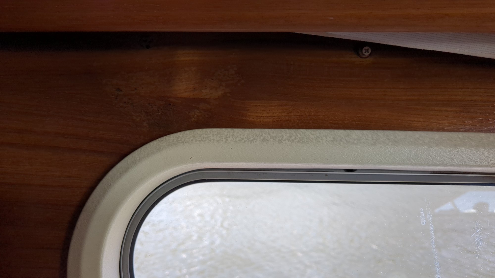

I am in the process of re-bedding all the chainplates and stanchion bases on my 2002 Catalina 310. I have some visible warping and discoloration at the top of the panel above the starboard settee. I've attached some photos. The damage is above the window in the photo and to the left right behind the chainplate tension rod. It feels very dry where the damage is and I haven't seen any leaks. But it sure seems like water damage to me. Once I re-bed everything, my question is might it be possible to remove that panel and replace it with something that at least comes close to matching it? I can see all the screws that would need to be removed and, presumably, so would the internal frame of the window. Any advice on doability and where I might source a panel? Thanks in advance.

It would probably be easier to repair what you have than try to match it. Hard to tell from the pictures but it looks fixable. If you can remove the panel it looks like you could sand the damaged surface to clean it up (not too much, almost assuredly it's a veneer) and then glue the plys back together and clamp some large flat boards on either side to flatten out the panel. Otherwise, maybe Catalina or Catalina Direct would have a panel. Or you're looking at getting some teak veneered plywood and making a new panel and matching Catalina's finish (which they publish).

The plastic trim ring inside the port is a "crimp" (?) fit, you can see on the end one of the tabs holding it to the interior metal frame. Grasp and GENTLY pull it towards you to remove, then you can see if metal portlight frame must be removed to remove the wood panel. I don't know what that panel is for matching purposes, the 320 uses a very light colored beadboard.

Not a knock on Catalina (I've owned a few and currently have a 315), but that panel is probably not particularly robust. My guess would be 1/4" ply with a thin, and I mean THIN veneer of teak.
If it was my boat, my first inclination would be to remove that panel and use it as a template to create a new panel with a new one using the same type of veneered ply. I wouldn't attempt a repair on the existing panel, as it's likely warped and damaged into oblivion. That thin veneer will tolerate very little sanding.
You can confirm what Catalina used to finish their interiors in 2002, but I'm going to guess that it's some sort of a poly finish, with possibly no stain. Which is good, because that means you don't have to match the stain. I'd start by working on a scrap piece, and see how the scrap looks with a few coats of clear poly. If that looks too light/sterile, then I'd try a couple light stains, or maybe just some sanding sealer to warm it up.
