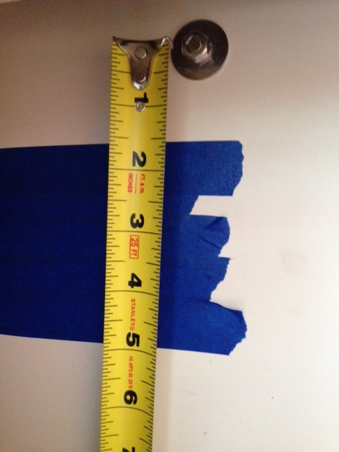

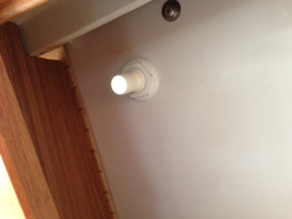

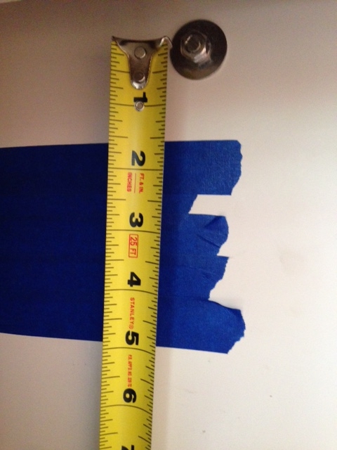

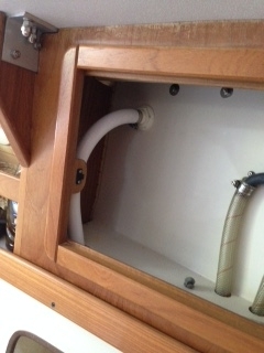

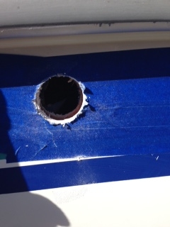

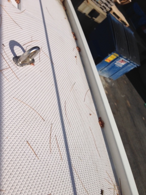

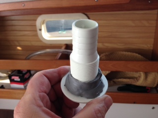

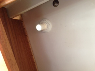

I used a hole saw. I did this a few years ago. I used the bolts holding the deck to the hull and a chainplate as a location guide. Measured 10 times :) and cut the hole to fit the fitting. I used 1" hose and a Uniseal per Peggie's instructions. I went almost straight up which isn't the best scenario but It has worked well. We almost never have issues with smells anymore.I put the hole exactly where you reference. I didn't use a clam shell as I would really have to bury the rail which I try avoiding at all costs.

Thanks Bob! Pretty straightforward, just drill a hole...
(use an open "bulkhead" thru-hull fitting, NOT a "vent" thru-hull)
The guy I talked to at Catalina was adamant to use a vent thru hull and Peggie says adamantly not to. I really don't see the difference, other than cosmetic. Neither will prevent water from entering, so why does Catalina insist on this? I couldn't get a satisfactory answer from the guy...

Okay, I just got off the phone with Jerry Douglas, an engineer for Catalina in Florida. He says that I am going to be cutting through the hull liner as well as fiberglass, and that means there will be an air space in the hole that I cut. This means that possibly water could get inside so I need to be sure that either my fitting is sealed well or that I fill the inside of the hole.

To clarify Bob, you drilled from the outside in, so that fraying at the end of your hole is inside the boat. Right?
Jul 12, 2011
1,165
Leopard 40 Jupiter, Florida
It also looks like you sealed yours with butyl tape, following Mainesail's advice.
