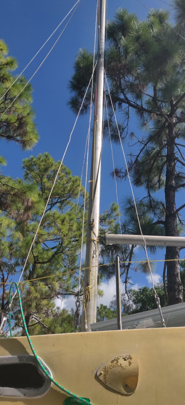

Hello all,
My name is Zach and my boats name is soon to be StarRover, pending Poseidons approval. She is a Vivacity 21, not real clear on the year because my title says 82 but from what I've learned they weren't making these boats in 82 so I don't know. anyways. I am new to sailing in general and am not sure what is going on with my rig. I got the mast stepped and tensioned the rigging as follows forstay, then backstays, then side spreaders, then my half shrouds. sorry I don't know the proper terms. my problem is that my turn buckles are all the way tighter with no more room to adjust but my rig doesn't seem like it is tight enough. honestly doesn't seem to be very tight at all. so I do not know maybe I am wrong if someone is willing to have an open discussion on the matter I would greatly appreciate ANY advice that would be given. thank you so much in advance!!! may the tides be in your favor.
Sincerely,
Zach

Pictures would help. I used to have a Macgregor 22 and the shrouds (side stays) were always a little loose. That is the way those were. But you are correct, on most boats the stays are at least taught.
13,096
Welcome aboard. You will find this forum very responsive and people here very willing to help out. So post pictures, ask questions etc.
... then side spreaders, then my half shrouds. sorry I don't know the proper terms. ....
Uppers and lowers are the more common terms when describing the shrouds. I'm guessing what you are calling "half-shrouds" are your "lower shrouds" or simply "lowers".

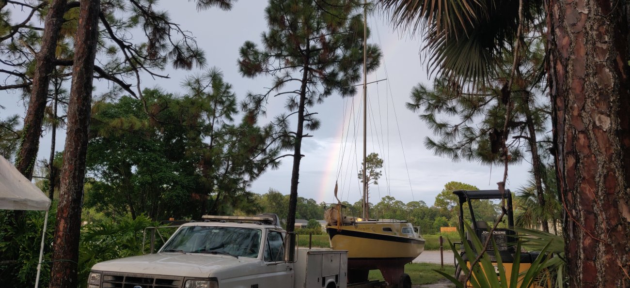

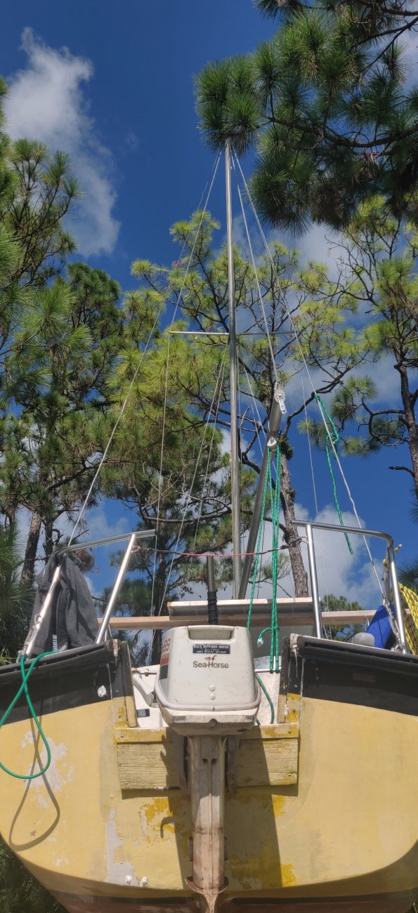

Yes sir I do apologise I actually knew that just couldn't think of the right term. I will catch on eventually. I am gonna post some pictures of her now . It is hard to tell in my pictures because everything looks fairly straight I'ma try to take more from a better view .
13,096
Hard to say. The rig is rather light so it might just be that it has some slack. Or you could put shorter turnbuckles on the bail. Those twin keel boats are interesting. I've never sailed one. They were designed for places with extreme tidal range so that the boat could stand up when the tide was out.
In your pictures it looks like (but it was hard to see) that you might have a rotating boom. Is there a thumb screw on the gooseneck that you can loosen to allow your boom to rotate? I had one of those setups on my Macgregor 22 and it was a nice way to reef and furl the main. Also, if you leave the boom free to rotate while sailing, you will get a better sail shape near the foot.
