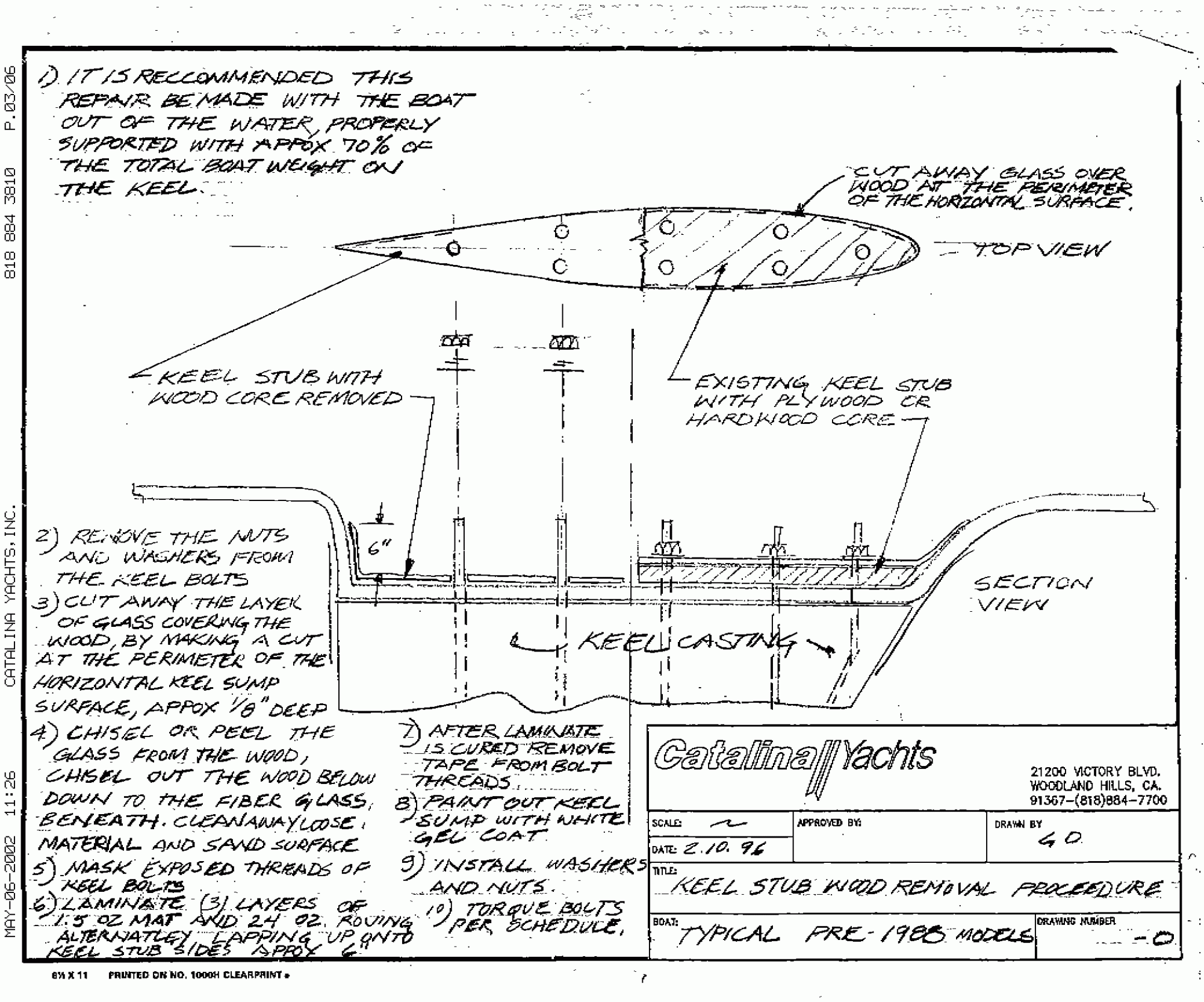

As stated the deck compression may be the wooden block in the bilge which supports the compression post. Catalina Direct used to sell these (white oak?) but not sure if they do anymore. Some people build their own post out of stacks of fiberglass resin sealed wood, or all fiberglass (no dampening with fiberglass). Requires jacking the cabin overhead up to relieve pressure while dong (best with mast off if you can...)
Compression could also be due to rotted plywood coring under the mast in the deck.
Attached is the Catalina drawing for the keel bolt wood repair. This (obviously) has to be performed with the boat out of the water and the keel supported
