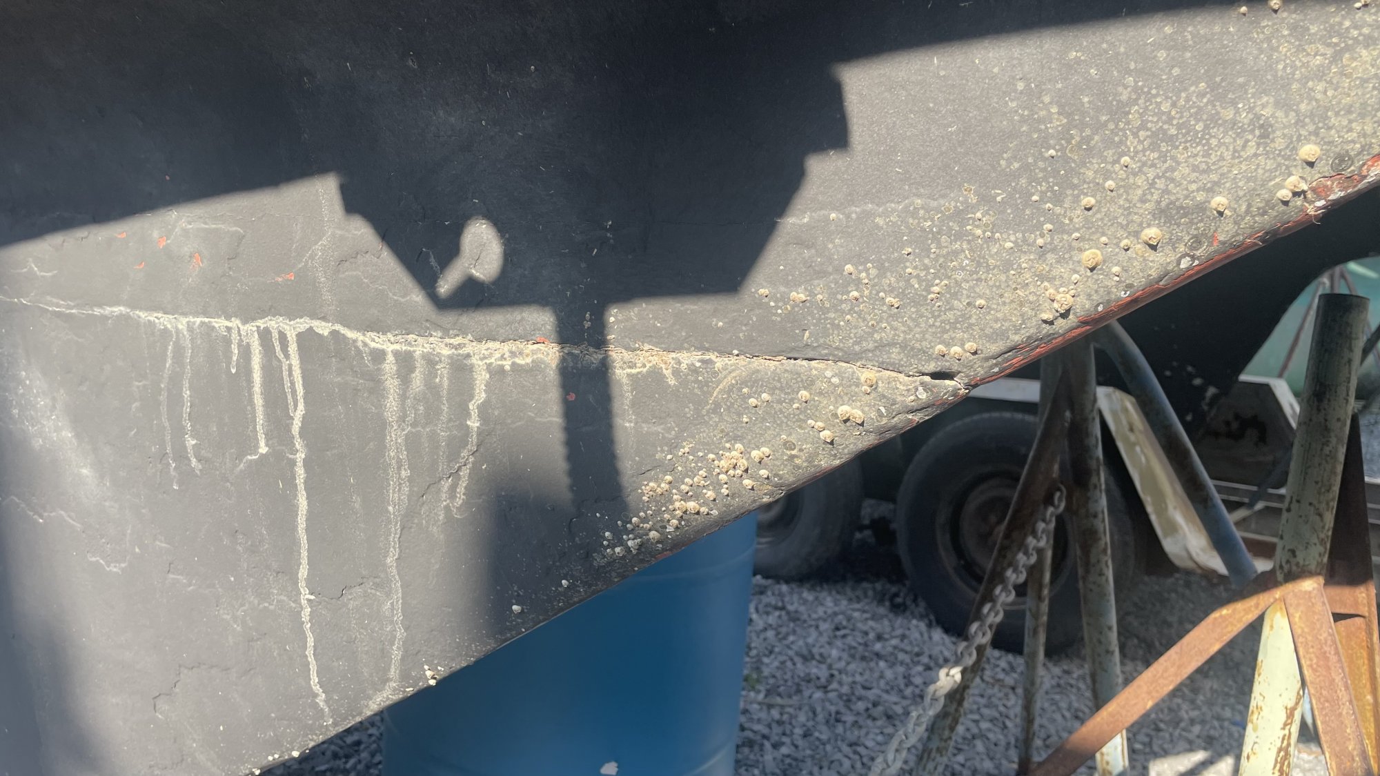

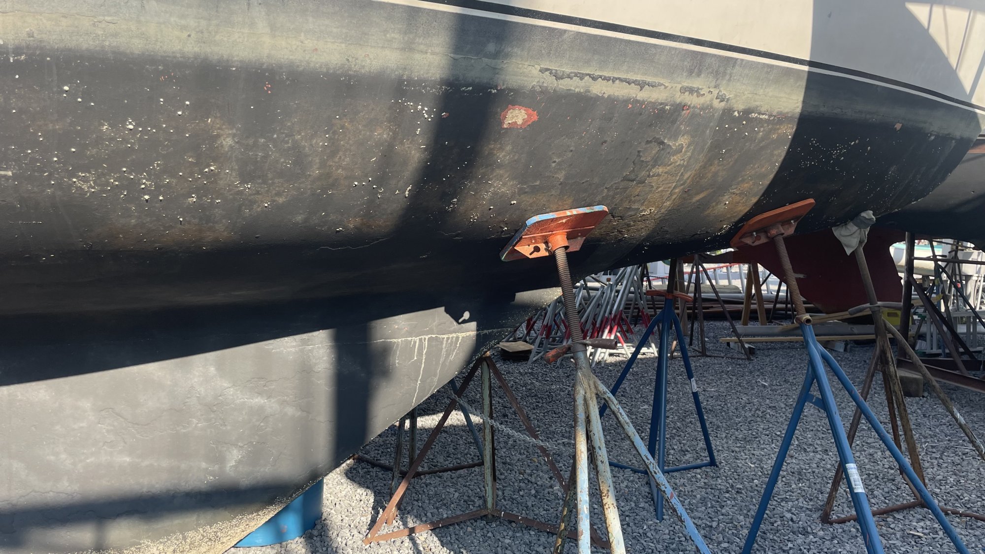

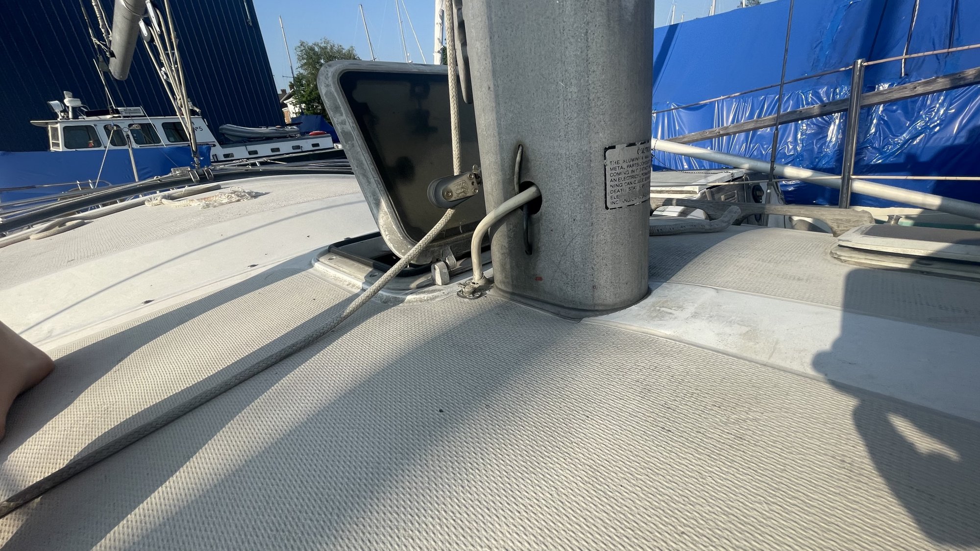

I’m a C27 for now but looking at an’83 C30. She is ‘well used’ but I see more life in her. 2 concerns I have. The famous Catalina Smile.. it looks significant but in don’t know. Keel bolts are good looking stainless. Is this a concern that should prevent my purchase? How do I fix this.. and

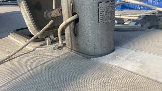

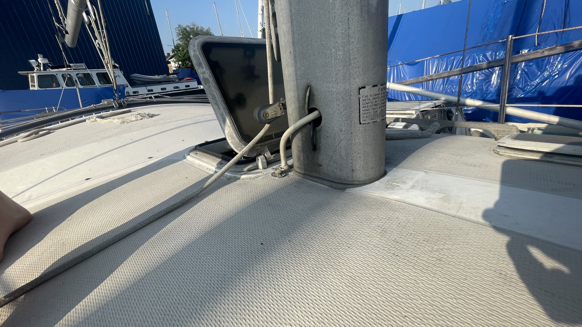

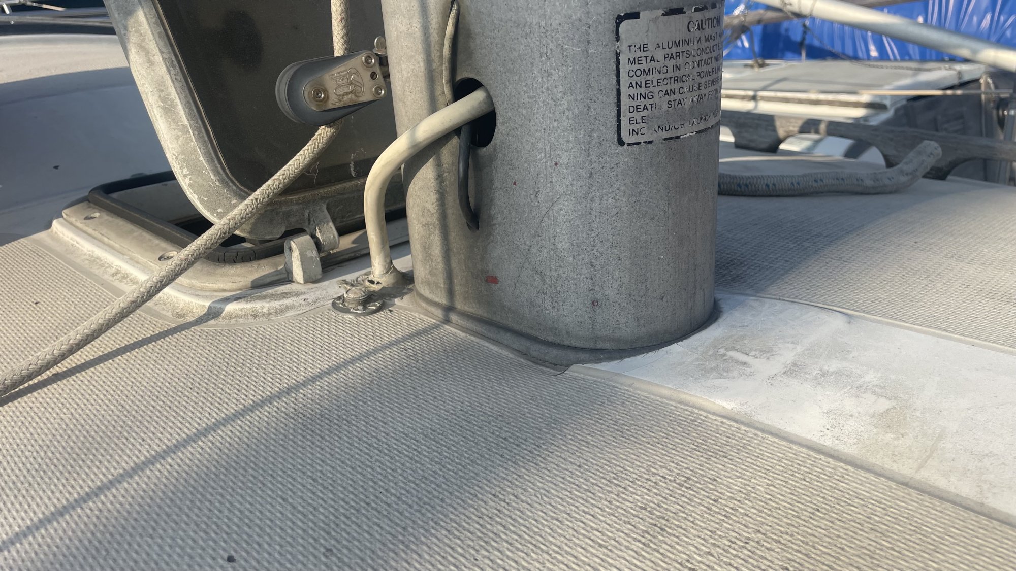

The mast step looks a little compressed at the deck step. Thats about half an inch you see in the pics The compression post looks ok inside where visible. I’d this a problem. Could use some advice before I take on this project. The rest of the restoration I should be ok to handle..

The smile may or may not be a problem. The main issue of concern is whether the plywood in the keel stub has gotten wet and rotted or not. The first check is to see if the washers under the keel bolts are flat or cupped. If they are cupped, the plywood is most likely swelling and will need to be removed and replaced.

Catalina stopped putting plywood in the keel shoe during the 1988 production year so it's possible this boat doesn't have it. Often when the plywood gets soaked, you will see brown stains on the keel, which I'm not seeing. That looks like a typical Catalina smile, which can be ground out and filled (3M 5200 is a good choice) - after re-torquing the keel bolts first. Concerning the mast, Catalina used a wood block (oak) at the base to support it - most likely this has rotted, there's lots of info out there on how to replace it.

I'd be more concerned about the mast compression. From what I think I know based on posts here, the cabin compression post may be sitting on rotten wood. If that's true, it will continue to compress, deck may crack, standing rigging will slacken. All can be fixed. Consider the cost in the price.

The boat he is looking at is an 83 Mk1 so it definitely has plywood in the stub. My 88 still has the plywood and I make sure that the glass on top is always sealed and it has never been a problem. Most often, the brown water drainging out of the smile is the final symptom of major rotting and the plywood can be wet and rotting long before that sign shows up. The water intrution is usually from the inside of the bilge and not from seawater. It is caused by improperly sealed penetrations to mount bilge pumps and other stuff to the bottom of the stub.
It is always a good idea to check both the plywood fill in the bottom of the stub and the compression block. FYI, not all compression blocks are made from oak. I know of two boats that the compression block was made from plywood also. One had it made from a horizontal stack of plywood and the other had a vertical stack of plywood.

These are two seperate issues. The keel stub affects the keel attachment and will make the smile much worse. The compression block affects the mast and will also cause interior problems with the bulkheads and doors as well as cracking the head liner. Many boaters choose to do both at the same time if there is a problem with one.

If the smile is just due to flexing of the hull and not rotting of the plywood core, you are correct. Once the plywood core rots out, it becomes the much more important problems because it will cause instability of keel and increasingly sever leaking through the keel bolts which if left untreated could sink the boat.

I had an '89 C30 and tackled the mast support. The support is just behind the forward bilge wall. My mast was down at the time. Others here have pointed out that the deck rot could also be part of the issue. The mast support took one day to clean out and one day to rebuild. I have seen suggestions to replace the mast support with epoxy coated wood- I would NEVER do that. There are various steel jacking screw devices that have been used. These are certainly the most versatile because of the adjustment. I chose to build my step with Trex and long fiber polyester mix between the Trex boards. There has been some negative comments about this approach but I wanted a support that was non-water absorbing. The compressive strength is more than adequate. One of the tell-tale signs is observing the head door margins. If the mast support is degrading the margins will become smaller. If they all look good, then maybe do more investigation on the mast deck compression. This is a way bigger job. If the deck is an issue, you could consider working from the inside to avoid having to match the non-skid. The compression post is easily removed by jacking the cabin roof. Maybe a test drill hole from inside. I did have or tackle the "smile" but I did read about it and it involves digging the plywood out from the inside of the bilge and rebuilding. Try looking on one of the C30 group sites.
If you don't do the work yourself, the mast step is easily $2k by the yard. The deck issue is possibly a little more and the smile is more than that.

What I am curious about is the keel bolts were shinny, like they were stainless. Is that a concern where they embed into the cast metal of the keel? Could there be corrosion inside there causing the smile?

That is not a problem and the earlier boats had mild steel bolts which would rust away to almost nothing.

I agree with @Hayden Watson , you may not have a problem from what I see. You could just grind out the old filler and fill with G Flex epoxy and fair.
