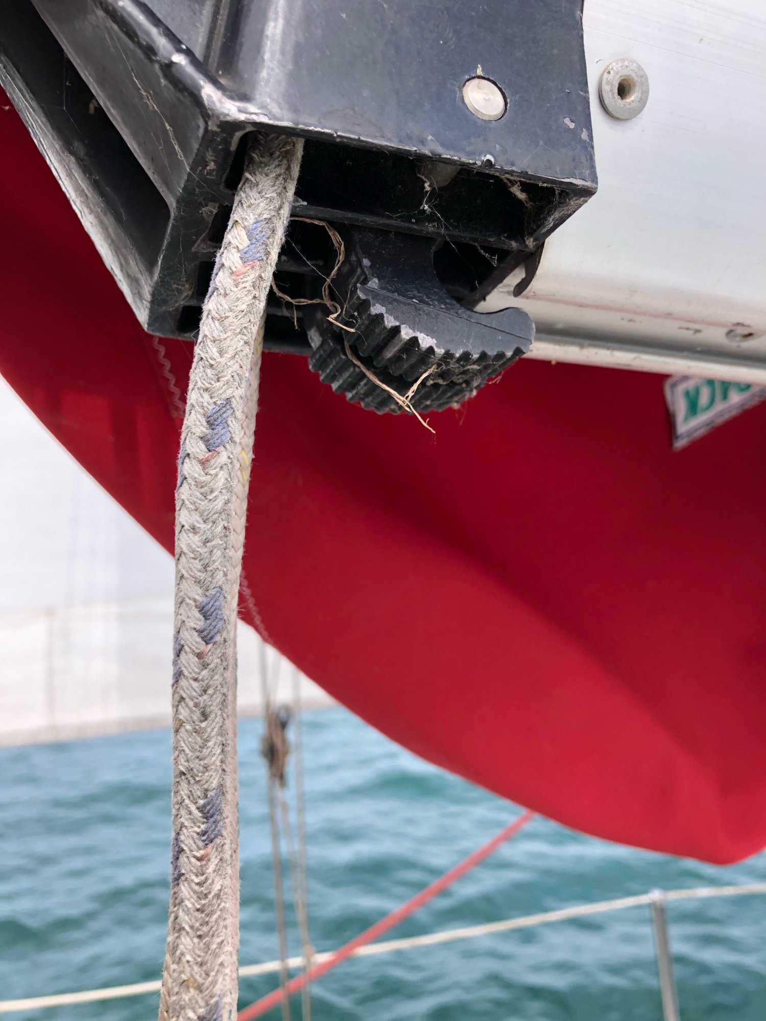

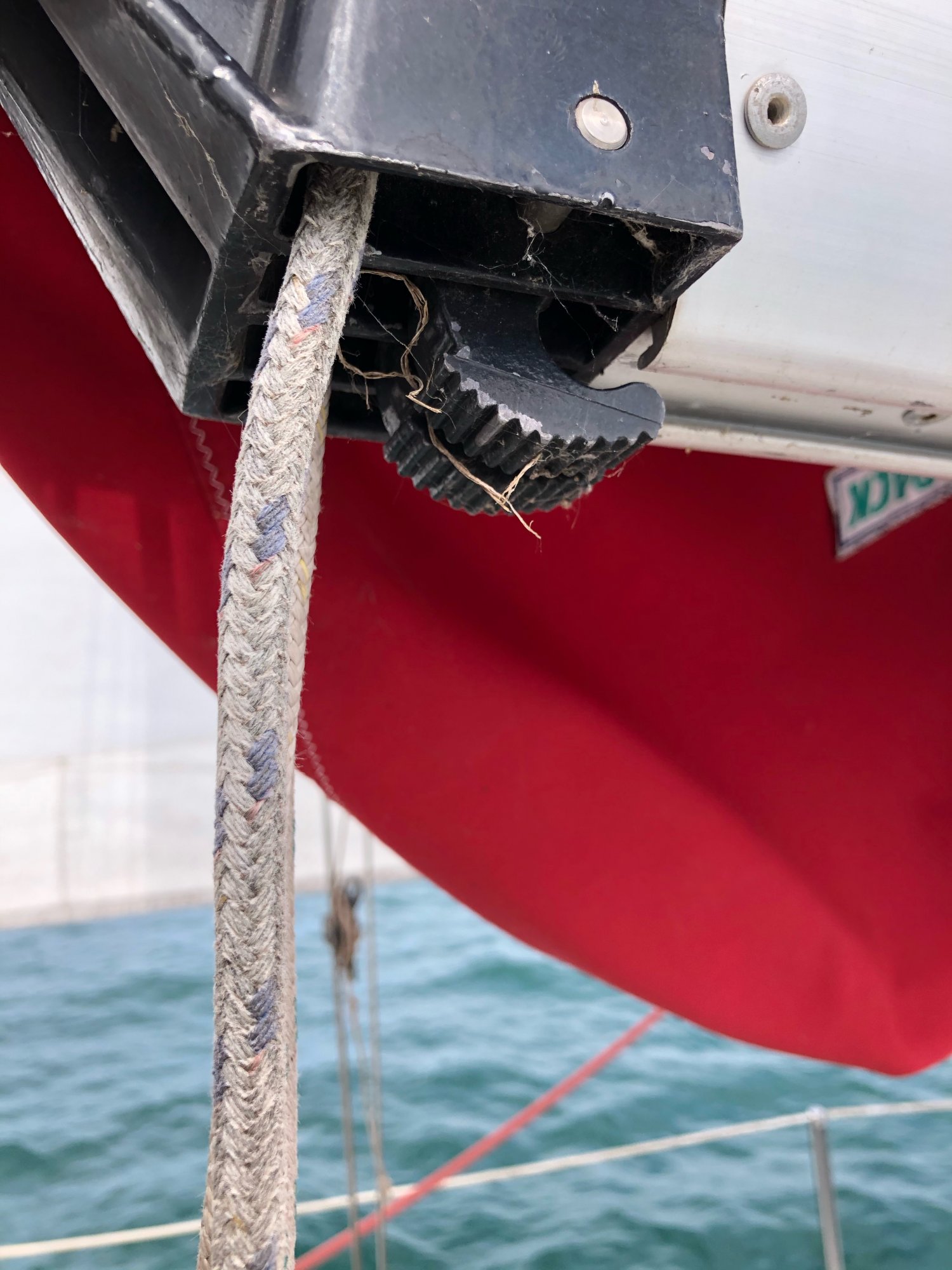

I'm back at this. My single line setup performed pretty poorly this weekend. Think I might give the dual line system a try and see if I can do better with that. One of the problems was that I was getting a good response at the clew, but having a hard time getting the luff pulled down.
Two things I'm trying to figure out:
1. For the the line to the luff reef point, should I attach it to an SS ring through the cringle? I have a bolt rope, so can't tie it around the cringle, if that's even an alternative.
2. The jam cleats and sheaves at the gooseneck really don't work very well, if at all. The clew line travels through the boom, and exits at the gooseneck. Could I remove the jam cleat and replace it with a cheek block and use that to guide the line to a block at the base of the mast and then back to the cockpit (via deck organizer, etc)? Is there something that would work better than a cheek block?

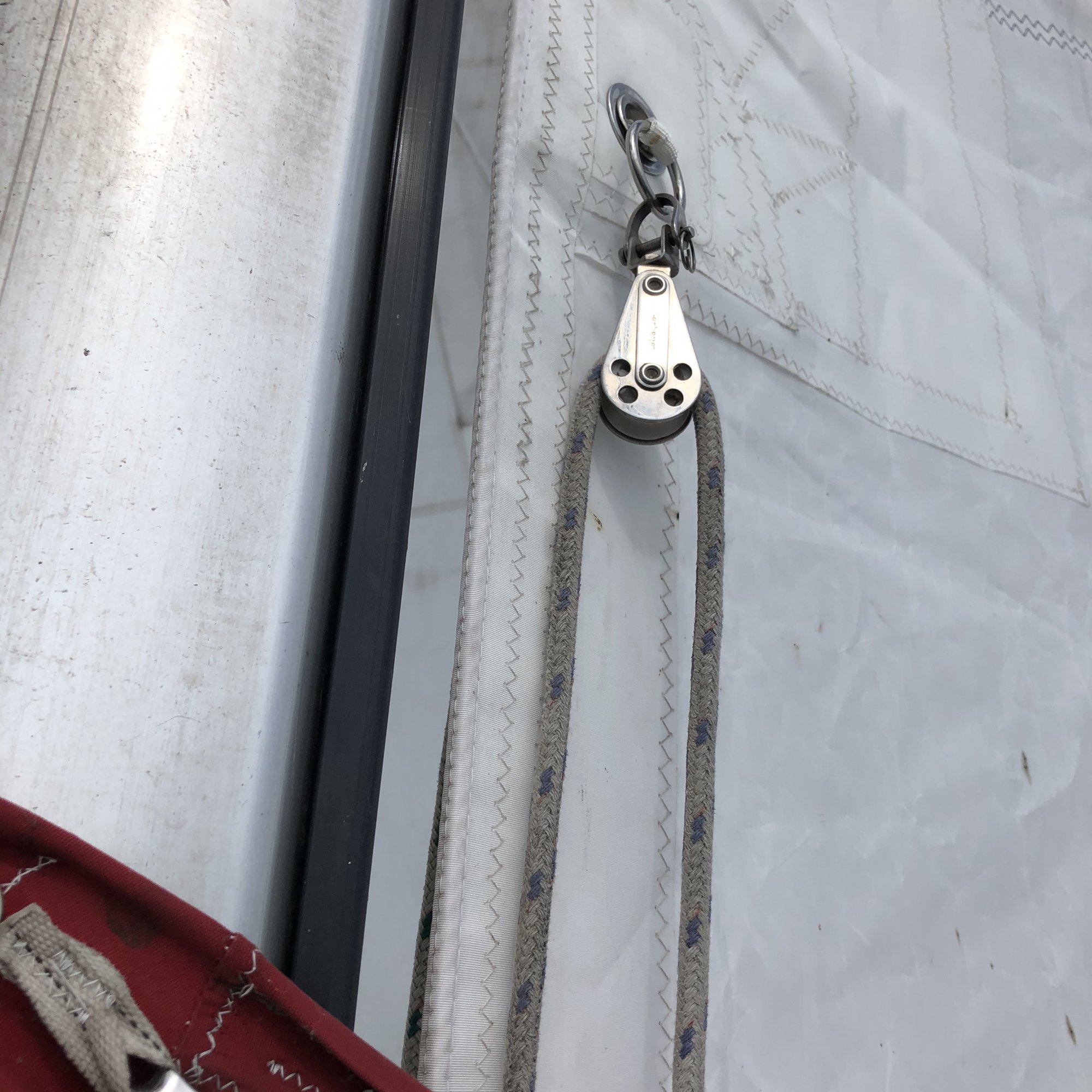

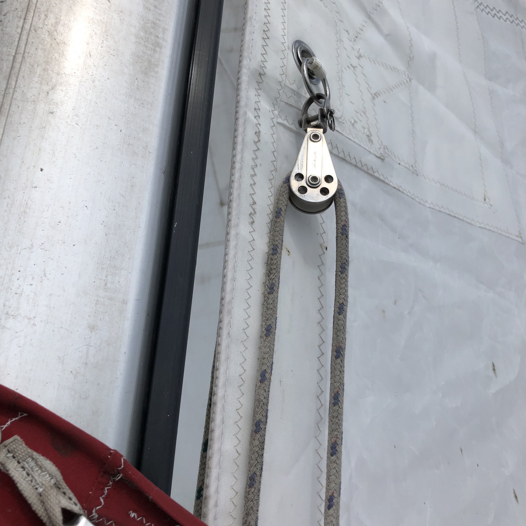

I had problems like you have...I did 2 things:

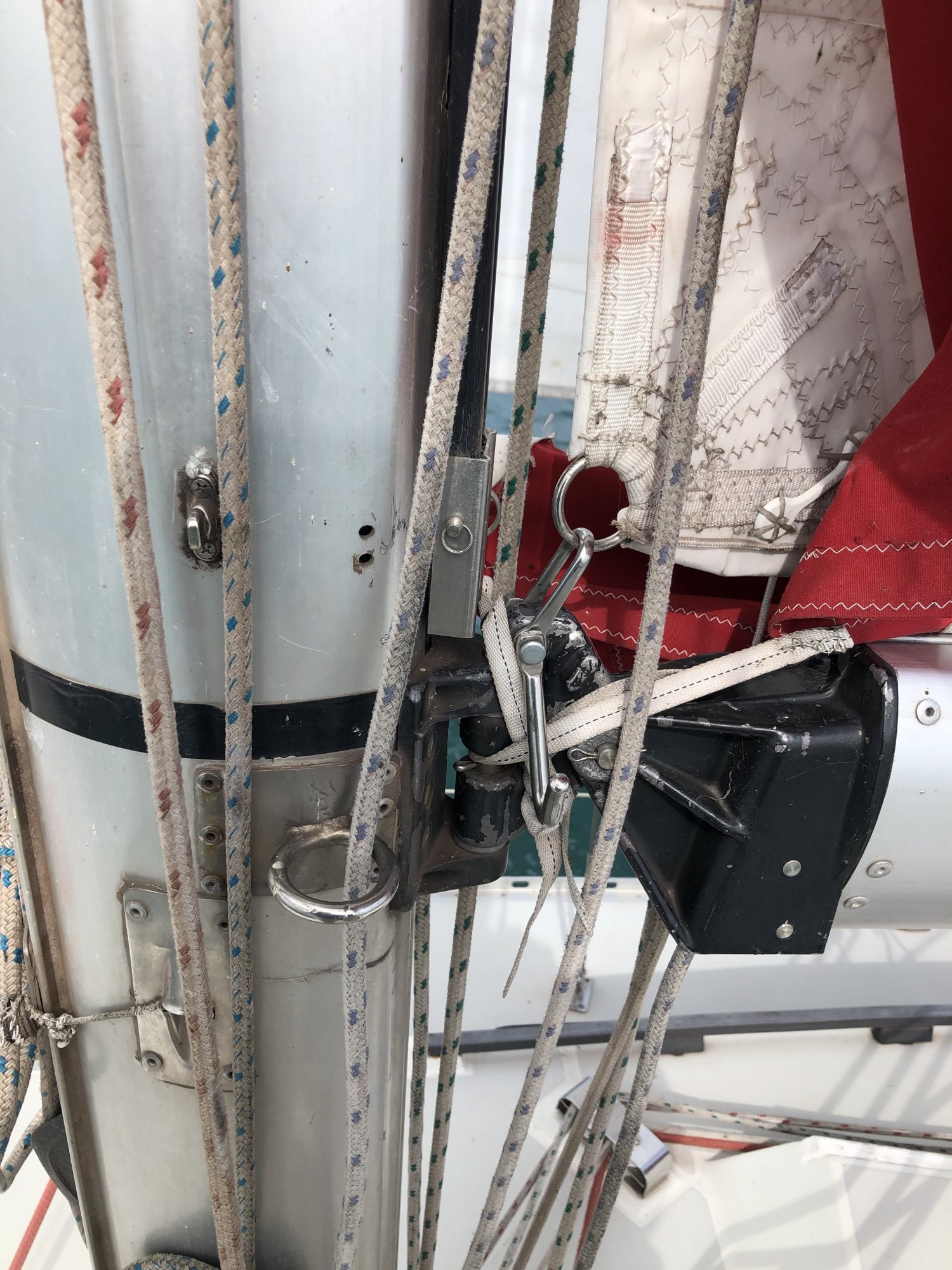

1) I mentioned this before, to clarify, I installed a reefing hook at the gooseneck, and when I wanted to reef, I lowered the sail so I hook the reefing crinkle on the hook. Then I tightened the main halyard to straighten and tighten the sail, the, I used the reef line to tighten the clew. This line only tightened the clew.
You ask about how to tie the reef line to the boom, with a bolt rope main...On my O’Day 322, my old sail had a bolt rope. I had a few attachment points under the boom, for attaching a preventer or such. I tied the reefing line end to that attachment point.
2) I later went through the rigging for the reef system and added some very small blocks to the tack reefing crinkles, and ran the single line reefing line through those blocks, then through the boom and to the clew crinkle and then tied to the boom. This removed a lot of friction out of the system, and I can now get good tension on the sail, both the tack and the clew with the single line, and I can do it from the cockpit.
here are a few photos of the mast-end...
You can see the reef hook in this photo(not in use) and hanging upside down at the gooseneck
in the boom, there are 4 sheaves...2 for the reefing, an out haul and something else.
I don’t really know what those jammers are supposed to do (nothing on my setup).
Lastly, here is the block on the crinkle at the tack...
