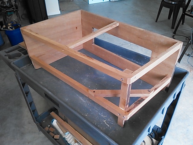

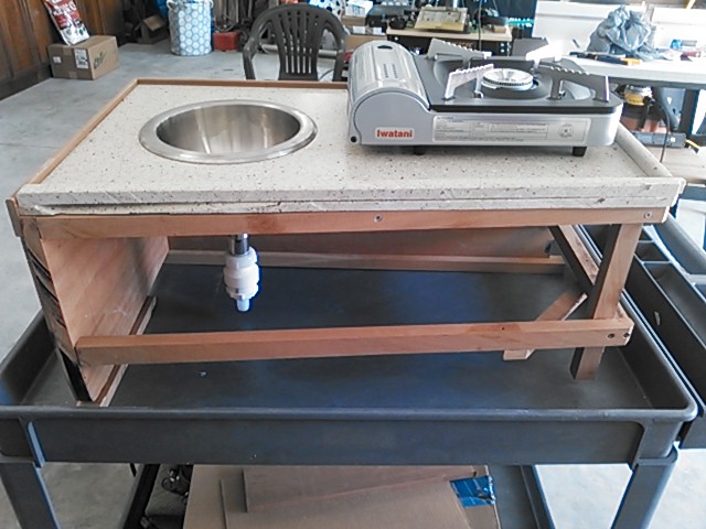

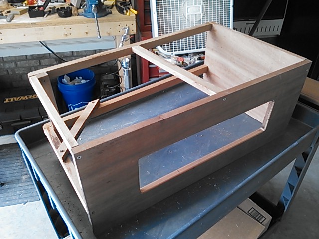

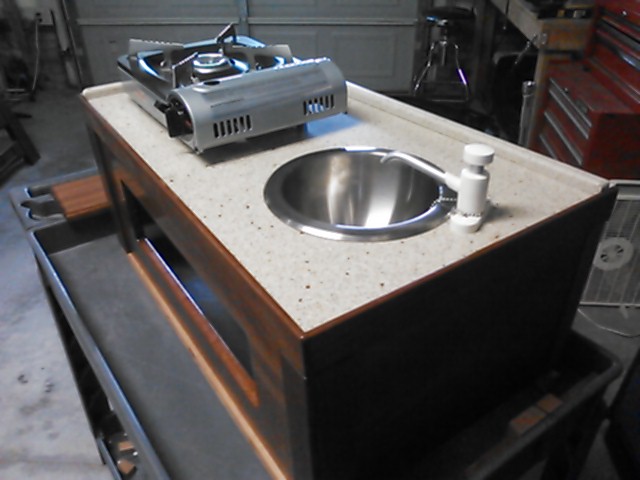

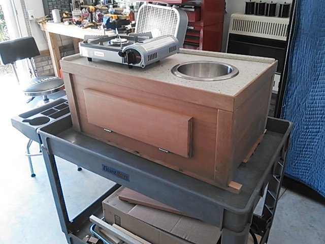

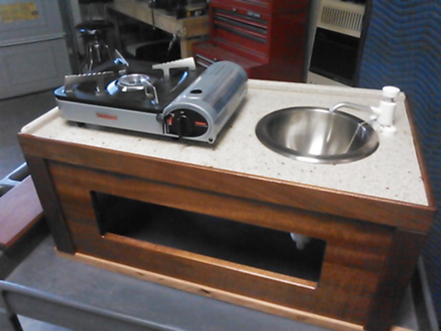

2 pc 4/4x6"x6' sapele, a pc of scrap sandstone corian....damn, not a square/plumb/level 90*angle in a boat!
Copied this concept from an old post which I thought was a good galley mod (if one must have one in a C22 '84)...fits like a glove against stbd bulkhead forward right @ the cushion break...stowage in tilt out drawer front for Gene's Iwatani grill and utensils in plastic containers, doubles as a working shelf...coupla more coats of varnish then install and on to more important stuff... Admiral is pleased...

Wow, nice woodworking there. Looks very professional.

thx mates....
LRail...wood throughout is Sapele (pronounced sa-pee-lee), including the skeleton frame, (similar in characteristics to mahogany, dense, nice grain, holds up well, have used it for custom exterior doors for many years in place of mahogany...way less expensive than teak or mahogany, likes varnish too.)

@rpludwig, what do you think of that Corian? Easy enough to work with? The Admiral wants new countertops in the Vega ... :doh:

Regarding Corian, fairly eze to work with, treat it like a hard-hard wood, cuts with normal woodworking tools, table saw, chop saw, router, files, sandpaper, etc., just be sure to start with fresh blades/bits, go slow and DON'T cut/leave any perfectly square inside cuts (as in a sink cutout)... be sure to leave a slight radius as square corners are subject to cracking the top over time (use a router). It's fairly heavy, but at 1/2" thick, not much heavier than a laminate/mdf top. Wear dust mask.
Go to a solid surface fabricator for the material, depending on what you need size wise, scraps, cutoffs, sink cutouts (typ 33x22), etc., are usually to be found on the cheap. You will find that most top shops are doing granite these days, so Corian (or similar solid surface products) have lost tremendous market share. As to use, don't put a scalding hot pot on it (use a hot pad), don't cut or chop directly on it as it will scratch (we use those cheap white nylon cutting boards), but then again scratches can be sanded out. Unlike granite it is not porous so it will not harbor food bacteria and red wine doesn't stain it (my fav property!)
Was in the business back in the day, so I am well familiar with it's use/pros/cons. I find it perfect for sailboat applications, no underlying mdf to absorb moisture.
Hope this helps some, sorry for the length of post!

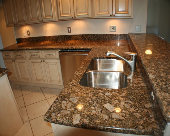

I cook like crazy, and love my granite tops. Just get a really busy pattern, that doesn't show dirt/stains. Below is very similar to my kitchen. I think granite might be too heavy for boat use.
