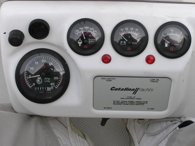

My meter is reading at 15volts, but when I put my digital meter on it, I get 14.5volts. I suspect there is an adjustment I could make to the meter if I open the engine control panel. Has anyone tried this?

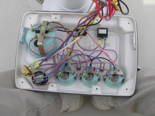

Did not see an adjustment screw in PaulJ's Picture
I'm not familiar with the type of voltmeter Catalina uses so it may not be possible to adjust it without a variable resistor in the circuit. It sounds like the meter's internal resistance has changed creating a higher apparent reading so replacing it should cure the problem. If you cannot do that but have some basic understanding of Ohm's Law, you can add a variable resistor of sufficient current rating to compensate.
Of course I did not see any labels either. I actually do understand Ohm's law E=I*R or a variation on that them. So I know E should be 14.5 volts, but finding I or R may take a little more research. Perhaps I can find the make and model in PaulJ's picture and RTFM.

In PaulJ's photo of the guts , there looks like some kind of red adjustment screw in the upper right corner of the guage ...............??
I will make it down to the boat this weekend to check, but I think the red is some type of cover. But my memory is a bit hszy as it was about 5 months ago I had the cover off and (are you all ready for this? Really ready?) PaulJ did not label that so I am not sure! :D
