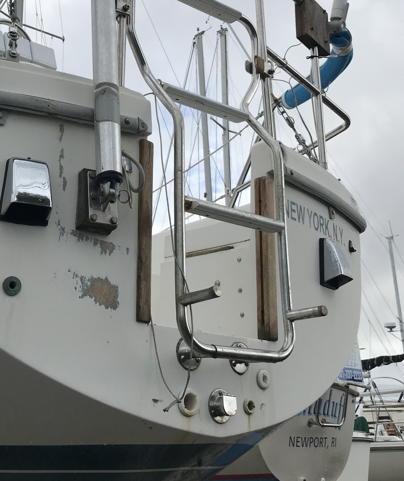

My 93 has a walk thru transom. While yours probably has the sugar scoop transom, IIRC, your "pass thru" is about the same as mine.
On both sides of the walk thru there are vertical boards, about 2 x 1 with a slot in them. The slot accommodates a piece of 3/16" plastic, probably ABS. It acts as a gate and can easily be lifted out. When installed there is a 2" or so gape at the bottom to allow any water that reaches the cockpit to drain out.
That eliminates the need for scuppers.
In the pic you can see the boards and slots. (Photo is pre purchase.)

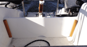

You don't want to seal it to the deck. You want the water to drain out under it. Yes, the floor will get damp sometimes, but not with enoug depth to be bothersome.
In this case I used treated cedar for the tracks and bonded them to the cockpit sides with polyurethane Sika 291. Enough gaps (corners and center) that the rain still keeps the cockpit clean.

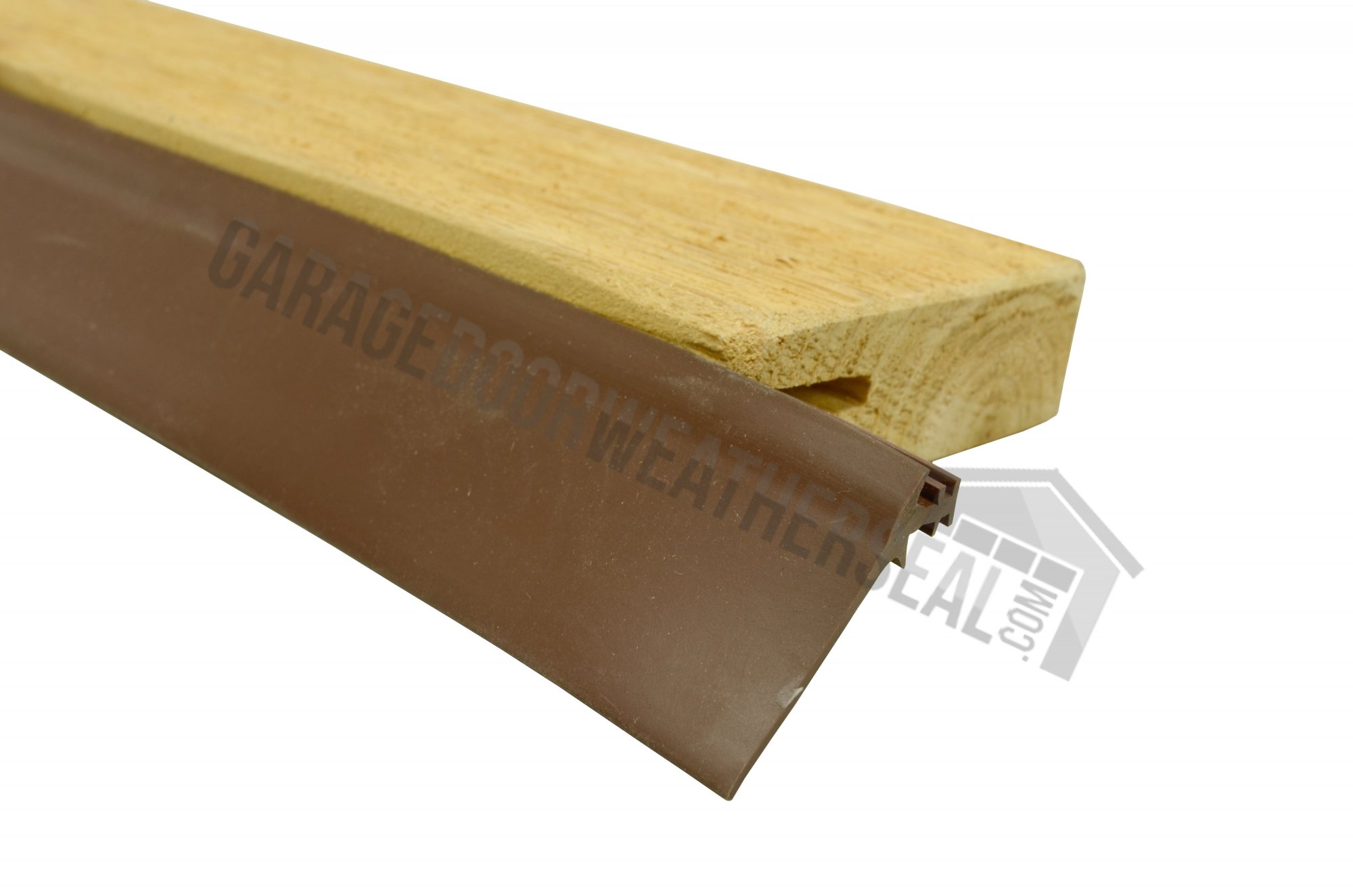

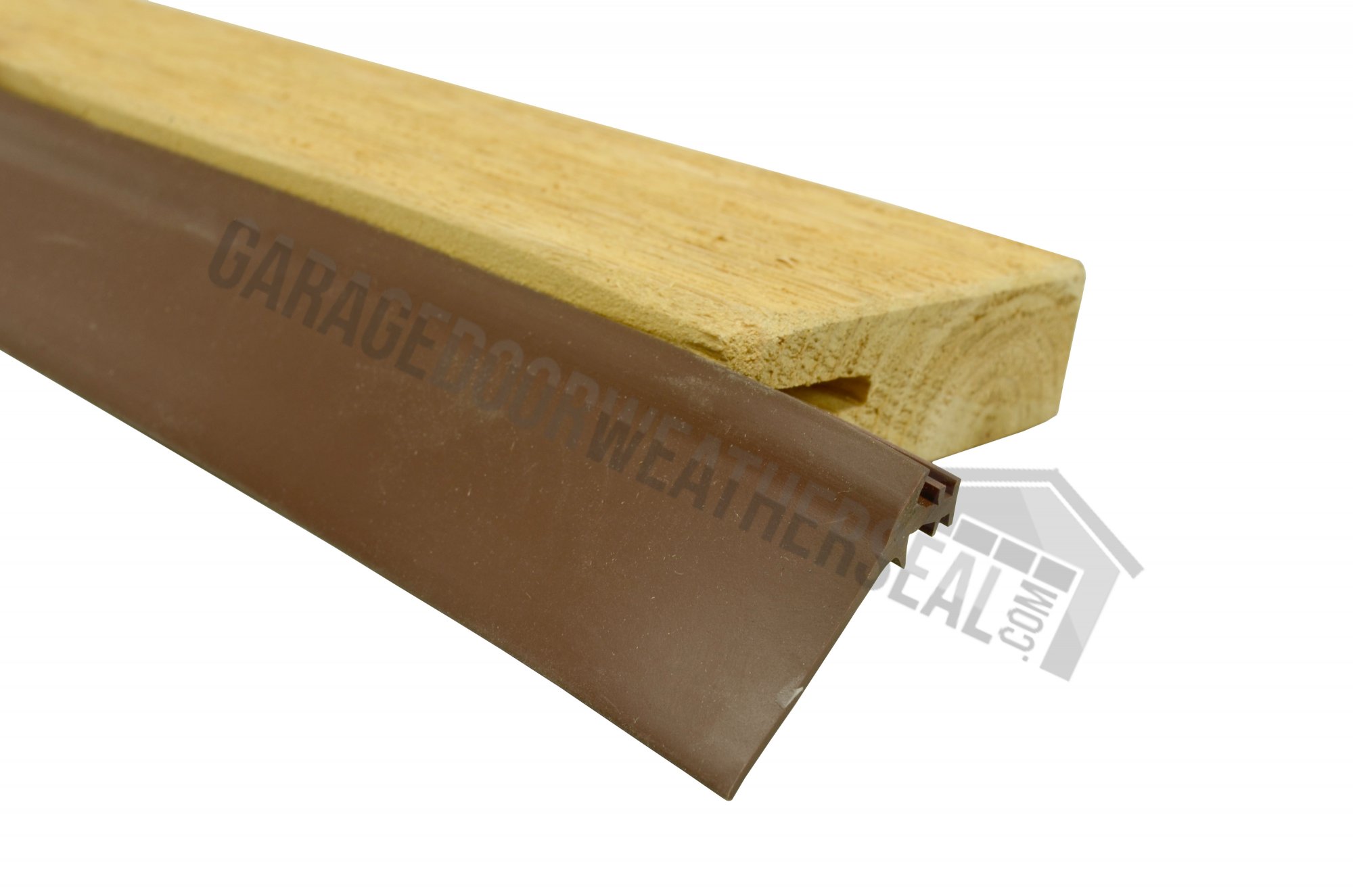

If the cockpit needed to be drained quickly, just lifting the board up would do it. That 1-2sec it takes won't matter. Cut a grab handle hole on the top.
Otherwise, get that garage door type of seal where it is a rubber flap. Put it on the outside bottom of the board and stop the board from fully seating 1/2", so the rubber flap acts like a one-way valve.
Something like this:
If the cockpit were reasonably full, the weight of the water will likely jam the board in the slot, just as you cannot lift a dagger board while sailing unless you point into the wind.
Puting the flap on the outside is good.
The flap is an excellent idea!
