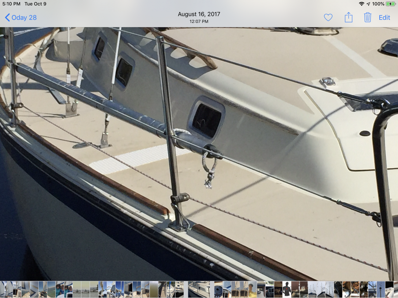

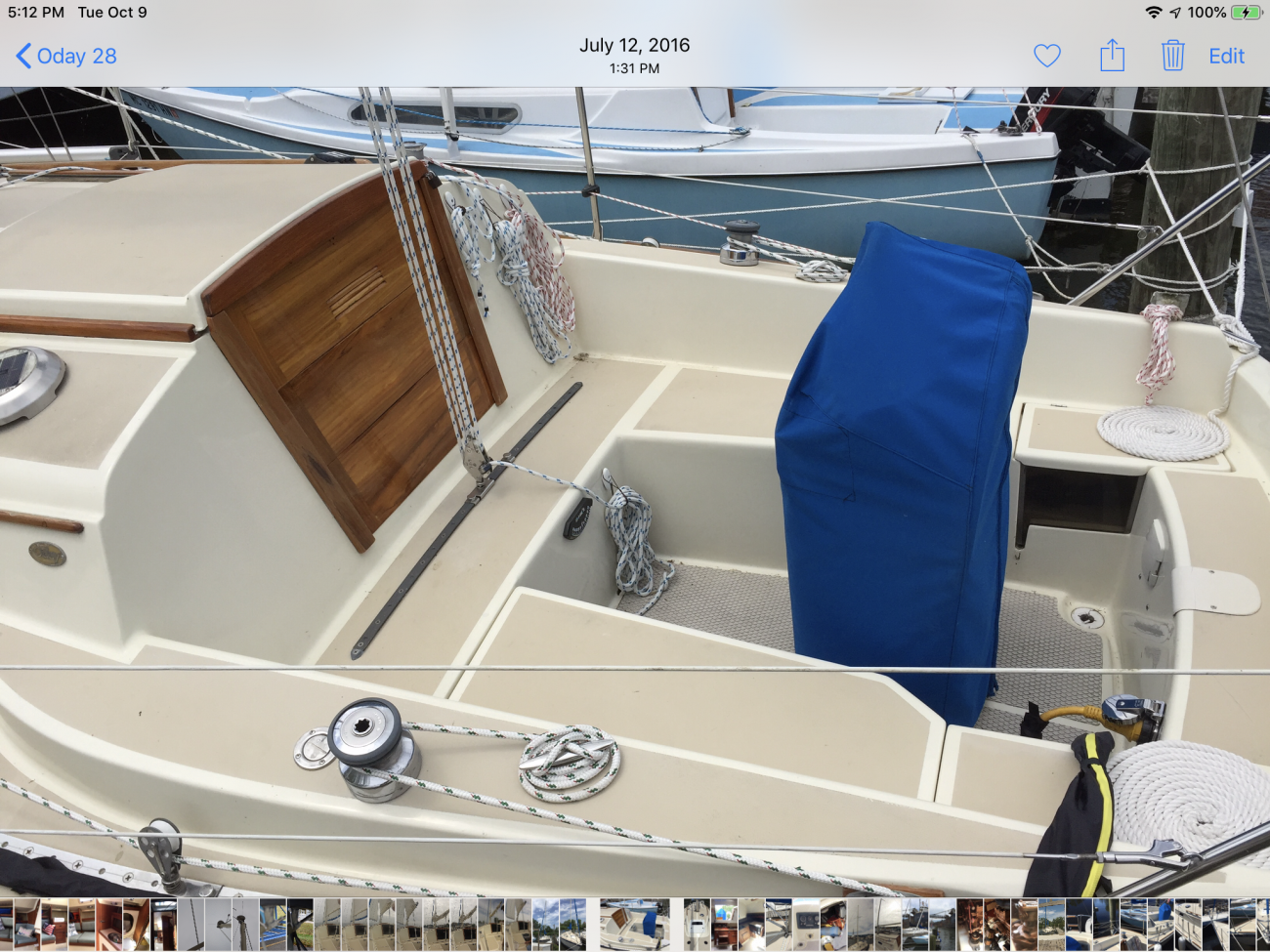

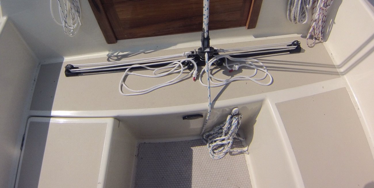

The cockpit of my 1981 O’Day 28 is covered in tread master. I’ve owned the boat for 5 years and don’t know how long the material has been there but it doesn’t stain and is very non-skid. I had two delamination spot repairs on the deck and put treadmaster step pads on them. Sticks well so I hope to never have to remove it. You can see it at Jamestown Distributors.
Lewmar Treadmaster Non-Skid Deck Covering
Hello Wing, do you have any pics of your treadmaster?

[QUOTE="wing15601, I’m in St Joseph, MI[/QUOTE]
A fellow Michigander!! I am not far away, I sailed outta South Haven this summer a few times. I am a trailer sailor. Thought about trying St Joseph, but didnt get there this summer.
Your boat looks nice....but your sheet and line management is immaculate. Wow.

No, that’s not paint. It’s original fiberglass nonskid. Those spots which were repaired just forward of the shrouds were delaminated in the fiberglass layup and not cracked but bubbled up. The core did not get wet and in fact when the bubbles (slight humps actually) were opened it was dry inside. You can’t slice it open and lift it up because it is so stiff so it just breaks. I sanded the edges, filled with epoxy and covered with the treadmaster.
