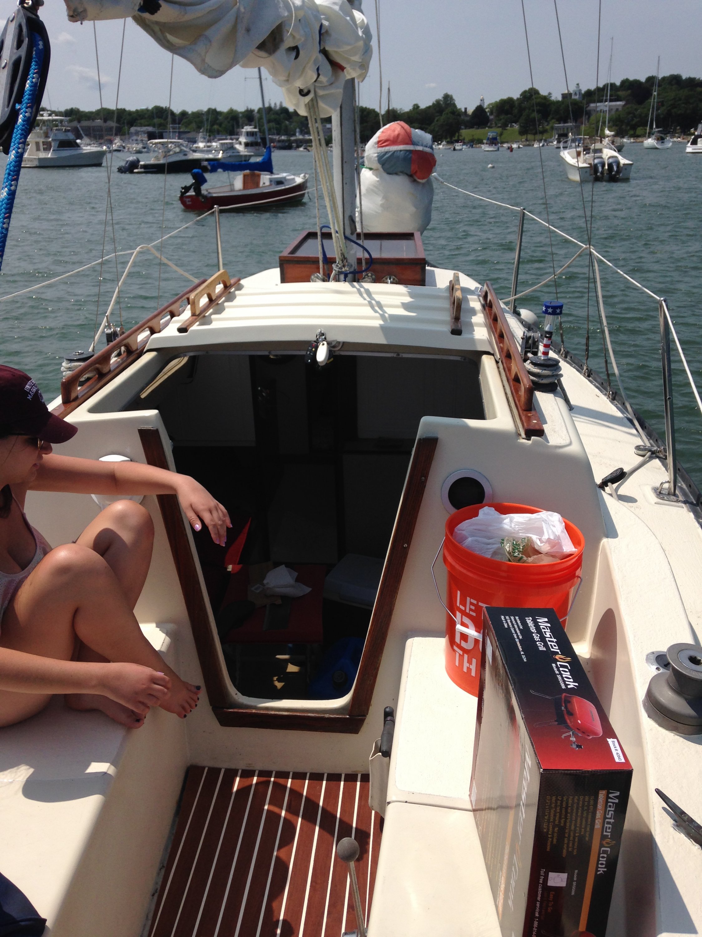

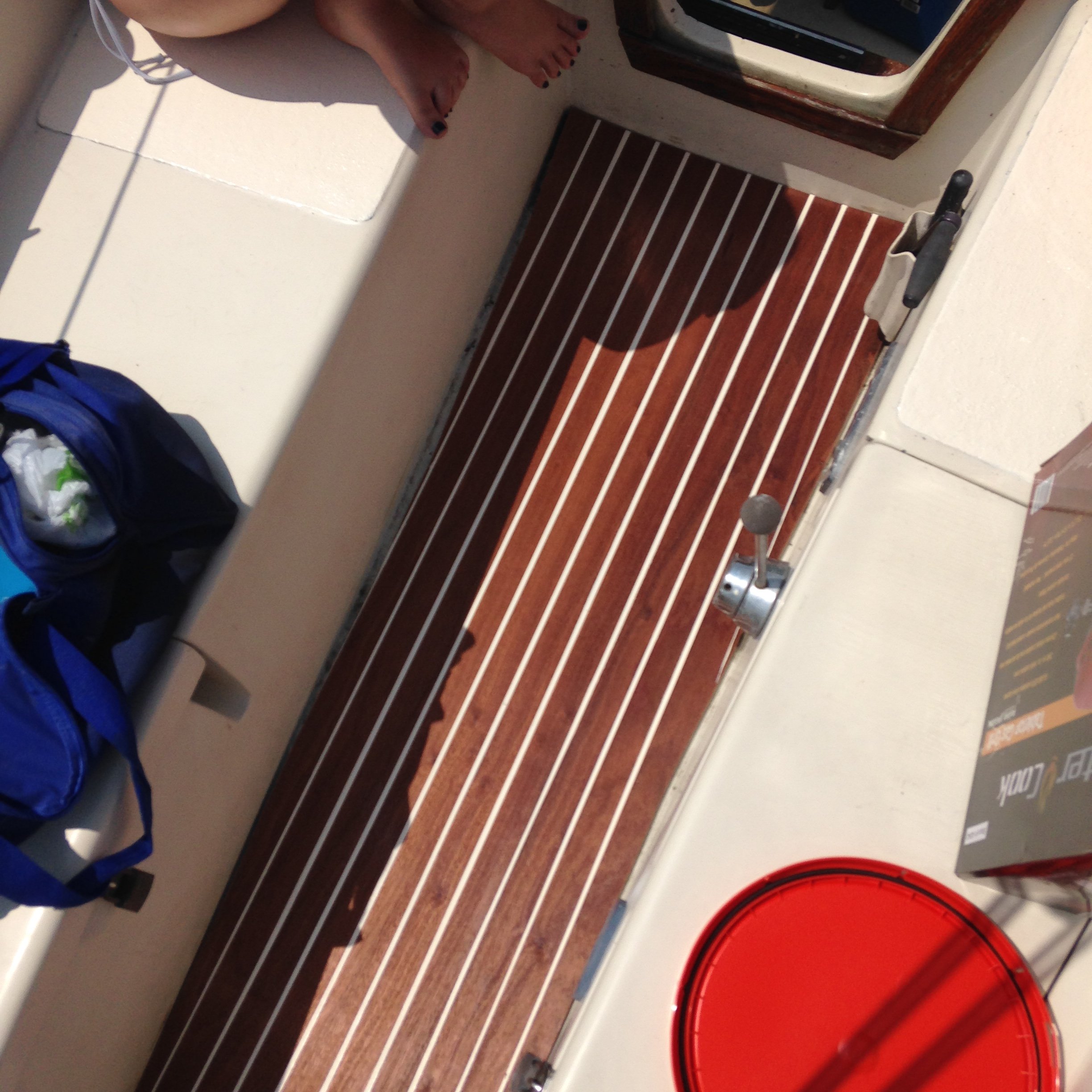

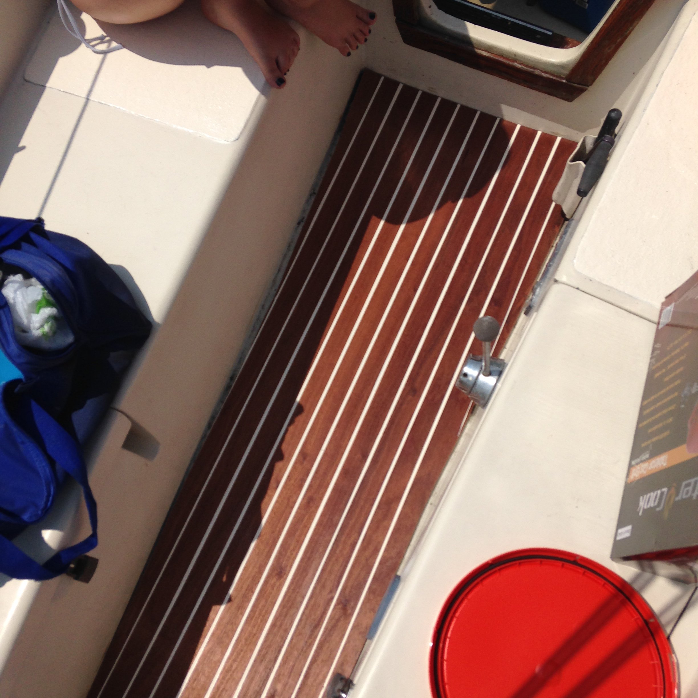

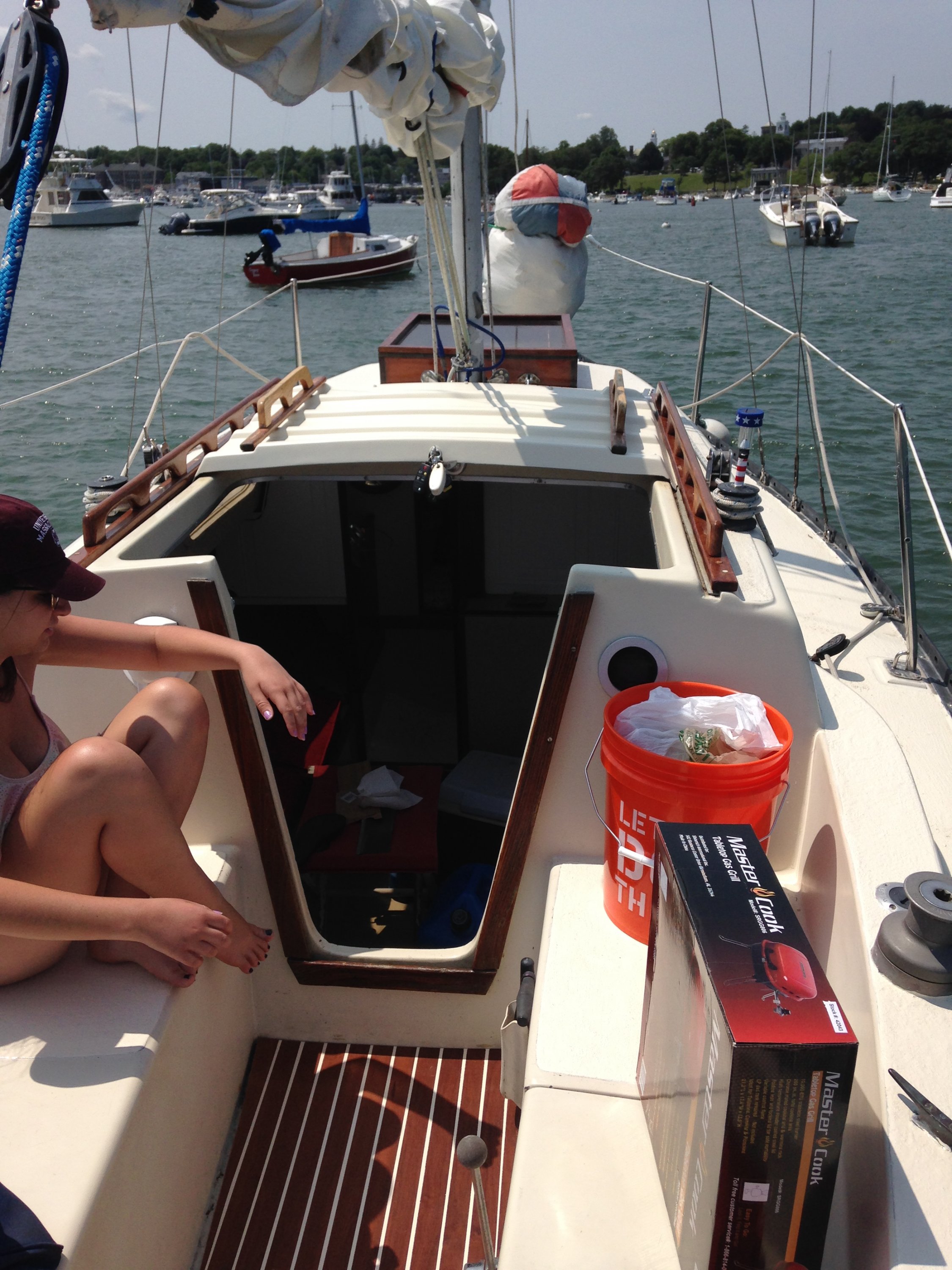

Your photos are great. Your foredeck hatch looks a lot like the one I have! Your throttle/shift is exactly where mine is too. I like the teak sole in the cockpit; but how is it bedded down? Having no pedestal I took the integrity of the cockpit sole for granted, till I sanded down all the old paint and found cracks. Sure enough, there was rot in the core. I filled this with epoxy and laid two layers of cloth on it; now it's much better. I also installed the cockpit drains I've been advising other people to do for years. This is one mod that's just about required.
Dec 11, 2015
319
Hunter 25 Plymouth
Hi David:
I pulled my Cherub out of basically a junk yard not knowing its maker or pedigree, URI Boat Rescue Scholarship program. It was in stable shape however it had been mistreated in the yard. It was April, someone had disconnected the cockpit drains to drain right into the hull and the boat had 6" of water in it mostly ice as the boat acted like a cooler to keep it cold! I had to remove all this first and then replace all the parts on it that vultures had picked off it. I had teak cabinet doors made in thailand for it, a tiller arm custom made in California (I found out later I could buy a Hunter 25 tiller right in West Marine). I replaced the missing companion way steps with mahogany steps from an old Christ Craft yacht. The hull-liner had semi-fallen off so I had to scrape all of it off and then replace it with in door/out door carpeting from HD. The hull had an open gash at the top of the bow so I filled it with Marine-tex and fiber glass. The keel had a gap between the hull and keel so filled it with 5200 and cranked it up to the best of my abilities, (I could hear my tendons separating from my hand). The rudder had some delam on it as my surveyor found a big thud on it so I took the cheap way out by drilling multiple holes in it, filling the holes with liquid fiberglass then completing them with Marinetex. Most of the deck was decent however at the mast step it was soft so did the same, filled it with liquid fiberglass and it hasn't given me any problem in ten years. The portside shelf had fallen down so I fiberglassed it back on the hull before replacing the hull-liner. Unfortunately, the inboard diesel has no compression and the marine mechanic who looked at it asked me to personally remove the motor and he would fix it for $3k so I decided add an outboard motor bracket on the stern (there was reinforcement there already however I added more. I created a faux teak and holly cockpit by using teak marine plywood and white paint, I also added white paneling to the cabin bulk head... more to go and more to come, lots of fun, great boat, I get a lot of looks now!
