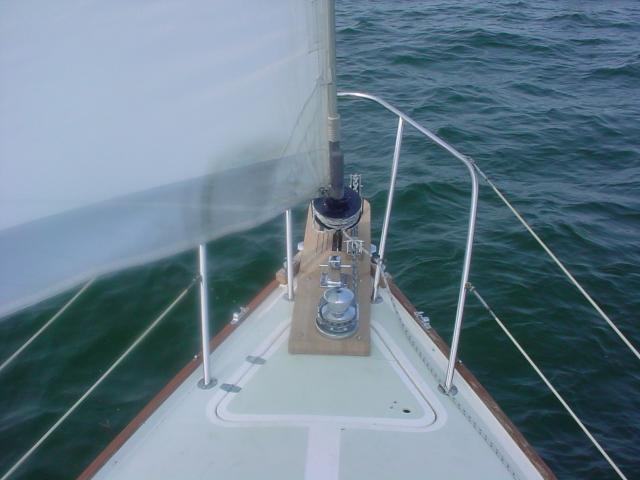

I installed a windlass on our O'Day 35. Drawings and comment/directions are to be found somewhere among all these forums. I posted it several years ago.

I installed a windlass on our O'Day 37. I have seen it installed in the same manner on a 32 CC. I posted photos and discussion on this forum some years ago. Should be possible to find it.

Here's a picture of the 32 that Peter is talking about with a windlass and a bow sprit, note the cut anchor locker hatch and a pic of the boat before the installation.
The 3rd picture is a picture that I believe I found in the archives of this site and its a pretty close to the way my whole setup is
