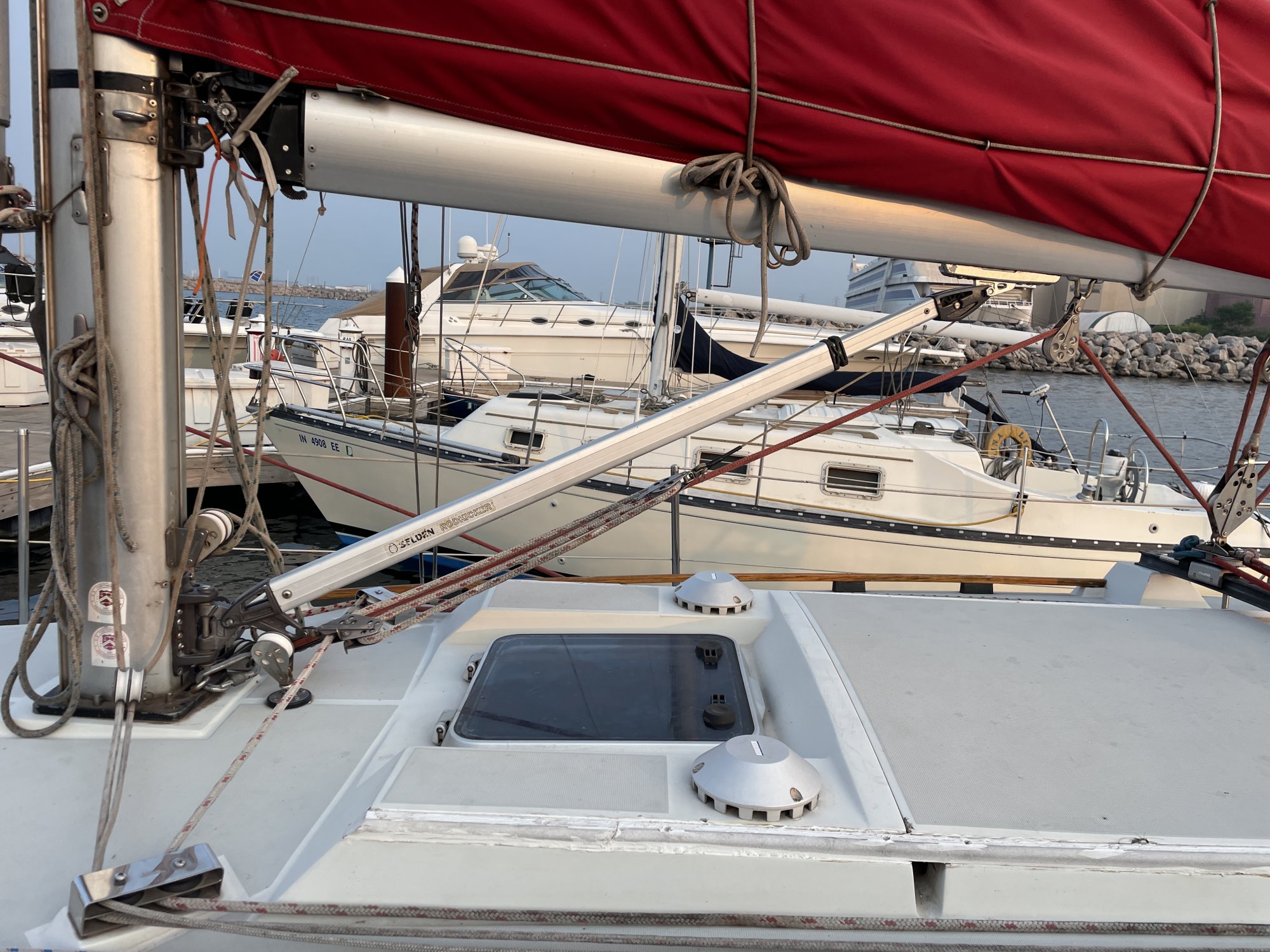

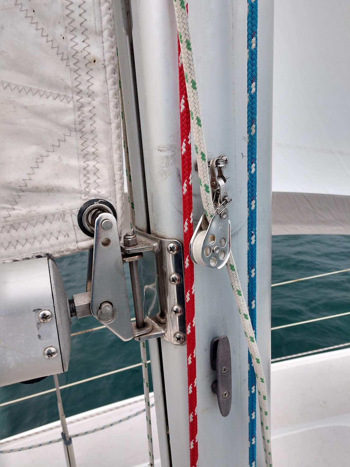

My original sails that came with the boat only had a single reef point. I've out grown that and need a second if not a third reef point. :) I can get materials at Sailrite to add rings with patches, but where specifically should I position them on the sail? Also, any tips on running a line through the boom to connect it all? Any pictures of how others have the lines for their reefing setup would be appreciated.
thanks!
Current setup in pics below...

I currently have a single line reefing set up, but I have done it several ways over past few years.

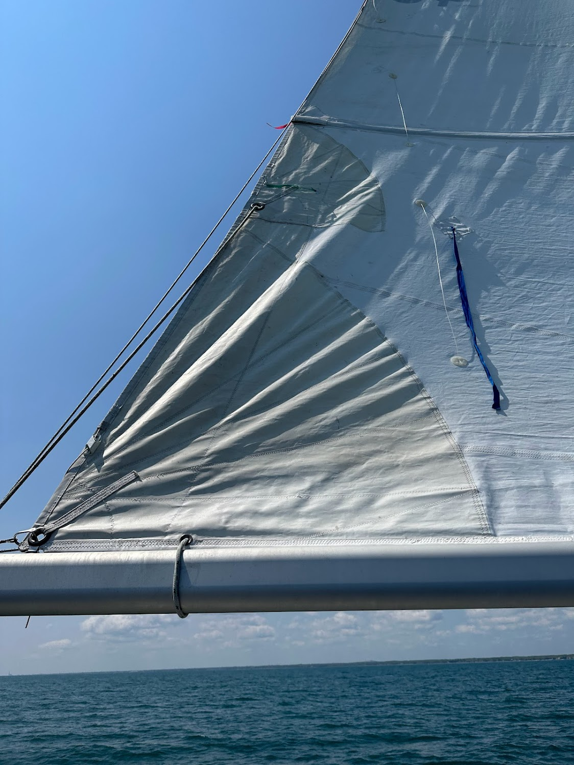

I have run a line through the boom, up through the reef crinkle and tied off at the boom on the clew end, and a reef hook at the gooseneck for the tack. That is pretty simple, and makes a nice reef, but it requires me go to the mast to set the reef hook (unless I am smart enough to do it before I leave the dock.
My current set up uses 2 small blocks on carabiners at the reef crinkles, and a single line reef set up…which takes the reef line from the cockpit, out to the mast, up to the tack reef block, down to the base of the mast, up to the boom, through the boom, up to the clew reef block, and then tied off at the boom…lost yet?

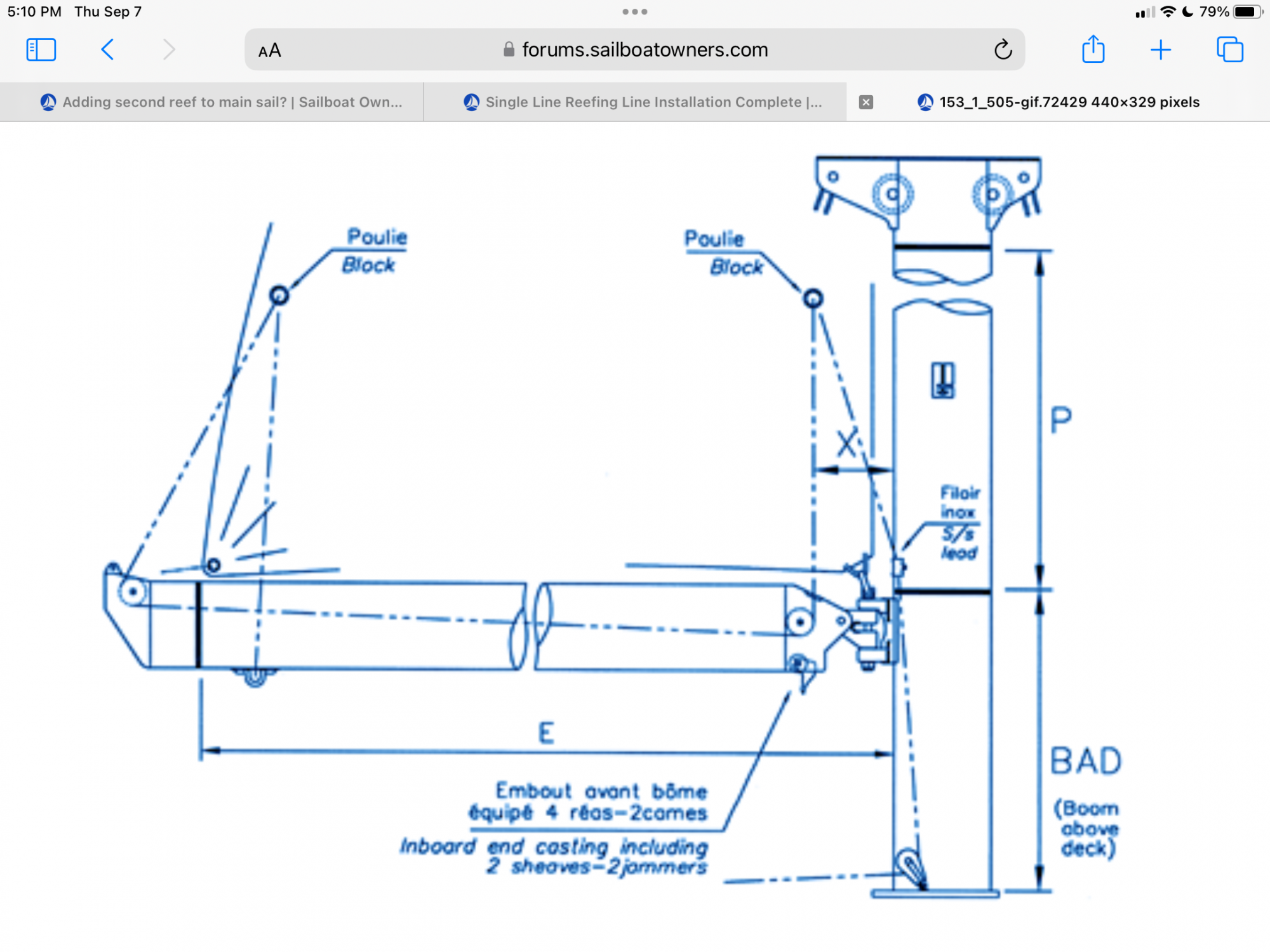

here is a diagram that closely resembles what I have now…

Correct. I've been venturing out into greater winds (20 to 30 kts) lately. I've found that in 20 to 25 kt winds on a beam reach, ~5 foot waves, with my only reef on the main set and full Geneoa deployed, the boat is not balanced / is over powered heel is 20 to 25 which is too much. The helm is very heavy, requiring constant handling to hold coarse and combat weather helm. The Raymarine Autopilot is mostly ineffective in this situation as well. So my understanding is I need to reduce the main sail area with an additional reef. I'll note I also run the traveler all the way to leeward in this situation. Other advice is welcome!

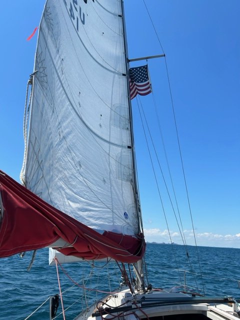

In your diagram above, what kind of block do you have mounted on the mast that guides your reefing line? Here's what I have going on (White-Green line is the reefing line) which does not run back to the cockpit. I never learn from the previous owner how managed it. We just tie it off to the cleat, but not sure the point of the block?

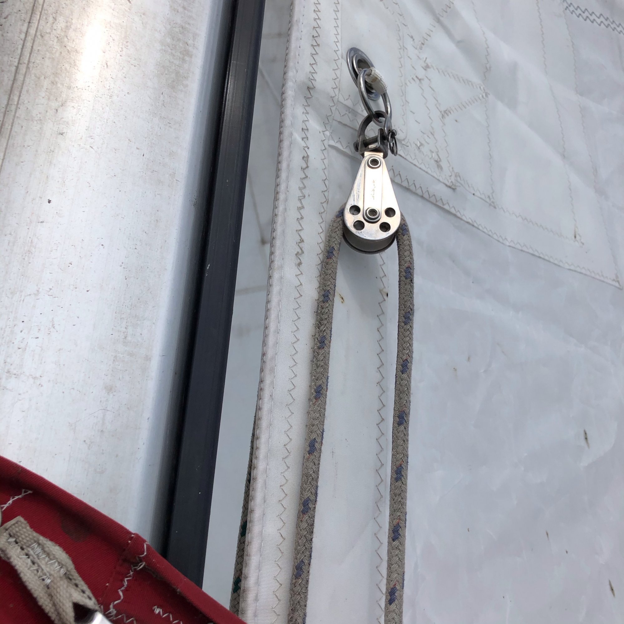

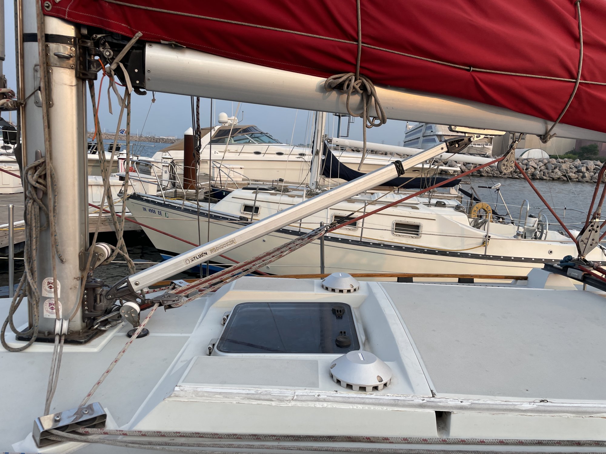

I can’t find a photo that clearly shows it, but I have a ring mounted on each side if the mast just below the boom height, and my reef line comes up from a turning block at the base of the mast, then through the rind, and up to the block at the reef crinkle…
You can see the ring in this shot, but it on the side of the mast that I don’t run a reef line through…

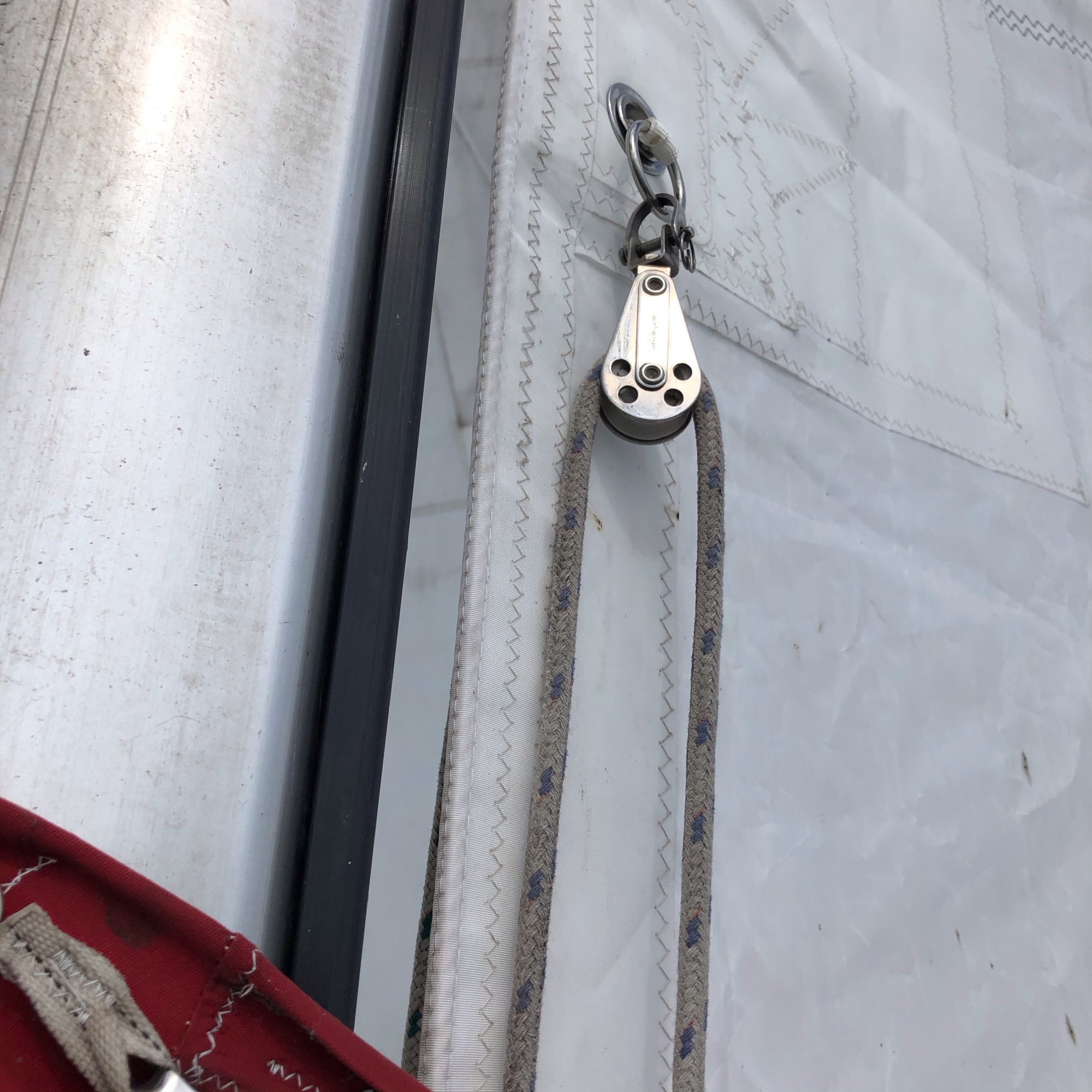

Here is what the block looks like (but this is my old sail…and I new use a locking carabiner to attach it to the sail).
The idea for the carabiner is that COULD move the reefing line to the second reef point if I wanted to…might be dicey doing it in weather, but easier that if the blocks were fixed on with clevis pins and those little ring retainers like shown in the photo.

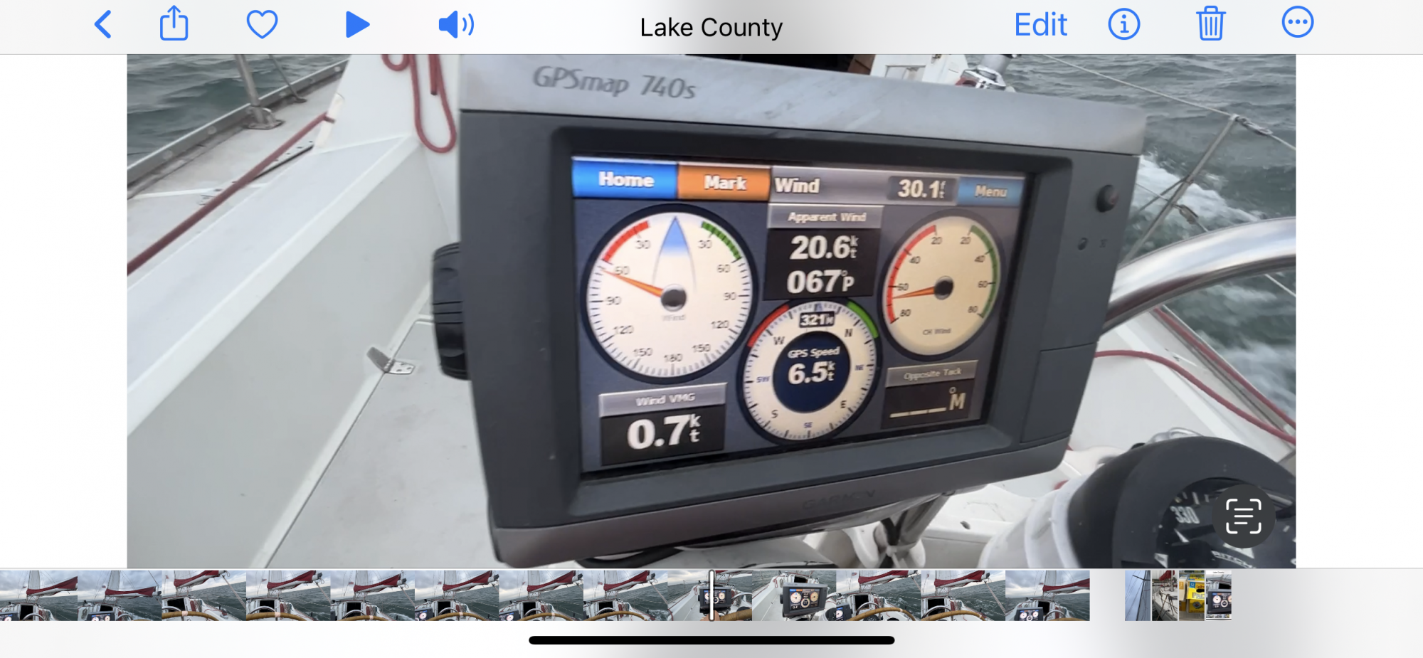

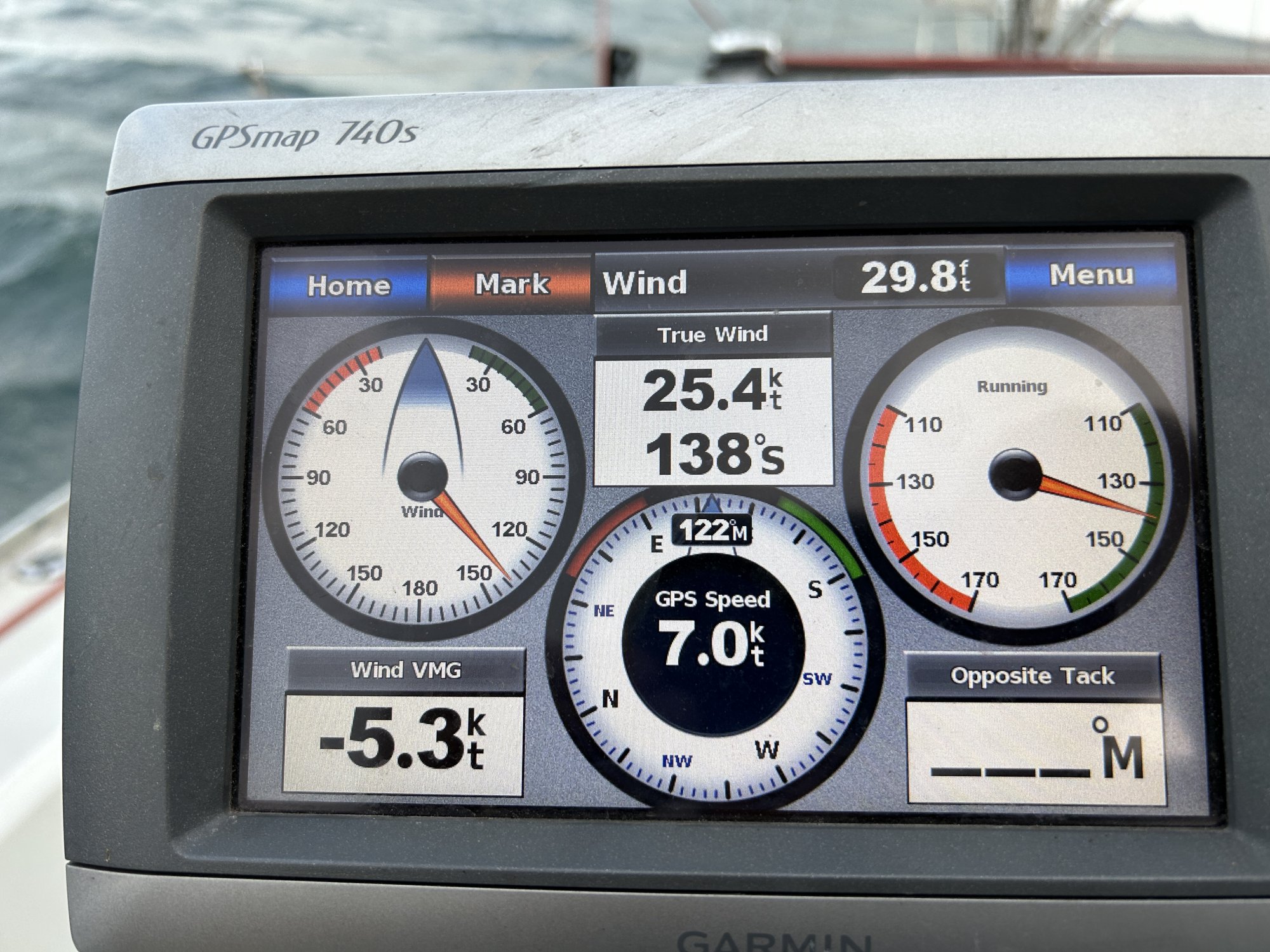

While controversial, I will often sail with just my jib in high wind conditions …for me, it is far easier to deal with just the jib (no going up to the mast to drop the sail into the Mack pack), and I can get hull speed in most cases with just a reefed jib (again, mine is a 135).

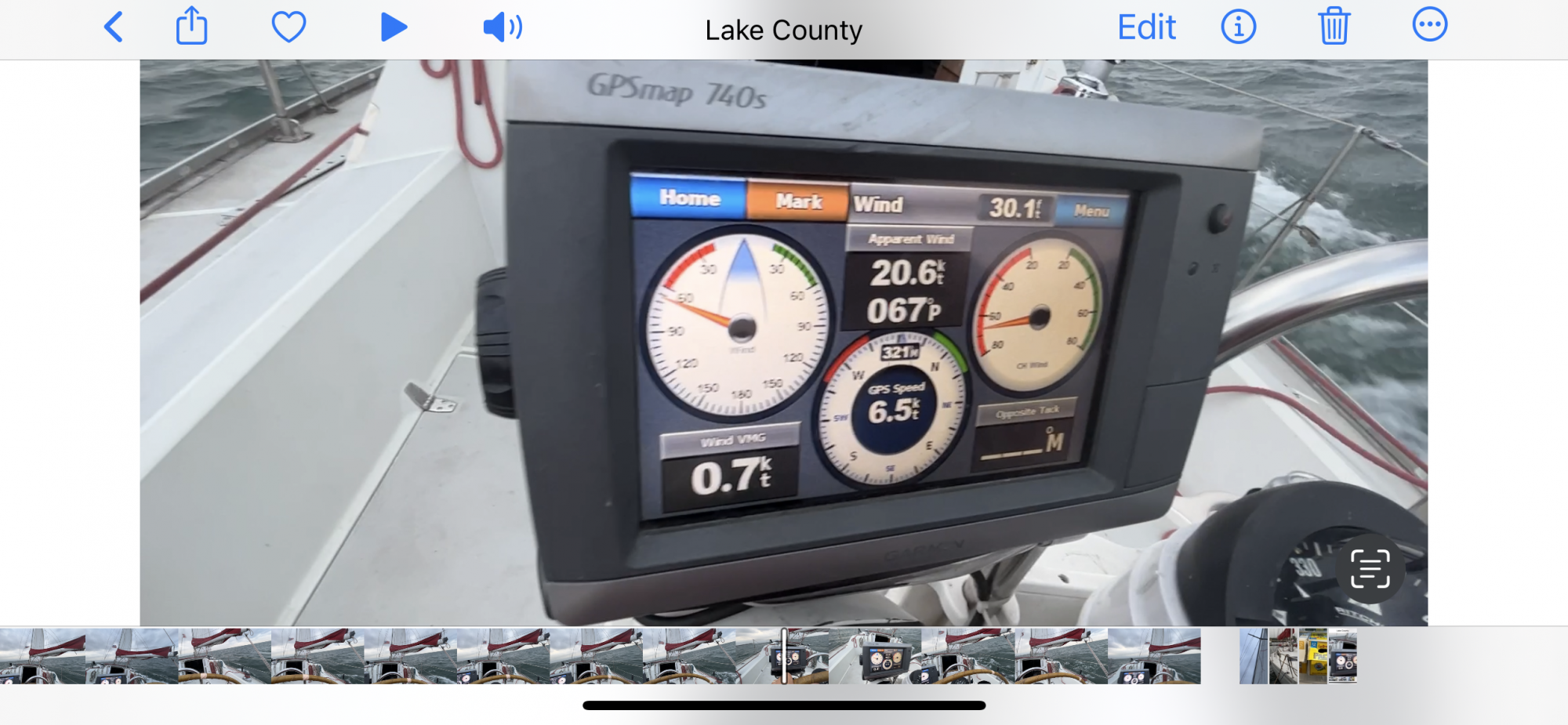

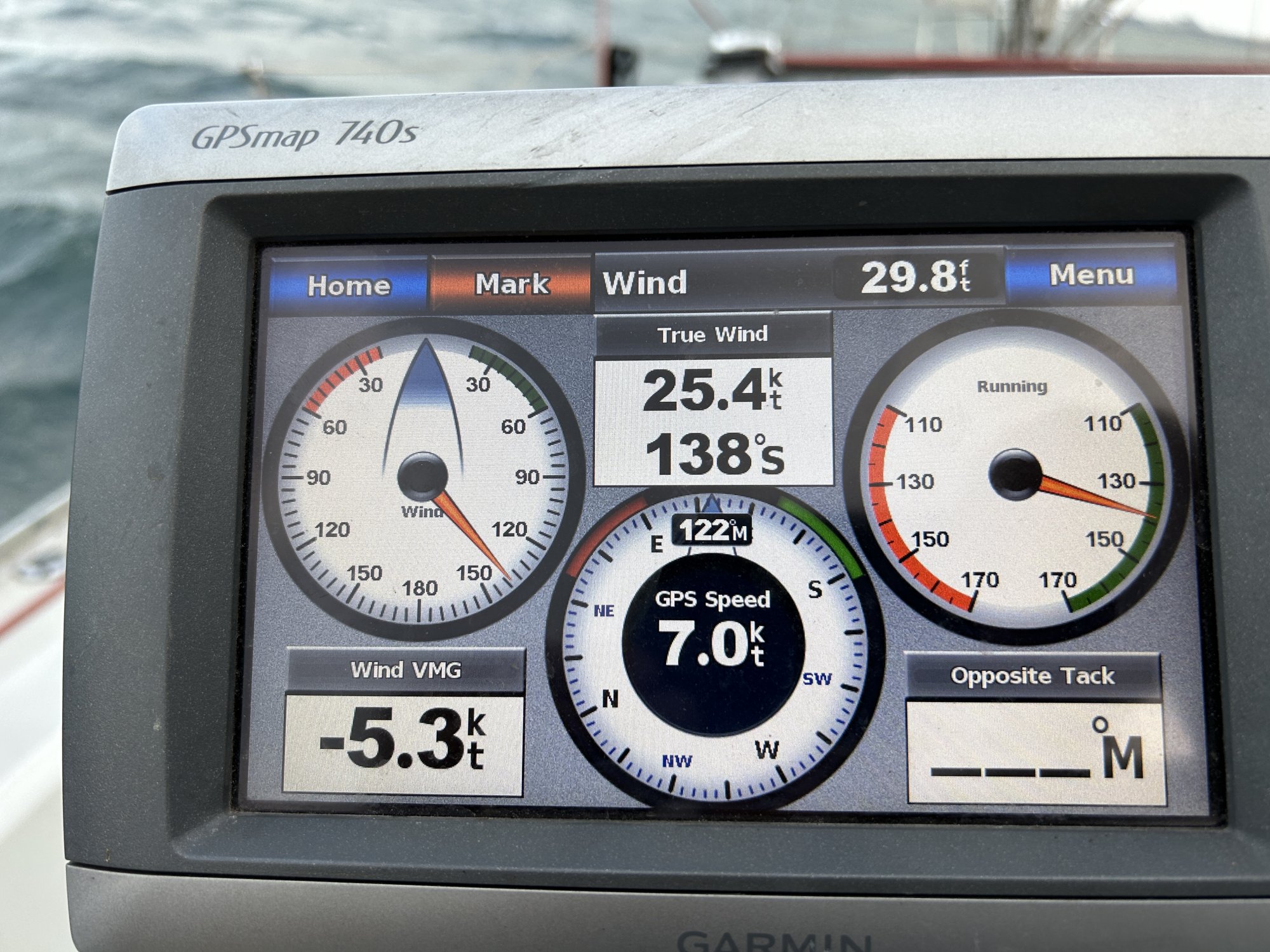

This was taken this past Wednesday night…I knew winds were going to be ripping, so I went jib only. I reefed it down as winds built up and I went from a down wind tack to a broad reach, and then a beat upwind. This was the downwind portion…
Here is an upwind leg…
Not quite hull speed (6.9 knots)…

Greg, I'm not really following what you're doing here, and why. Why all the hardware? Why not just pass the reefing line through the ring? That's what I do on mine, with two reef single line reefing.
Also, are you saying you only have one reef rigged at any one time?
Trying to cut down friction in the system. I don’t get an even tensioning when I just go through the rings…tack tightens too much and clew doesn’t tighten enough.
Trying to use the blocks to reduce friction. And I only have 1 set of blocks, so I used the ‘biners to attach the blocks, but want to try soft shackles instead…those locking carabiners are heavy!
I get a decently even tensioned reef with this set up.
