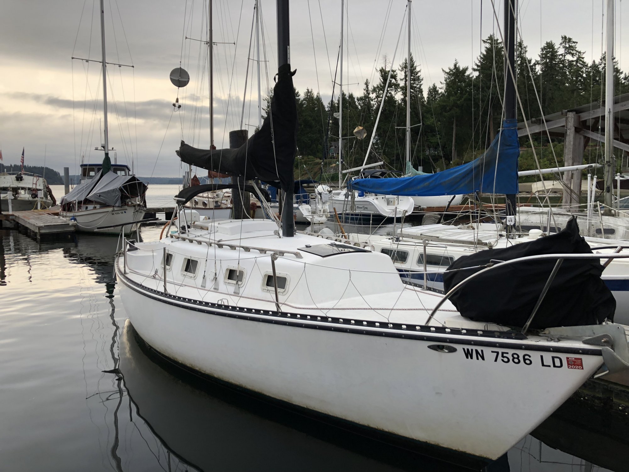

Hello all! I have to say I am quite impressed with the feedback i got on my last post. I want to thank you all for sharing your knowledge and insight and love the community here. My question is regarding add a roller furling headsail on my 27' Cascade pocket cruiser. Before I start researching this installation from square one does anyone have any advice or insight to point me in the right direction. Brands? Type? Average costs? Difficulty? Pros and cons, etc. I can see the obvious cons with having one as you are adding more moving parts and the potential for failure but being a solo sailor it would be nice to have the ease of use with a roller furling headsail. Thank you all! Appreciate the feedback. Cheers!
