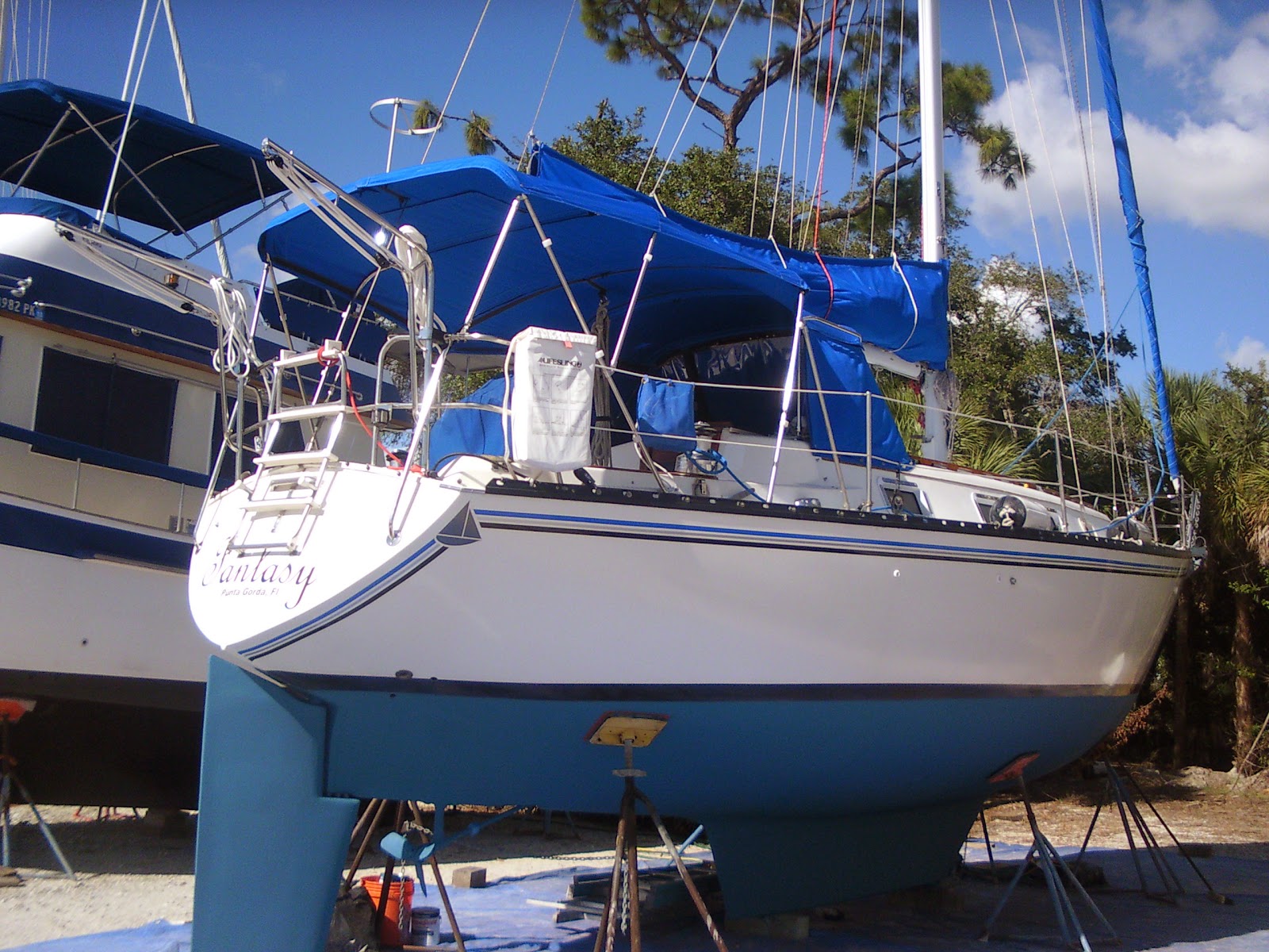

Thanks, I did start reading that and will continue to. Your boat....
...looks great. I love that little sailboat back at the stern. Here is a quote from Mary's blog...
Went to Port Charlotte Flea Market where there is a guy that does decals. He made us a boat name with hailing port plus two sailboat decals for the stern sides while we waited. Total cost $62, he emailed us a receipt from his Iphone. He was amazing and reasonable priced.

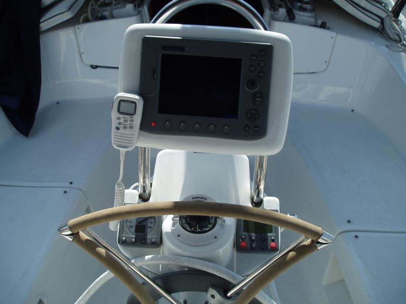

At Helmen

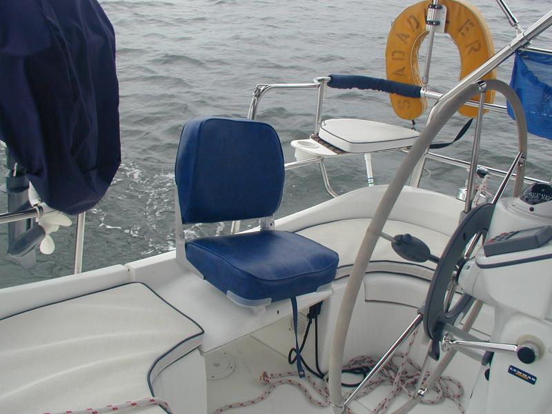

I love having my C-80 at the helmen and added a nice seat with a extension to raise the seat high to see over the chartplotter while day sailiing or longer trips cruising,with the chartplotter at the helman on my comfy seat I can stay at the wheel for hours of those cruising trips with all the info needed.
Nick
Photo's on my other notebook so with another post

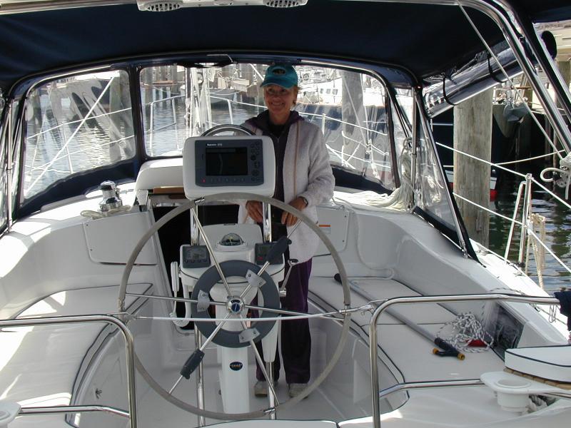

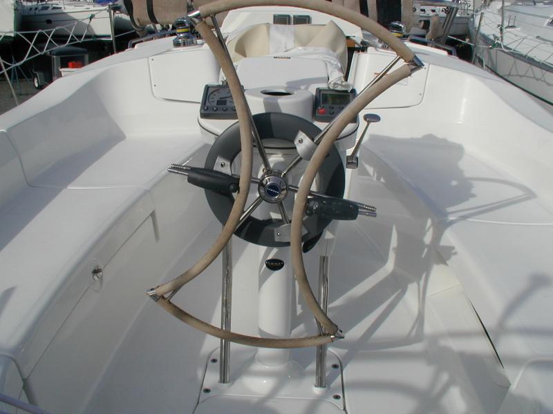

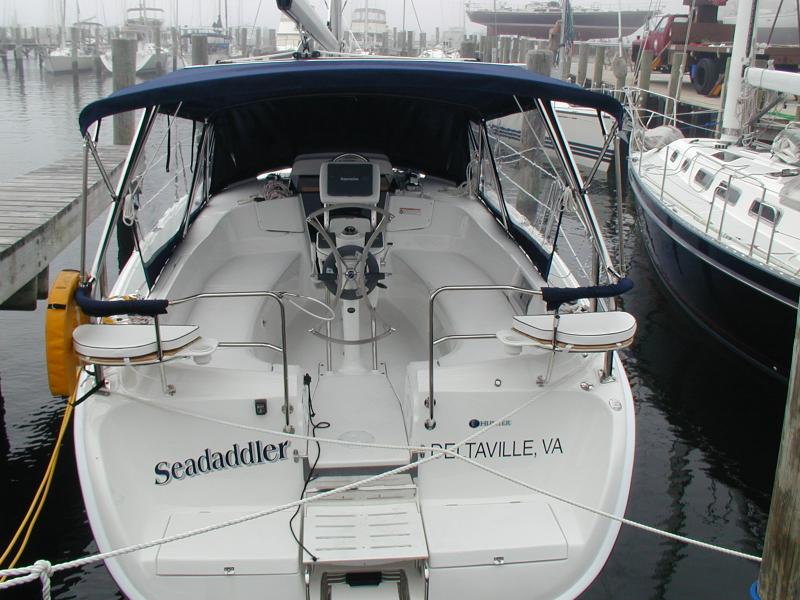

Chartplotter
Here is my setup at the wheel and maybe you can do something similiar with what ever unit you want to use,just some other idea's I have seen here on this forum and my old back and legs love my seat.

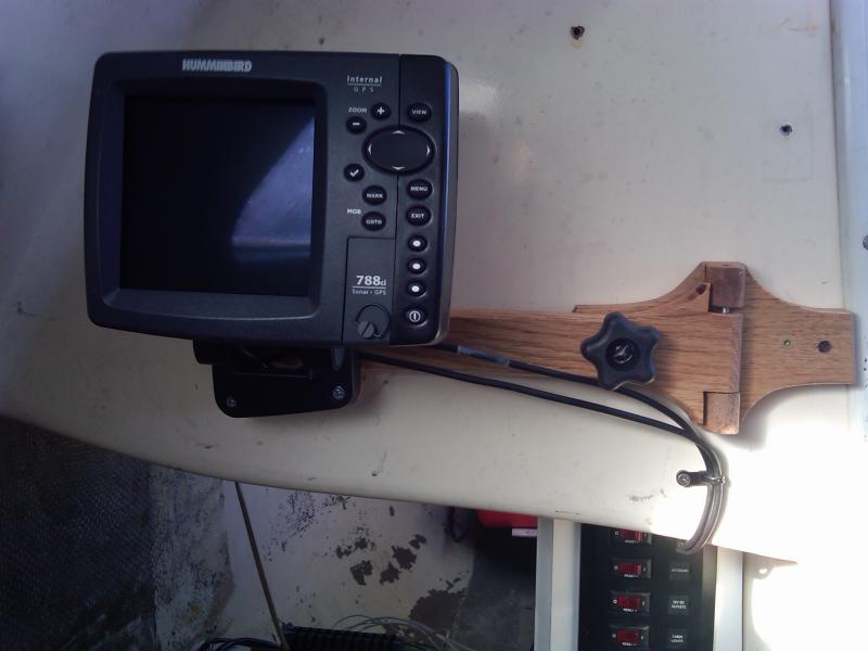

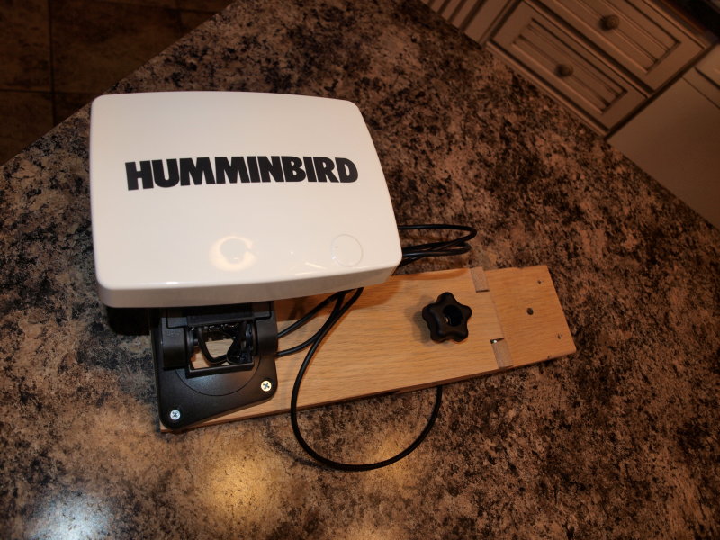

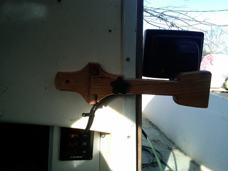

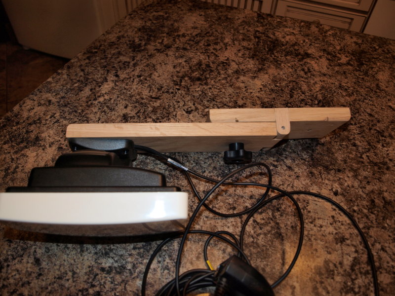

Here is my current attempt at a bracket. If I did this right it should fold inside the bulkhead wall and fold out and into the companionway. I added a knob to lock it in or out. My first attempt was in walnut, but drilling the hinge pin proved a little ugly. I have more red oak than walnut, so red oak it is.

Ok,

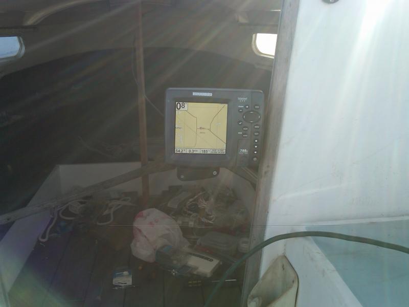

The humminbird is installed. I decided my bracket looked a little "klunky" so I cut it down a bit. I mounted the transducer to the inside of the hull with a lexan sealant. No bubble from what I could see. It will be a while before we float, but we seem to sail nicely in the driveway.
