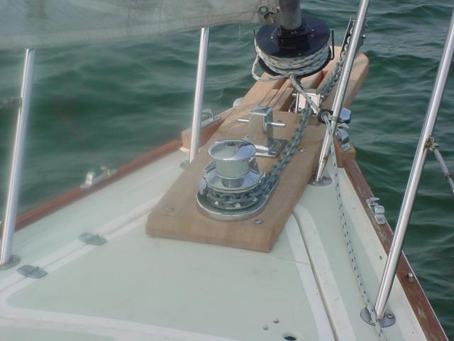

One of the downsides of a bowsprit is that it places a moment arm in front of the boat. You're an engineer, so you know what that is, right? One of our C34 colleagues went cruising from Canada down the west coast to Mexico. He has an older boat, like mine, with what I refer to as "our toy bow roller."
Many of our owners opted to add extended bow rollers to their boats, much like the newer boats. My friend concluded that the addition of length to the bow, with a long overhanging anchor roller, was actually counterproductive. The forces on the anchor are further out on the moment arm and create a great deal of pressure on the fasteners to hold it in place.

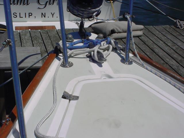

A bow sprit added to an Oday
I have an Oday 32 and one of the first items installed was a bow sprit,windlass and anchor roller and like you the thought of a bob stay and moving the roller furling forward came to mind but I kept it simple and disconnected the forstay and put the bow sprit right over the stem fitting then reattached the forstay......keep it simple
also our bow sprit acts as a great step to board cause we bow in at our marina

Rad: thanks, I think we are on the same page :) I like the one in your reply, looks good.
Ed: That is the one I was wanted to add to my Hunter 33. I think I will ask him for more info if he has it.

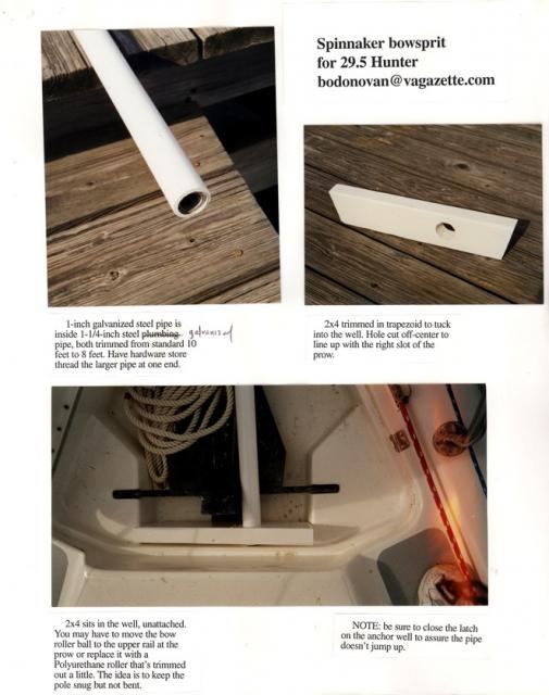

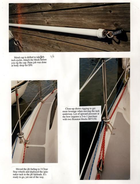

Bowsprit kit
For years I've posted info and pix on HOW for an eight-foot bowspirt, of which four feet tucks inside the anchor locker. It's a 1-inch galvanized pipe inside a 1.25-inch galvanized pipe, providing more than sufficient rigidity.
The tack line and two sheets are permanently deployed for quick set-up.
Be happy to answer any questions. bodonovan@vagazette.com
