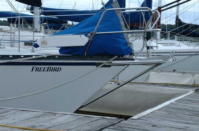

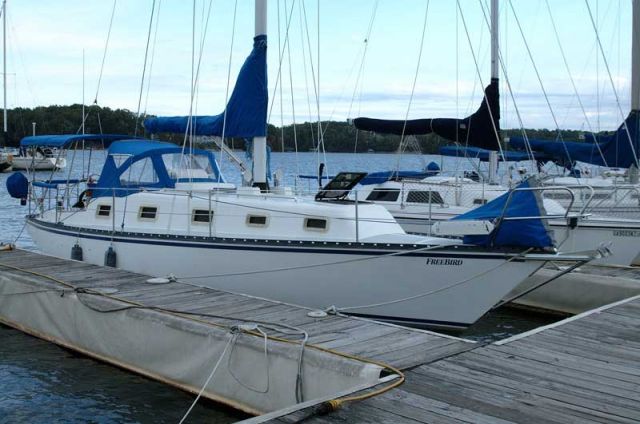

Hi Gary,
I'm David Underwood, owner of Freebird (1982 Hunter 33) with the bowsprit project. I will be happy to help you out with what ever information you might need. My boat is located on Lake Lanier in Georgia. If you are anywhere in the area, I would be happy for you to take a look.
I have learned after 5 or 6 years of use...
My back no longer hurts from pulling up a well bedded anchor. I no longer have to dig in the anchor locker in order to drop anchor. I can sit with my feet in the anchor locker and pull the anchor up by hand without any problem. It makes an excellant diving board. No one wants to take my "right of way" with the SS Anchor Roller / Bowsprit on the front of my boat. I would not have made it any different. I am that pleased with the way it turned out. I spent a good bit of time designing, getting it constructed and installing it, but it has been worth every hour I spent. I also was able to save money compared to the price of a "ready made bowsprit".
Let me know if I can help you in any way.

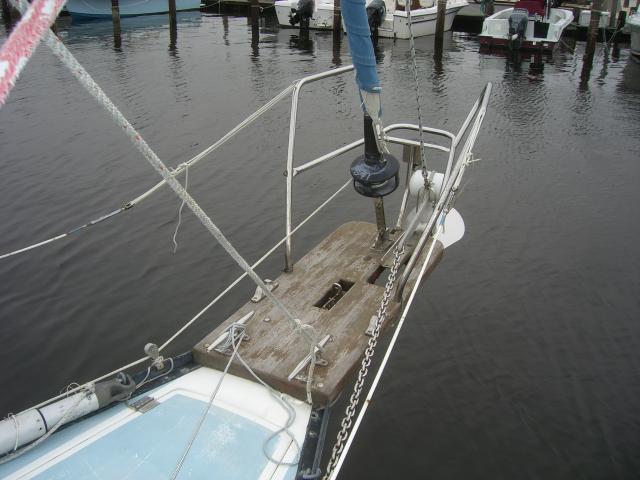

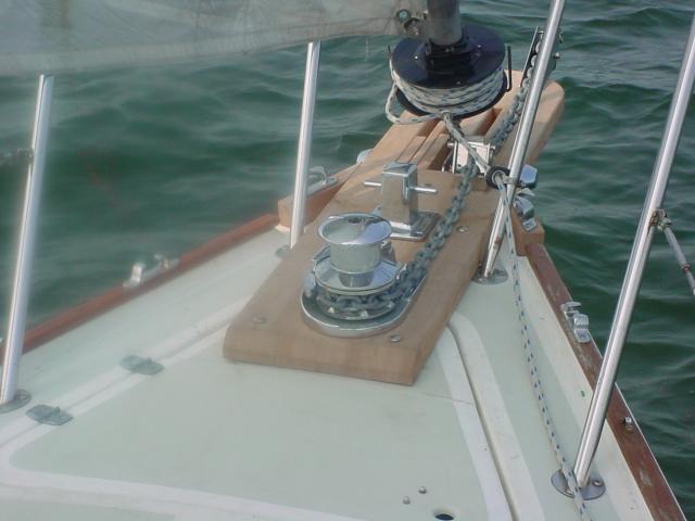

I have done the things you ask about on my 1983 Hunter 33, with the exception of galvanized rigging. That would be a giant step backwards. A waste of time and money and probably dangerous in the hands of an amateur.
I changed the split back stay for individual stays going to the masthead. I no longer smack my head and shoulder on the wire.
Your turnbuckles are not stainless. They are chromed bronze. Unless some P-O changed them.
The way to save money on rigging is to do it yourself, not compromise on material. When I did my rigging I had the upper fitting swaged on and completed them by measuring, cutting and terminating the bottoms with mechanical (Sta-Lock) fittings. Next time I'll do mechanical on top as well. that way I can just order a length of cable and cut and fit myself.
I made up an anchor platform laminated of mahogany. 18" wide by 48" long by 2" thick, epoxy glued and screwed with 128 ss screws # 10 X 1 1/2". Later I moved the head stay out onto the platform 18". It is attached with about 12 bolts, several of which ho through the hull/deck joint. It ain't moving.Stem fitting and platform (bow sprit) fittings made up by Garhauer. The platform fittings are the pieces they make up for Island Packet. I reinforced the stem where the bob stay attaches with 6 layers of stitch mat and epoxy, overlapping at the stem for 12 layers. Moving the stay forward gave the boat some manners in higher wind. I've had it out in lots of heavy wind without a hint of trouble.

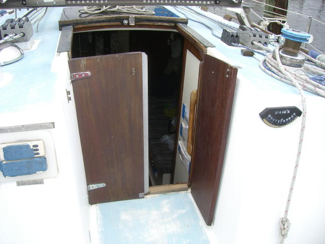

In one of the other posts doors in place of drop boards were mentioned. I I added swinging doors and love them. I hate drop boards. The way I set my doors up I can still use the drop boards in addition the the doors.

Sam the doors are good, just the thing,ease of in and out and I am doing the same, glad you made it so the drop boards are still able to to used, well done.

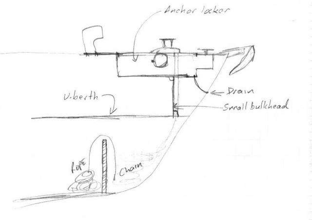

If you look close you'll see I cut the anchor locker door in half and I sectioned off the forpeak with an access door for the chain and rode.
There's just enough room with the door open to get the old Fortress and 200ft of rode into the locker as a backup system
