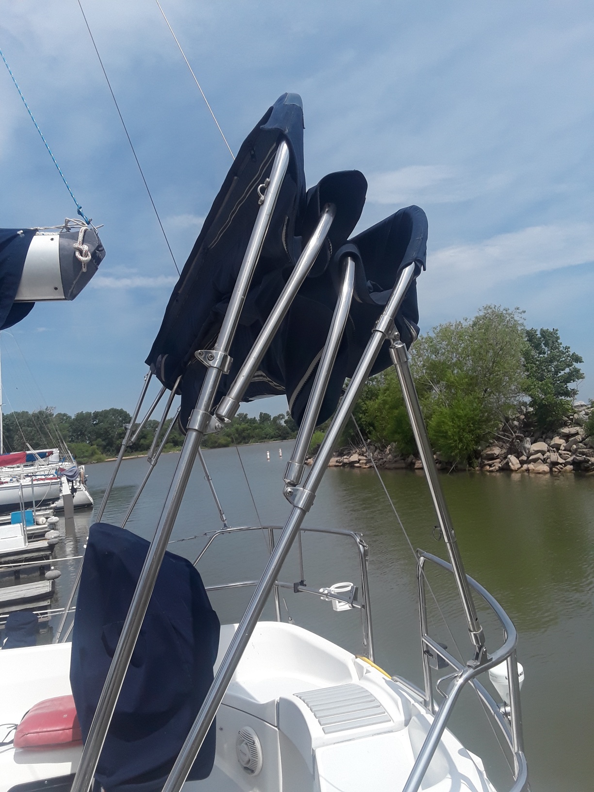

My boat came with a very high quality bimini made by a local company. It's nearly 20 years old and has one small patch from backstay wear. Sometimes when it's out I'll analyze and admire the detail and skill it took to measure and bend the frame as well as the detail that went into the canvas. It's truly a work of art to be appreciated.
