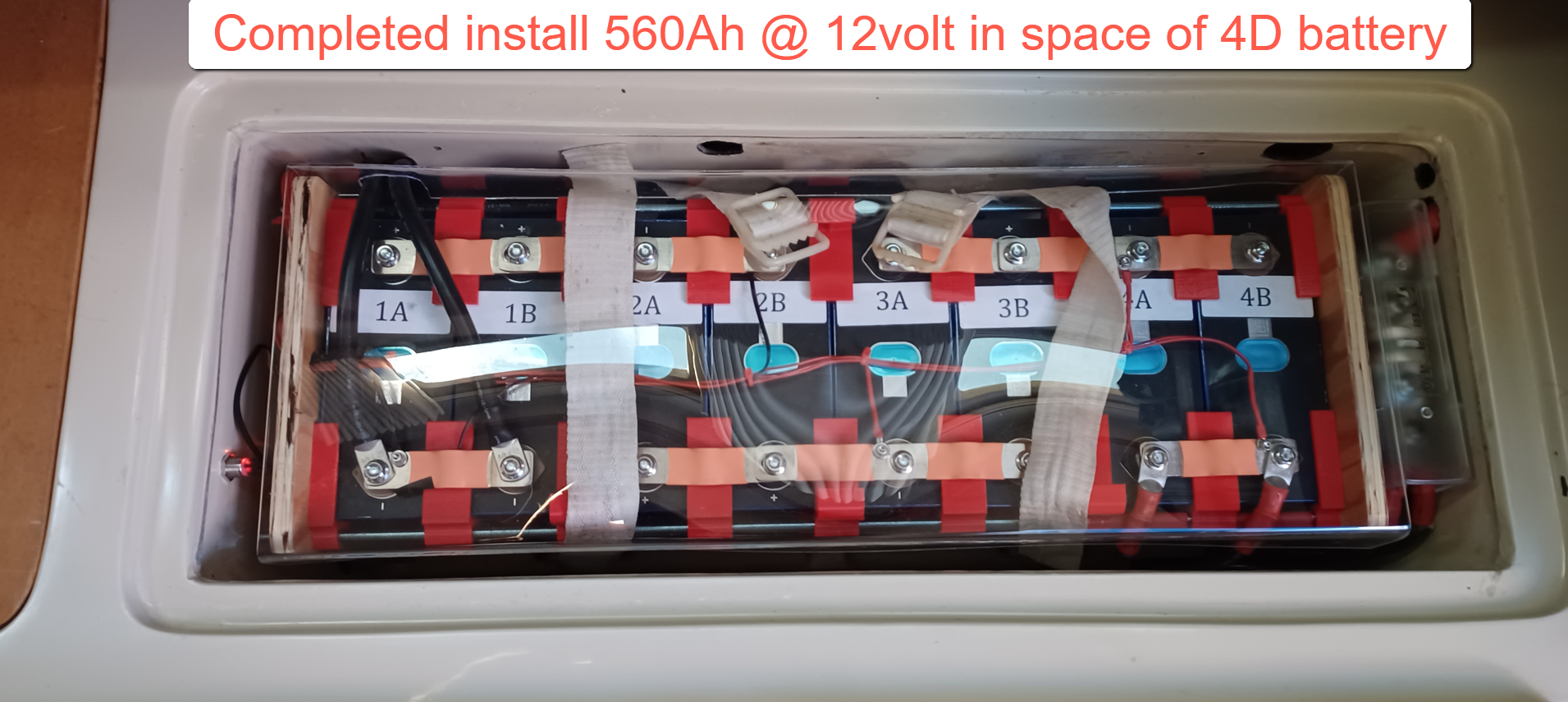

They fail all of the time due to excess heat, especially when charging a large bank of LFP batteries. In my case, I have a 560Ah LFP battery and I have the output on the 105A hot-rated alternator limited to 50A which means that it will be putting out 50A almost all the time that the engine is running. At that rate, the case temperature stays at about 90ºc or 190ºF. @Maine Sail suggests limiting the case temperature on this alternator to less than 200º. I would like to increase the output but cannot do that until i improve the cooling of the case. I have the bilge blower pulling air directly from the front of the alternator and plan to add a computer fan to blow air onto the back. With this increase in airflow, it seems that increasing the cooling surface area with heat sinks would be helpful in pulling more heat from the case.

Thanks for the link to the Ample primer. I had downloaded it years ago but lost it. I now have the pdf in my manuals folder. My house bank is a 560Ah LFP bank made from 280Ah EVE cells in a 2p4s configuration. I have my alternator throttled and thermally protected but am looking for ways to cool it better so that I can up the output.
