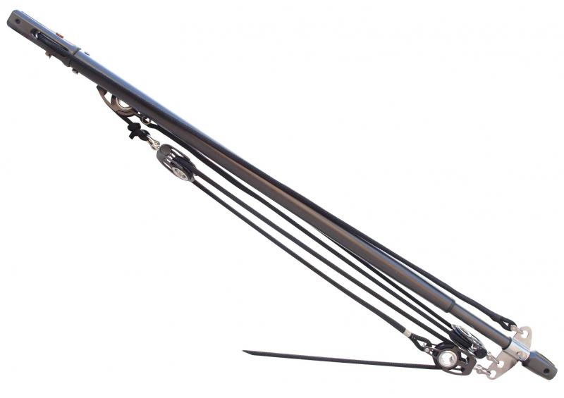

Have an 82 Catalina 30, thinking of adding a Boom kicker to eliminate the topping lift and add some upward lift to the boom. Question is, do I need to add a boom vang also, as the main sheet provides the same downward pull (4:1) from the traveler to the boom. Wouldn't that be redundant?
