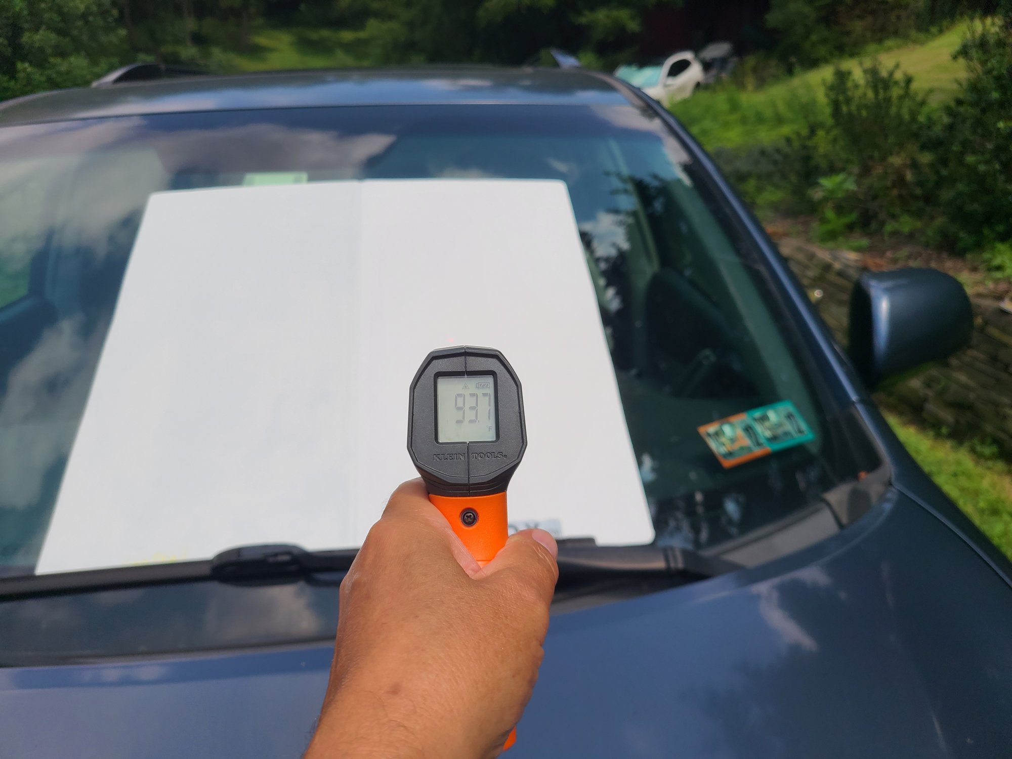

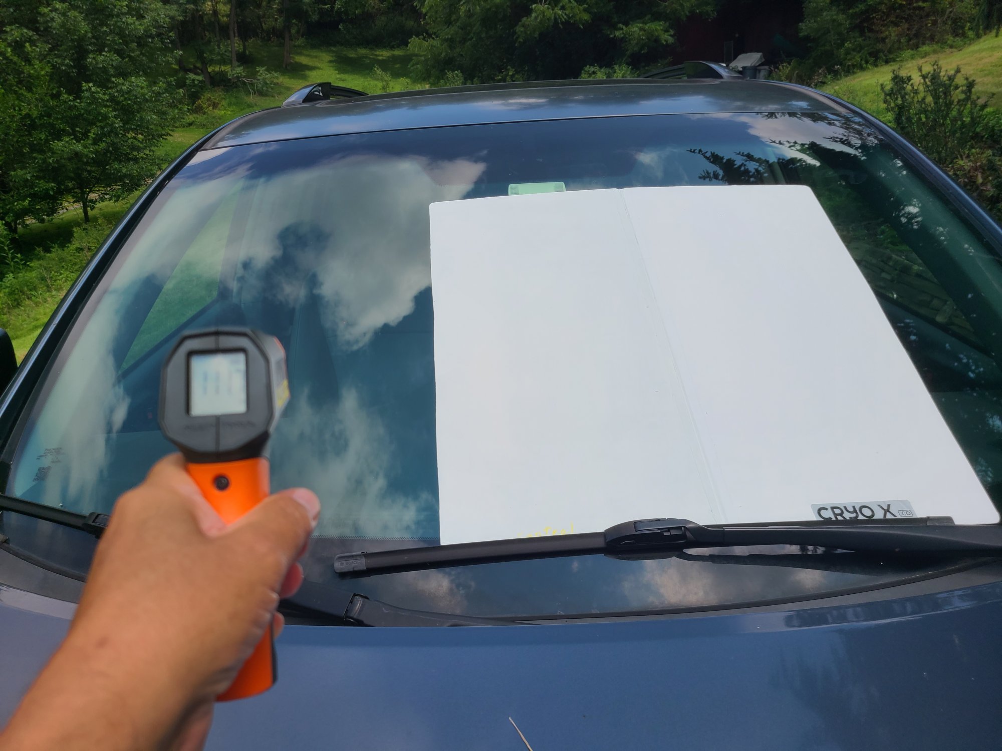

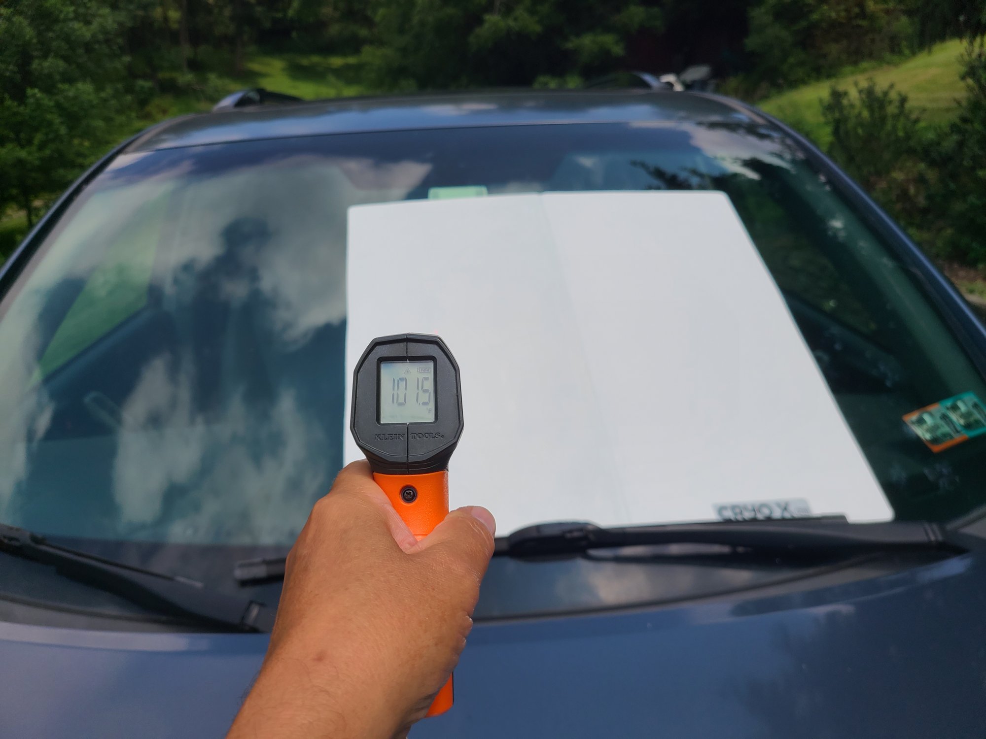

Here are my first test results. The manufacturer said canvas was not a good idea as the paint would crack so I laid up a couple of thin panels of one layer of 1708 with a hinge between them. One I painted with ordinary flat white house paint, the other with the BaSO4 Cryo-X cooling paint.
On my car on a partly cloudy day, which is not ideal for cooling paint, the result was still noticeable. After a half hour, the bare window is 111F, flat white house paint on the left is 101, and the cooling paint is 94.
Sorry for the blurry pictures, my arms aren't long enough. Next week I'll try them on my boat.

Pretty interesting. I wonder what the temperature readings are on the underside of the panel with the two different paints. That might be a good indication of how much heat would actually be transmitted into the boat. Plus it would eliminate any variation from the emissivity of the different surfaces that could affect the IR gun readings.

This was "Hey the paint is dry, let's throw it on the car and see what happens." An IR gun is pretty unreliable, especially on paint that is designed to radiate IR heat. My primary temperature sensor was my Direct Information Gathering & Interpretive Thermal System, aka DIGITS, but photos of me touching it would be pretty boring. The IR gun is what I had handy. The windshield felt much hotter than 111 degrees. The panels felt consistent with the IR gun. I didn't get in the car because it was hot. The only meaningful test is whether the boat feels cooler inside, which I've yet to try.

You can't accurately measure temperature using an IR gun...
  • In the sun. You will read reflected IR.
  • A white area. The test area needs to be black (read the manual).
You could read the temperature from the back side, using black-painted spots. I've used an IR thermo in industry a lot to measure temperatures on refinery equipment, and for example, if you want to measure stainless steel accurately, you have to paint a black spot. The difference can be many degrees. Reading glass accurately in the sun is just difficult, because black paint won't work, so I would skip that one.
Once you get a temperature on the back side, compare that to a shaded block spot in the same area. The difference in heat flux can then be estimated using convective heat loss equations. It won't be accurate, but it will be something. Roughly, in the range we are considering, the difference in heat transmission will be proportional to the difference between the backside temperature and the air temperature (if the air temperature is read from a shaded black surface).
Remember, the IR meter is reading IR emissions, not the actual temperature.

Looking at those linked articles, it appears that these paints are designed for radiative cooling as well as normal reflecting (blocking) of sunlight. The radiative cooling aspect is what mostly sets them apart from any normal reflective paint (bright white), with increased reflection a minor difference.
So measuring the temperature of their surface isn't the correct way to judge them. This would only, at most, show any difference due to reflection. At worst, it will show increased temperatures due to radiative cooling.
The correct measurement seems to be measuring the inside temperature of something coated with the paint. Maybe paint a fiberglass or metal container with a temp sensor inside?
