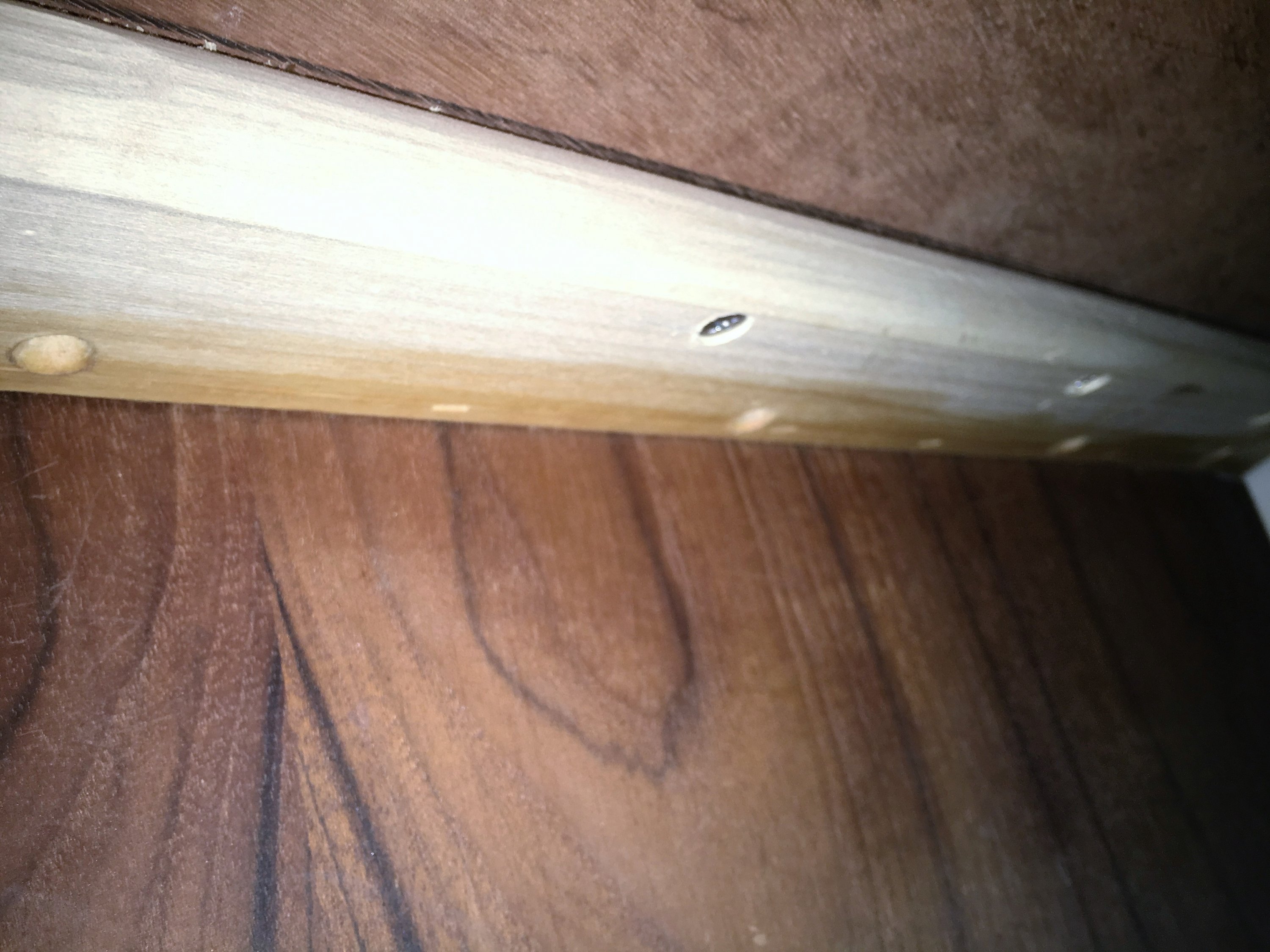

Hoping you may be able to help resolve this as putting it together 17 years ago is much easier than taking it apart today! I’ve apparently cracked the freshwater holding tank on our 1999 Hunter 310 on last hard sail. It is located under the vberth. I have removed all decking screws on the topside and all joiner screws underneath, but the decking still cannot be removed to access tank underneath. I suspect that when built in 1999 the manufacturer glued the decking to the joiner pieces between the vberth decking pieces? If you have any manufacturing records or means to validate how to remove that decking above the fresh water tank it would be most appreciated. Otherwise next step is the saw! Thanks, Tim

Appreciate your input Ralph. The tank is definitely leaking, hoping to find a loose fitting vs cracked tank. Either way, I gotta get in there first! Next step may literally be the saw. Wish they builder thought about the future access to such things. I'm just sure they glued those vberth sections together :-( Merry Christmas!

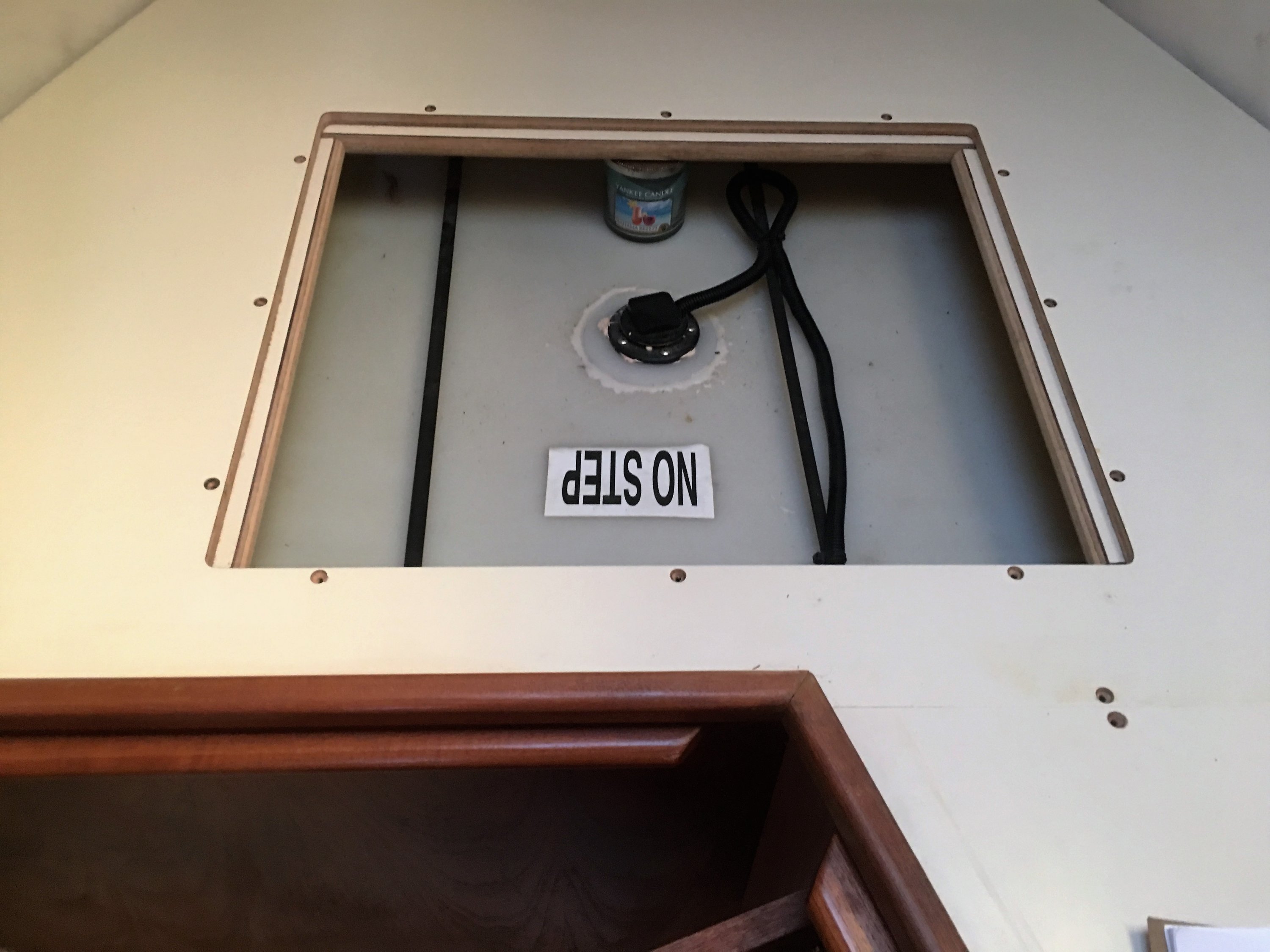

Hi @Ralph Johnstone, no surprise to see you commenting here. I've so appreciated your advice over the years. (It's Stephen in Ottawa with the 1999 H310.)
I have a leak somewhere and am trying to access the outflow at the water tank too. Were you ever able to have a look at your tank access?
I unscrewed it all and was able to raise the forward edge above the rest, hoping I could slide the panel forward, and even used a mallet to gently coax it forward but to no avail.
Thx.

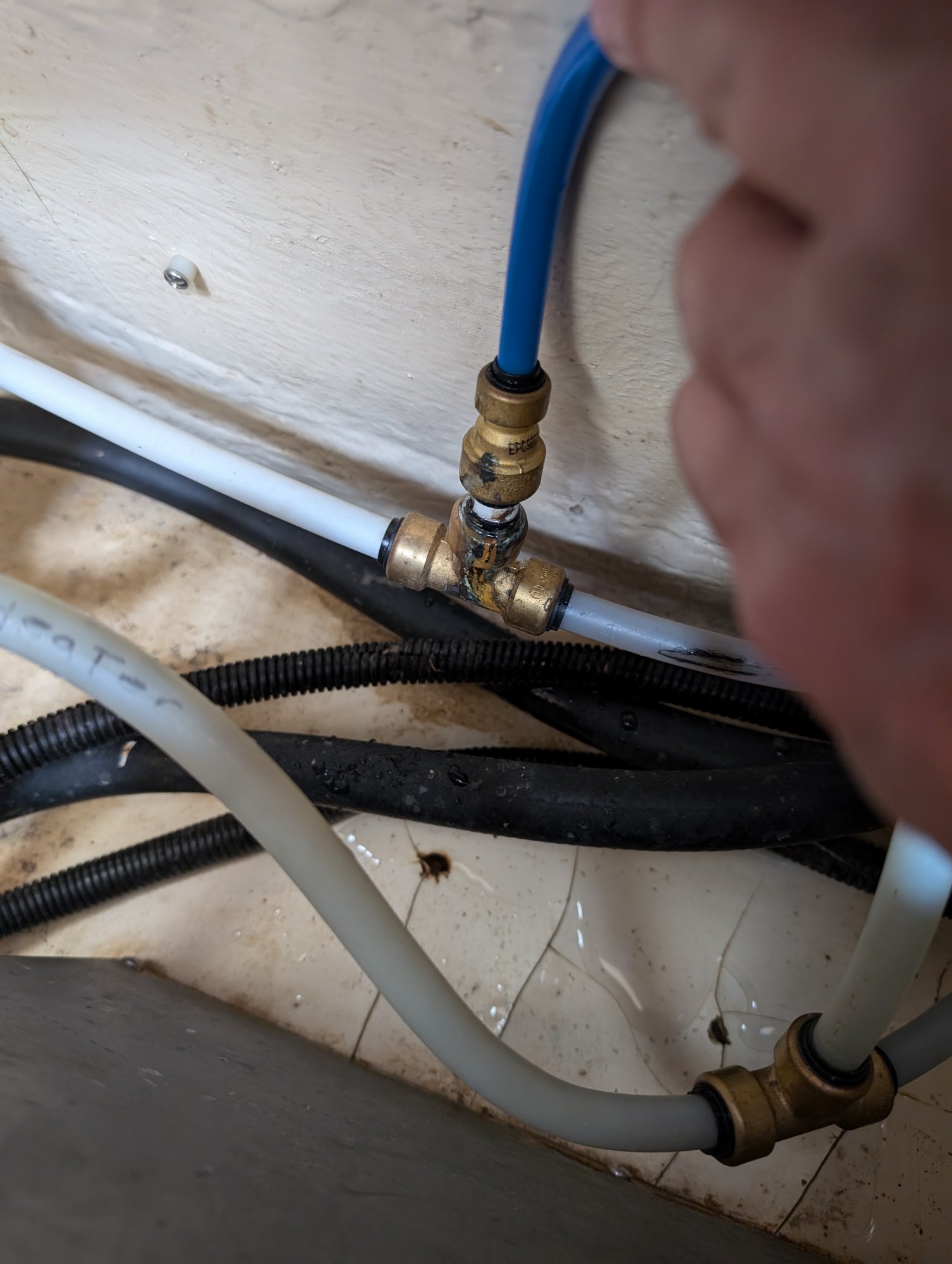

Thanks for the quick reply! A borescope it is then.
Jan 4, 2006
7,870
You'd be well advised to purchase a few lottery tickets. Luck like that does not come around very often.
