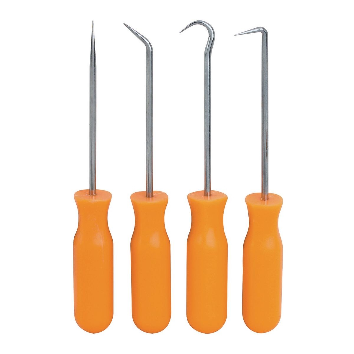

I use the tool on the right, in the tiny slits [4] on the side. Insert tool, pry out gently.
Jim...
PS: It is called a "Pick" . $2/set.

When I converted to LED's, I had to remove the lens first. Then you twist the base CCW.
Change your wire to LED bulb base. Reverse procedure. Done.
That type light base is very clever way to not use screws.
