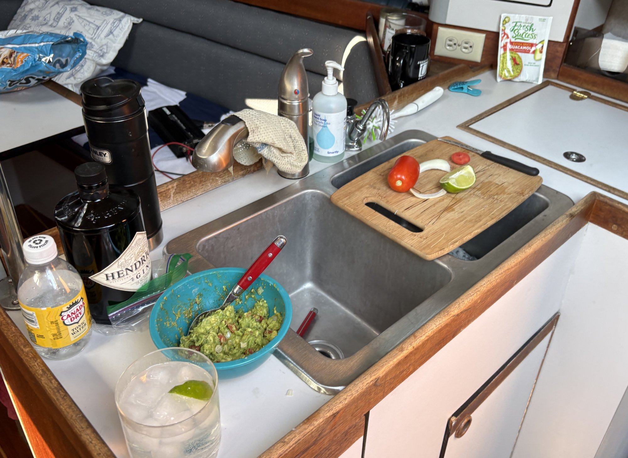

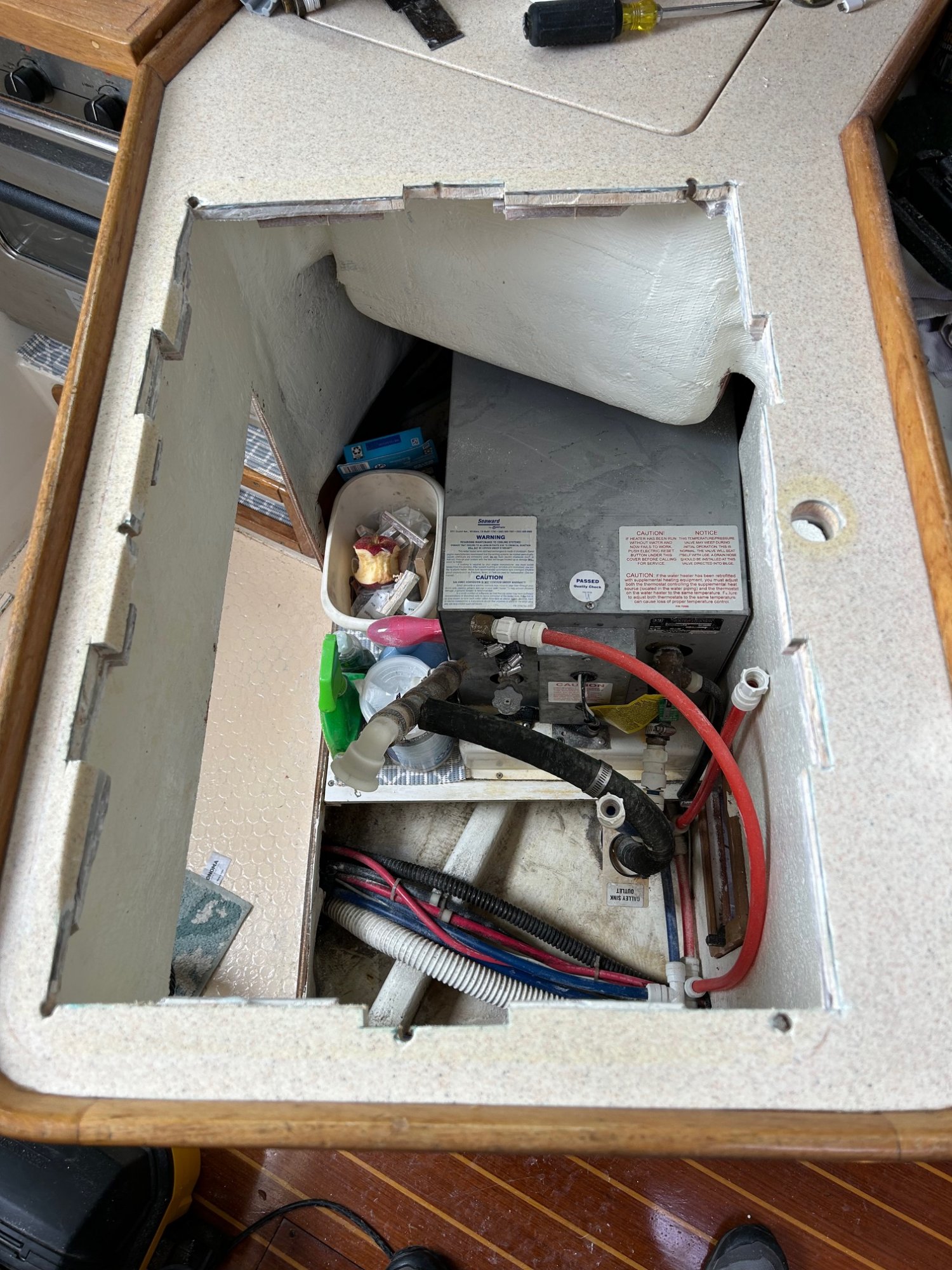

I've thought of replacing my heater but it has been functioning well so I have left it alone for now. As shown in the photos, the front frame comes completely out very easily to give you full access to the heater. However, the sink drain may interfere to some extent. I replaced my sink last spring and modified the drain location. It was a little tricky but with new hoses and a simplified drain (single basin) it has worked out very well. I am planning to replace the heat exchanger hoses this winter so I will have it apart again. I've never heard of an anode for this tank. If there is one, that's news to me.
BTW, do you find the double basin configuration as useless as I have? You can't fit a regular plate in either basin. Best improvement (according to Sue) was putting in a new sink. The stainless looked like junk anyway.

Looks like it is optional if the freshwater system in your area is prone to causing corrosion (tap water with a concentration of dissolved salt). Defender's description says that it replaces the drain plug if you choose to install it. I don't know why corrosion or a depleted anode would lead to smell. The smell is probably related to some other malady, I think.
The tank itself is aluminum (the outer jacket may be galvanized steel, stainless steel or epoxy-coated aluminum). I'm pretty sure that Catalina installed the galvanized option. Corrosion on the outer jacket (if any) doesn't matter. You would notice corrosion inside the tank if you find white powder-like material in the water. I don't like aluminum tanks for potable water for that reason and prefer a stainless tank. But the stainless tank makers are more expensive, for sure. I will replace mine eventually, but I'll have to admit that there is nothing wrong with my 26 year-old Seaward tank so far!

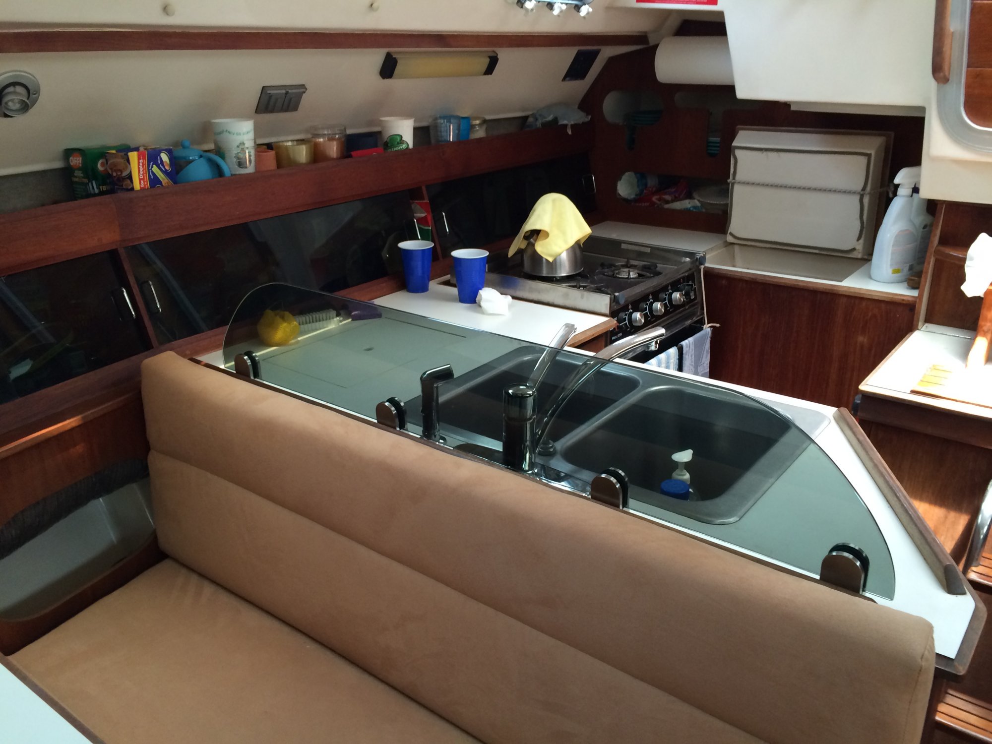

New sink looks nice Scott.
I like the double bowl sink on my O’Day 322, but the bowls are a bit small. I wish I could find like a 60/40 sink with one bigger and one smaller bowl. But the space is probably not big enough. So your single bowl sink may be the best option. I put a new faucet in Tally Ho this year with a pull-out head.
What sort of faucet are you using on your remodel?
Oct 26, 2008
6,432
Catalina 320 Barnegat, NJ
Your sink looks exactly like the one I pulled out. I could not fit dishes flat on the bottom & that was making me nuts! :facepalm:
I did look very carefully for a double in the configuration that you are thinking about. It looks like you have room from side to side (I did not), but you may also have a problem with the front to back dimension.
My new sink is a bit deeper than the old sink and it pushed the faucet mount back, which forced me to create that little wood platform. But I think it worked out well.

Sink on the old H-34 is fine but I did make a backsplash of scrap acrylic. Keeps the settee cushion a bit cleaner:
24,582
And the shoulders of crew who did not volunteer to clean up less wet.
