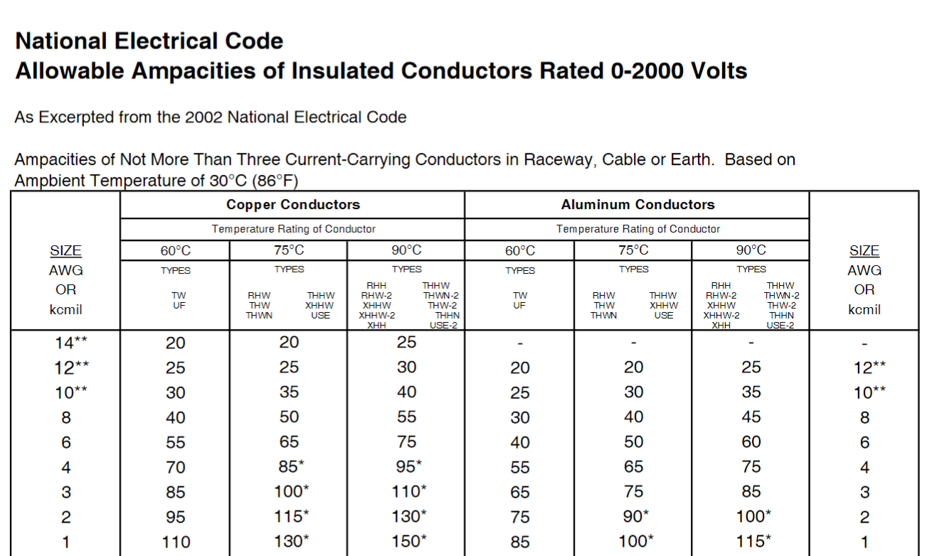

Thank you for the welcome. You do not start derating wire untill you get over 100 ft. 12Gage is ratted at 25 amps. Do not exceed the limits of your plug device ( 20 amp) by using a higher capacity breaker. Safety first above all other considerations. Always consider startup draw on all your devices. That is why you use a 25 amp rated wire for a 20 amp circuit. 14 Gage wire is rated at 20 amps but can only be used for 15 amp continues draw.

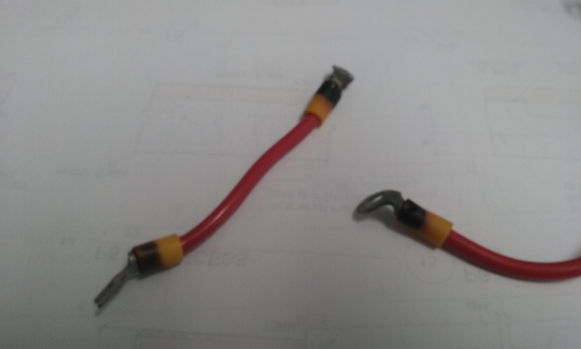

When you are changing out the wire from the shore plug to the breaker panel make sure that you also change the jumbers from the main breaker to the sub-panel breakers. Here is a photo of the 12ga jumpers on my 88 C30. :yikes:
They are what tipped me off to the 12ga problem. :facepalm: When I found these two wires I was loading the boat to head out on a two week cruise. Instead I used that "free time" to completely rewire the AC side of the electrical system.:banghead::banghead::banghead:

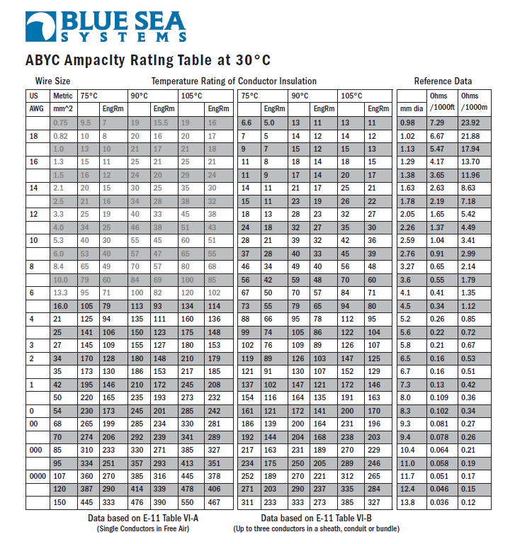

I find your ratings to be very interesting. Unfortunately, all I have to go by are the National Electrical Code (NEC) ratings and ABYC ratings but obviously you have something which is much more in depth. I think all of us could benefit from your resources if you could be good enough to share. Thanks.

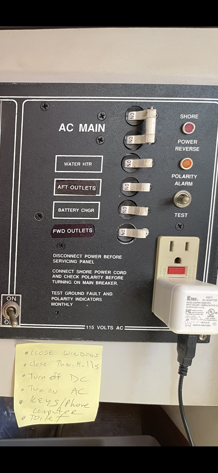

This is my current AC panel with one main breaker. My water heater is wired directly to its own fuse on the panel. There are two more blank holes below it. I suspect I could do the same with my battery charger and refrigerator.

That would be a big AC panel, even on a 40' boat, no?
I have 3 which works for me. Charger, water heater, outlest. If you have AC that would add one. That is all that I can think of for my C30 size but bigger boats might want a couple of outlet breakers and possibly two AC's which would get to 6.
I have 4 on my boat…for some reason my outlet’s are split between fwd and aft outlets. According to my original oday manual, outlets were on a single breaker.
I don’t have A/C at this point.
