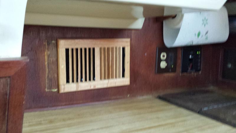

Nels, We just picked up our Catalina 30 2 months ago and I have my main vent where yours is located. However it looked factory installed, or whoever installed it did a great job.
I do not know if there was air on the boat before or not ...there was no return air grill located anywhere. I am not surprised you do not get much airflow from the 3" ducts that is why I did not even try to run them, we will just use fans to circulate air thru cabin. If you post more pics can I see where you mounted your thru hulls and AC water pump? Also, where is your exit for condensate drain and AC water output. Thanks in advance!

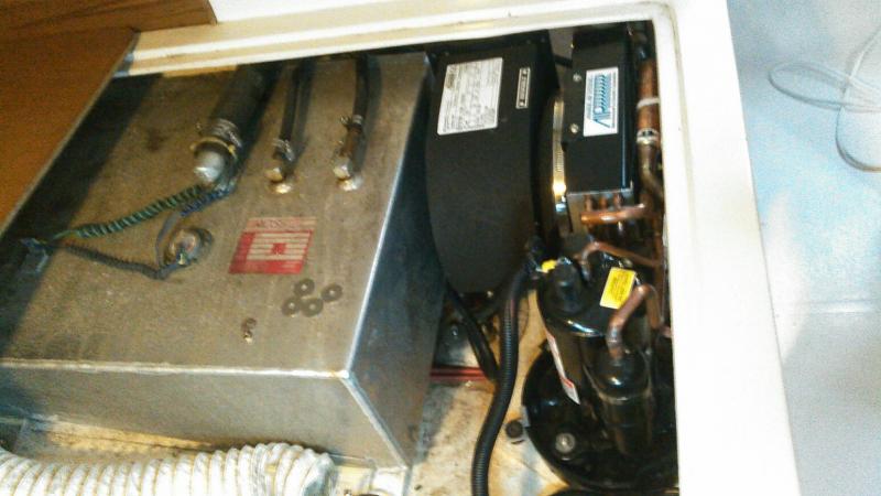

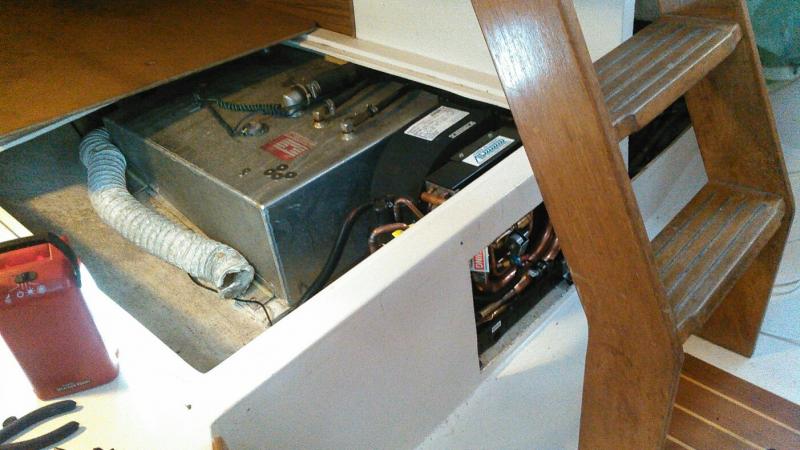

Here are the pics showing install, thru-hulls etc.
Here you see the two thru-hulls for the engine and AC. AC is white hose, engine is black. Also here you can see the depth and knot meter installed.
So looking aft across the engine and muffler you can see a red pump in the back of the pic. That is the pump for the AC. From there it snakes under the galley and into the port lazerette to the AC. Also you see a tee, this is terminated into the hull with a female hose end. I am guess you could open it to prime the pump or hook up a water hose to flush out the lines or something.
looking directly down into the lazerette you see the AC install. I think I would like to do a shelf or somesuch in here to keep junk off of the top of the AC and lines.
Looking aft into the lazerette you see the water outlet hose for the AC and the small tube is connected to a venturi like device tee'd into the outlet hose. This tube goes down into the condensation pan and when the AC is running the water flow sucks the condensation up and out.
For the heck of it looking forward into the lazerette you can see the compressor for the icebox. I'm not sure if this is factory or not, I'm kinda guessing the PO installed it.

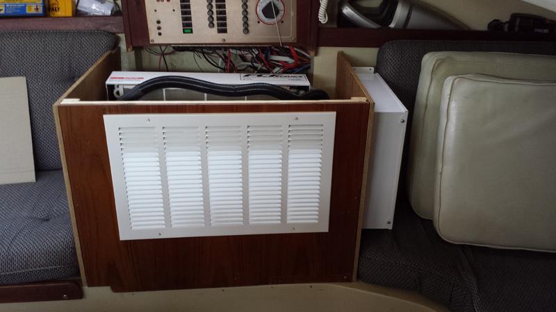

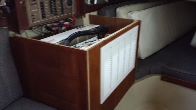

Our boat is a 1985 Mk I. We located our A/C where the Nav Station was.
NOTE: Webasto units (And I assume others) need 2" clearance on all sides in addition to their stated dimensions. Part of this is for the cables and hoses running to the unit.
Fortunately my brother has access to heavy gauge cables, so moving the batteries from under the nav station to the aft lazarette was not that expensive. :dance:
We also upgraded the shore power cables to handle the current draw for the air conditioner. Found the original plastic electrical AC bus for the Shore Power was melting when we got in there :eek:, so all that was upgraded to heavier buses and cable as well.
We cut the top off the nav station where the panel is and removed the sides and front. The sides were marked first for the curve of the seat back and bottom, then cut to fit. 2 Redwood 4x4s I had laying around were glassed in athwartship two inches wider than the original nav platform box had been and 3/4" plywood was screwed down to be a platform. The sides are screwed into these 4x4s and the front screwed to the sides. I happened to have some Teak plywood from a previous boat that the new front will be made from. The return air is in the front of the box (144 sq inches per 12,000 BTU). The ducting is still a work in progress. I ran an insulated 5" duct to the galley where the trash door used to be. The other I reduced to an insulated 4" duct and ran it forward to the hanging locker where a WYE spits it off there and the other arm to the V-Berth.
There are a few BTU calculators out there on the internet, be sure to get a unit large enough to handle your needs, but don't go too crazy because too large has drawbacks too.
The 144 sq in/ton for the return air grille came from a website too, but I can't recall which.
