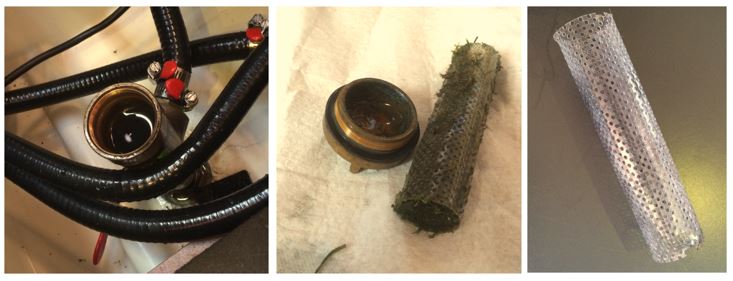

When I've had trouble with my system it usually is the strainer for the water pump intake. Close the through hull valve, open the top and check the strainer ...

Common alarm for poor raw water flow. My AC guy installed an upgraded Groco raw water strainer and coached me on regular filter cleanings and seasonal flushing. I configured a hose barb to fit the raw water hose and flush with a freshwater hose at dock side. The raw water circuit accumulates a lot of gunk sitting there running in the marina soup. Even found a herring wedged 6" above the through-hull. Keep a clean machine.

I have an Oceanis 45 in South Florida. We have to clean the A/C strainer at least weekly. We also had a problem with grass and debris blocking the generator intake. (That was after we cleaned the strainer) The blockage was where the through hull goes through an "L" fitting. I closed the seacock, removed the hose, and cleared the blockage. All is now well.
