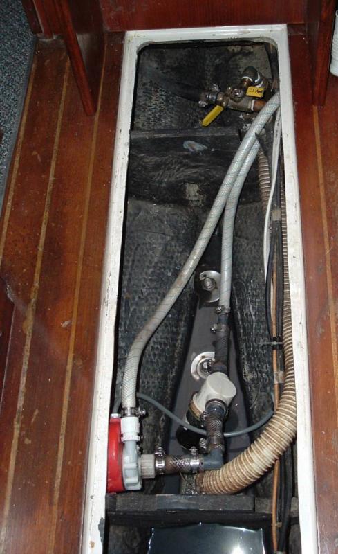

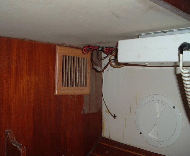

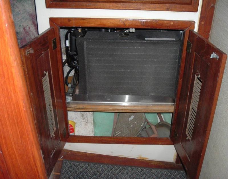

Ten years now and never touched the Mermaid condensator. Living right? My 12K unit almost exactly the size of a standard cardboard box with one inch off the height. That is what I used as a template. My cost in 2001 was just what came in the basic kit plus the condensator. I did not use any duct work. I was not willing to give up storage space. Mine sits in a cabinet and blows out under the nav table. Easy installation with a 'T' off the engine water, one hole in the bootstripe for outlet water, and pump and filter in the bilge.
