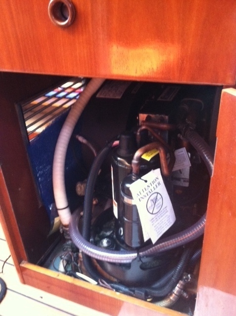

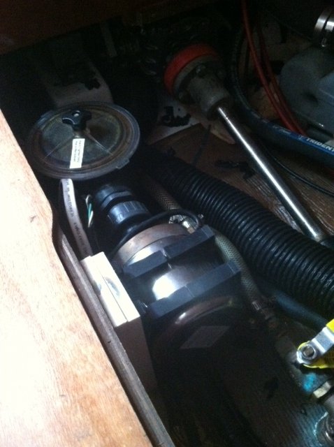

I have AC in my 311. The pump is mounted in the stern under the access panel for the shaft. The unit is located in the cabinet under the sink. I can take some pictures if you would like.

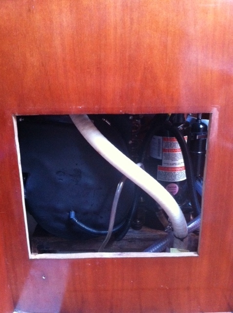

I've got A/C in mine as well. Everything is mounted under the sink, including a sump pump and pan for the condense.

It would be great if u could send some pics. Do u have decent access under sink?

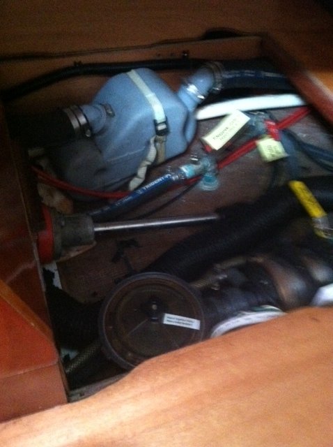

Here are the pictures sorry about the quality my iphone doesn't seem to get colors correct and the woodwork does not look at all like that.
Under the sink for the "unit" and pump under the aft berth.
