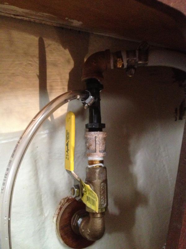

siphon doesn't seem to work - what did I do wrong?
I recently installed the siphon set up as described by daleheron but for some reason I have no siphon. It doesnt matter if the bypass valve is open or closed. With the bypass closed I get very reduced flow and I don't think it will provide enough cooling to keep the compressor from kicking off. With it in any position I don't have suction. What could I have done wrong? I'll try and post a picture of my setup in a few minutes.
Maybe I have a bad injector? It should work but no suction whatsoever.
I just installed this unit and had the same issue. Take the red rubber washer out of the bull connection and back flush the siphon by closing the overboard and flushing the trash out. Reinstall the fitting without the red washer and open discharge. It then sucks. Also verify you direction of flow.
The other issue I see is you should swap the siphon/educator positions. I am not even sure you need the bypass but all those 90 degree turns and valves are knocking down the flow and building resistance on the down steam side, the siphon should be on the straight run. I would repostion the valves to the bulls on the tees of the straight run then 90 to the PVC valve. I would try to do most of it with screw pipe and get away from hose clamp hell.
Get it working with the siphon in the straight run first then add the bypass, that way you know what is causing the issue.

Sorted out now
In the Navy we called those units educators and the were connected to Fire Flushing pumps, we used them to pump down the bilges. They were about 100 times as big.
All sorted now:dance:. I took your advice and put the siphon in the straight run and the valve in the bypass. I wanted to keep the bypass in case something clogged in the siphon or if the AC kicked off due to low flow for some other reason and I wanted to have the option to run on the bypass if necessary. It turns out that the siphon is fine now and the bypass is barely cracked open to give good flow but still keep the suction. I still have the hose clamps but will convert to screwed fittings later at my convenience
I don't try to suck from the bilge but rather the siphon line fits inside the drain hose from the AC pan where it is at a low loop and sucks directly from there. I'm going to try to run a hose to the bilge and see if it has enough suction to draw on the bilge but its about 3 or more feet to the bottom of the bilge from the siphon fitting so I'm not holding out much hope. If it works will put in line there so I can suck from the bilge or from the drain pan hose. We'll see if it has enough suction for that.

Update
As an update. I ran a drain line for the AC to the bilge and put the suction in the bilge. It works fine and has plenty of suction to draw from the bilge. I plan on putting a T in with a small valve if I can find one that will allow me to draw the suction directly from the AC Pan normally. When it gets full it tends to slosh out some when I heel over so keeping it nearly empty is a plus. But I also like the ability to draw the bilge down completely dry if some water gets in there, hence the two lines. However, without a valve, if either gets all the water out then it will lose suction and won't pull on the other.
