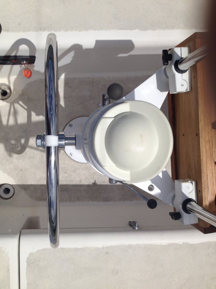

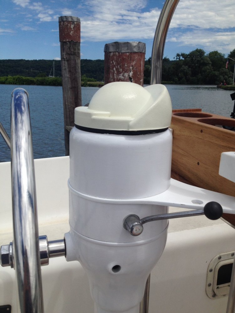

Thanks for your input fellas. I went up to the boat this morning to address the throttle hitting the pedestal guard bracket. I was all tooled up to adjust the throttle cable at the motor. Last week I read several reviews on the Edson site regarding the SS replacement levers and many folks had written reviews about the same problem and just bending the new lever a little bit. So I attempted that first with fear the old lever might break off. Nope, it was easy peasy and now the throttle closes just as well as originally. Here’s a couple pics oriented from top down and side views.

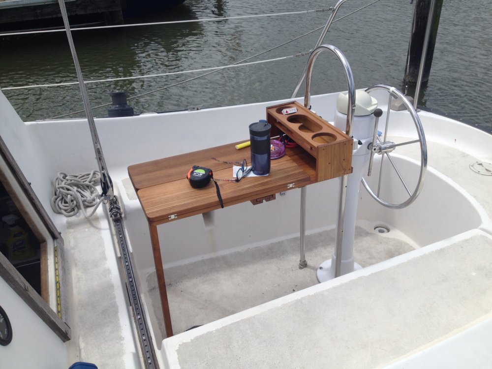

Then I made the Admiral very happy by mounting her new teak folding table on the pedestal guard. Gonna be a good night for Wayner the Complainer.

:thumbup: Got it buddy. Always open to learning new things. This is the first diesel motor I’ve ever possessed...and I’m really glad I didn’t have to monkey with the speed control cable and casing. Cindy put three coats of teak oil on the table after delivery. We’ll see how it looks after this season. She wouldn’t be happy if I suggest a weather resistant finish now. :badbad:
My next assignment is to purchase a pedestal/table cover.
