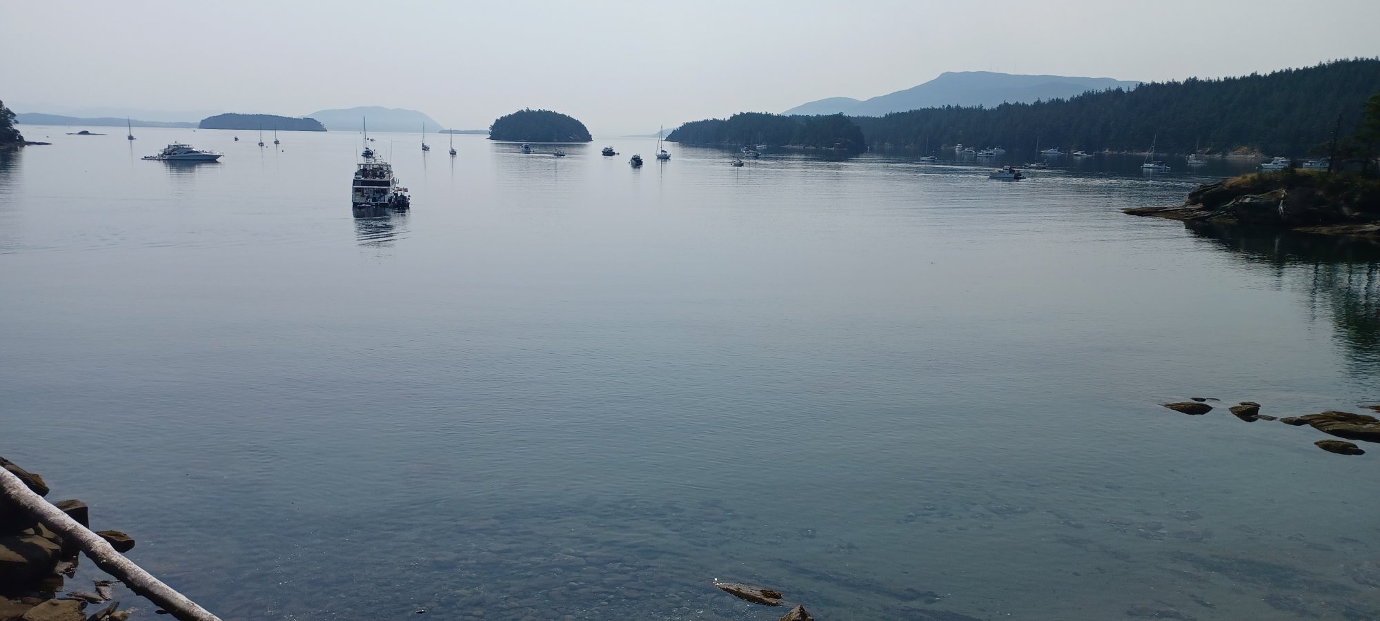

Up here in the PWN, we have 15' or more of tidal swing and the reagon is very mountainous. Deep anchorages are not uncommon and many times, safe anchoring will involve dropping the hook in very deep water and then tying the stern to shore with a lone stern line.
The shallowest charted depth I will use is 15' and that is only if I have personally scouted the full swing to make sure there are no surprises. 35' is very common and then when you add 15' if tide, you are in 50'. Given 4' of freeboard, and a 4:1 scope, that means 220' of rode out.
This photo is of Echo Bay on Sucia Is and is one of the most popular anchorages in the area. Most of the bay is charged at more than 25' with 35' being closer to the norm. On a busy summer weekend, it is not uncommon to find several hundred boats in this anchorage.

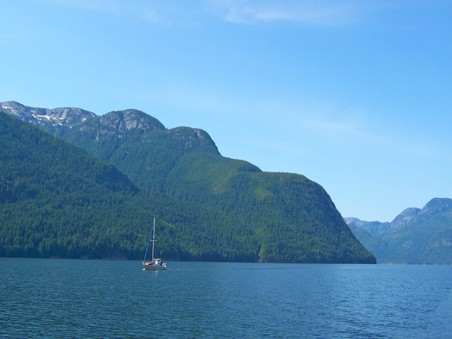

In a lot of places you could tie to shore and still have a hundred feet of water under the keel. Most places will be just a bit deeper then here at home.
