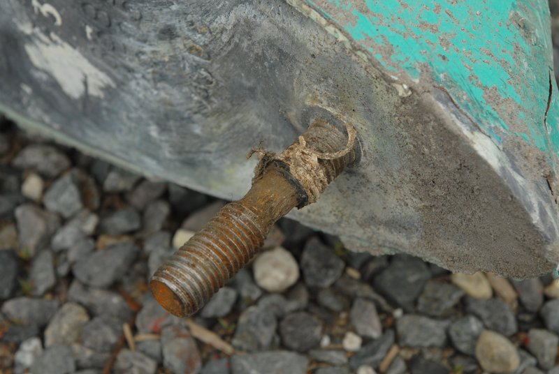

Drop the keel and re-bed it properly. Keels can leak from both the bilge side and the ocean side. By re-sealing only the ocean side you have inadvertently trapped stagnant water around the keel bolts. This will, if it has not already happened, lead to crevice corrosion of the keel bolts. If let go and ignored for long enough this can lead to bolt failure.
If your keel was leaking that badly, draining out through the bilge when you hauled, the worst thing you could do is seal only one side of it..
