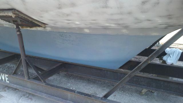

Stole some more hours to go to the lake. I used the grinder to get the loose stuff out of the bad spots in the recently soda blasted keel. Then one coat of Interlux 2000E. There are just a couple of spots on each side that need fairing. Then four more coats of 2000E. Also managed to get the starboard bootstripe painted.
Ed: was that "loose stuff" you ground out rusty? I know it sounds crazy with a lead keel, but when I stripped mine a few years back, there were a lot of "rusty pock marks" that required grinding and fairing. Only thing I could figure was that Hunter used a lot of old wheel weights when melting the lead for a keel pour...
Jun 2, 2004
5,802
Right you are Jim. There were both pieces of loose lead and those deep pockets with what looked like rust. Some of those pockets were too deep and narrow to really get clean. So I epoxied right over them.

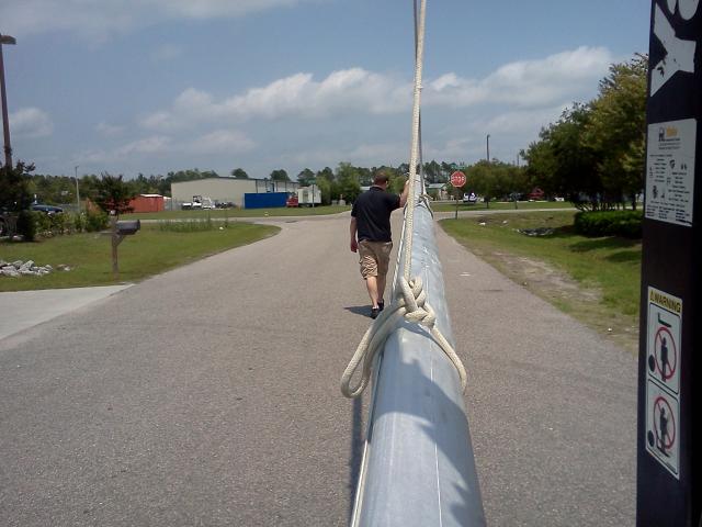

You could build 2 temporary saw horses about 6 feet high with 2x4 and screws and hang the mast under them in order to spray all at once. One over the baby stay mast fitting and one over the winches. 2 vangs and you can raise the mast as high as you need to. Just cover everything you dont want to spray with paper and tape. I have automotive painting tools but I get my best results with an old Wagner LPHV gun that I bought years ago for 80box. It still does a great job, sprays any paint and just plugs in. No need for compressor.
I am also in the process of painting my mast. I stipped it completelly. The P.O. had 15 mast steps on it and I did not liked them. So I took the mast to my neighbour in my industrial park (Southern Fabricators) and had him plug all the holes left by the removal of the steps. 6 per step, for a total of 90 holes. (4 pizzas and copious adult beverages later). Good thing I was driving a forklift.
I could see the headlines: Conway resident arrested while driving intoxicated a forklift, and carriying a 53 ft pole.:)
I can flip the mast by grabbing the winches and turning it while on the saw horses. It is not that bad. I hung the mast from a shackle inserted at the yankee shrout point on the mast and looped it to the winches. I can lift the mast that way and spray over and under it. I have an unfair advantage of having a forklift with a 12 ft boom on it. But it is still an adventure.

OK Jose, I am checking to get a shipping cost to your place. :) That forklift is exactly how the mast got from the rack to beside my boat. Seeing your pictures reminds me that I could hang the mast from something put through the shroud bolt holes. That would give me a top and a mid-point support. At the bottom just a piece of tubing inserted up into the mast.
