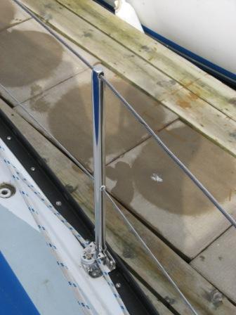

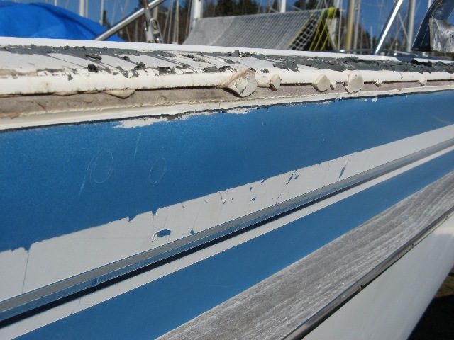

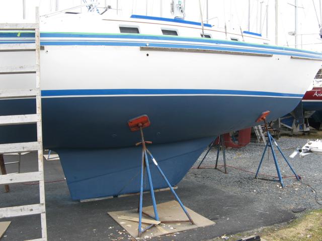

Ed, I am jealous - I wish I had a catch-up year to get everything done. My mast also needs repainting, my rigging also needs replacing and list goes on. I am struggling to get everything ready for launch later this month. The yard placed me in the "number one slot" last fall so that repairs could be made to the damage sustained during Hurricane Earl last year...and, of course, they want to launch me number one too! I have to be away on busness for a couple of weeks come Tuesday, so this weekend is it for me.
I have the bottom painted. I have to polish the port topsides tomorrow or Monday. Insurance will take care of the starboard side.

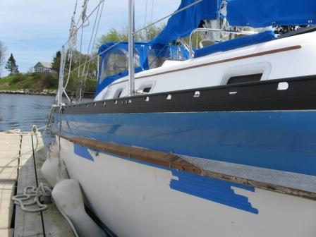

The old toerail was removed and the new one will be going on soon. The Crest Aluminum C-2821 is an exact replacement - too good in fact! The bolt hole are more accurately drilled that the original, which was +/- 1/32", adding up to some variance when added at every 6 inches over 36 feet; as a result some of the holes on the boat have to filled and re-drilled. They are also going to bed the new rail in Sikaflex 291 LOT (the old was butyl tape) and fill in the gaps on the hull to deck flange at the same time (I don't think the gaps go very far under the flange otherwise I would have had leaks). The new stanchions haven't arrived yet, but I hope they will be identical. The damaged woodwork on the rubrail has been cut out and will be replaced this week. Then the new SS caprail will go on.

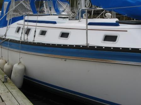

So you're the one! Someone asked recently about adding a rub strake. I could not remember where I had seen one. Now I see it was your boat. Do you think that was original from the factory? How is the wood attached to the hull?

It was us. Jim, did you add the rub rail?

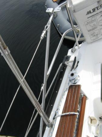

Bill, the boat had the rubrail when I bought her. She came from the northern Chesapeake - apparently such rubrails are quite common there as they often tie up between pilings. I think it was put on in Rock Hall MD by the PO. It didn't come from the factory that way.

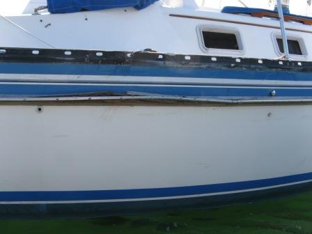

The rubrail is triangular in cross section, milled from 2 x 2 teak. there is a SS cap rail at the outboard edge. It is through-bolted to the hull and bedded in 5200 (wish they had used something easier to disassemble). It sure saved my bacon (or rather, the boat's...) when a J30 broke loose and fetched up beside me during Hurricane Earl last summer. BTW, the J30 didn't do well - looked like someone had taken a shotgun to it after its encounter with an H37C. I had largly cosmetic damage to the rubrail, toerail and some bent stanchions - no cracks in the gelcoat, scratches, or anything.

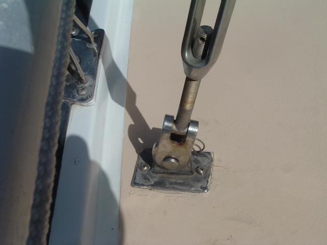

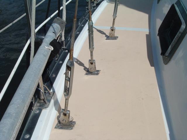

Hey Ed S- You mentioned new "standing rigging". Did you ever re-do your chainplates and the deck openings for the chainplates? I saw an old post ('09?) of yours discussing the problem. Were you able to use MS's techniques to pot the core and yet maintain the open "channel" for the chainplates? Ed H

And no Ed, I continue to pull the chainplate covers every season and caulk. I push the silicone down and around liberally. Heavy on the top so it squeezes out when I screw down the plates. I use clear and it cleans up easily. Same around the mast.

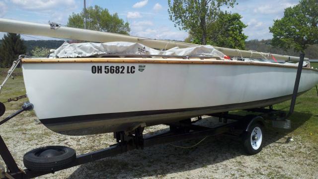

Step2, drag the Highlander to the lake. This spring(?) sucks! It was 45 today and rained the whole time. Forecast is for lots more and the lake is already so high that they can't put the docks in. Normally the parking area in front of the club is full of boats waiting to go in. Mine is the only one. And its not just the boat, I hate exercising inside. More trips to the YMCA I guess. I know I shouldn't complain, we haven't had any tornadoes or fires or earthquakes.

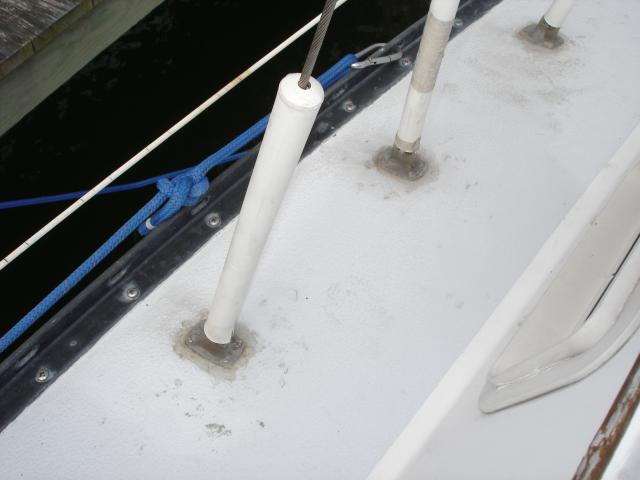

Here are what mine look like- tons of silicon and smeared onto the deck. I hope to clean it up this summer. Ed H

I have to agree with everyone - its been an awful spring in Nova Scotia too. I guess we have to count our blessings though - no tornados or floods here! Anyway, my spring refit was complicated by the weather, which slowed repairs to the damage from last years Hurricane Earl (more weather woes!). My guy finally found enough dry days to glue in the teak scarf repairs to my rubbing strake. He also replaced the entire starboard toerail, 3 stanchions and all the lifelines. In addition to the usual spring bottom work, I removed the vinyl striping on the blue shear stripe port & starboard. Now I just need a few dry, warm days to repaint the blue stripe and reapply new vinyl stripes. Then maybe some sailing...
